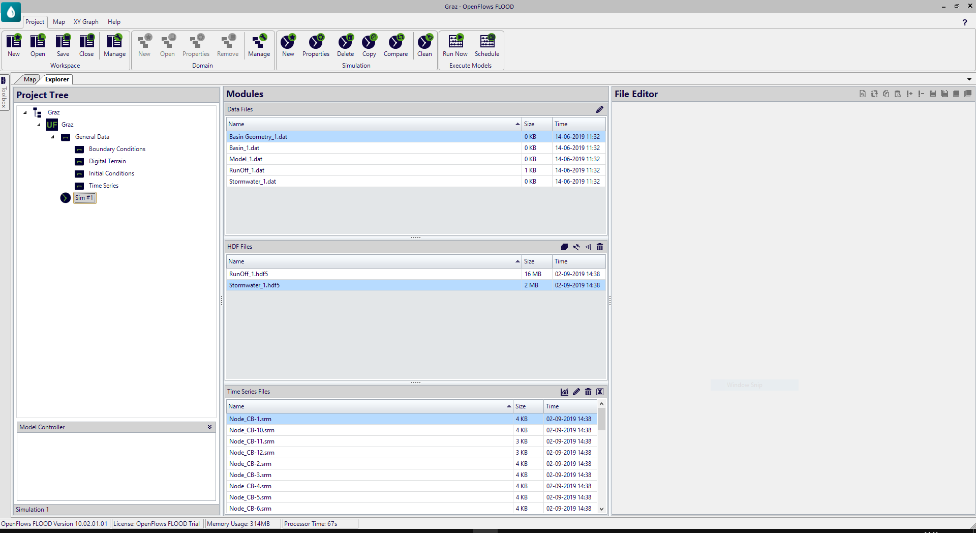

During the simulation the model output files are created. When selecting the simulation that just finished running (“Sim #1”), the “Modules” section in the middle pane is filled with “HDF Files” and “Time Series Files” result data:
Figure 1 – List with model outputs (HDF and Time Series)
Output results can be visualized in a gridded map format (using OpenFlows FLOOD’s GIS features, by loading HDF5 output files) or in XY graphs (by loading the output timeseries files).
Different types of parameters can be visualized.
HDF files contain model results for the entire computational grid at different time instants of the simulation, similar to instantaneous snapshots of the study area. These results can be plotted as maps animated in time.
Time series files contain results for predefined computational grid points with high output frequency. These results can be plotted as time series graphs.
