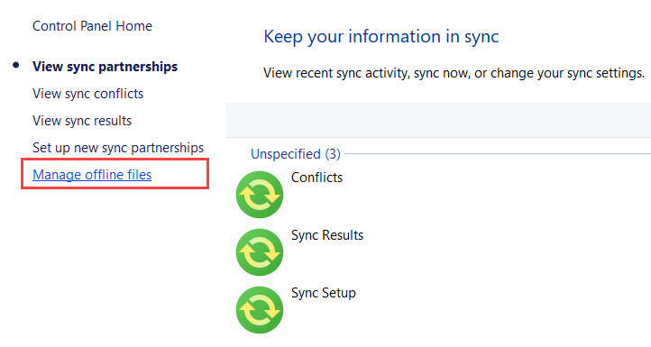

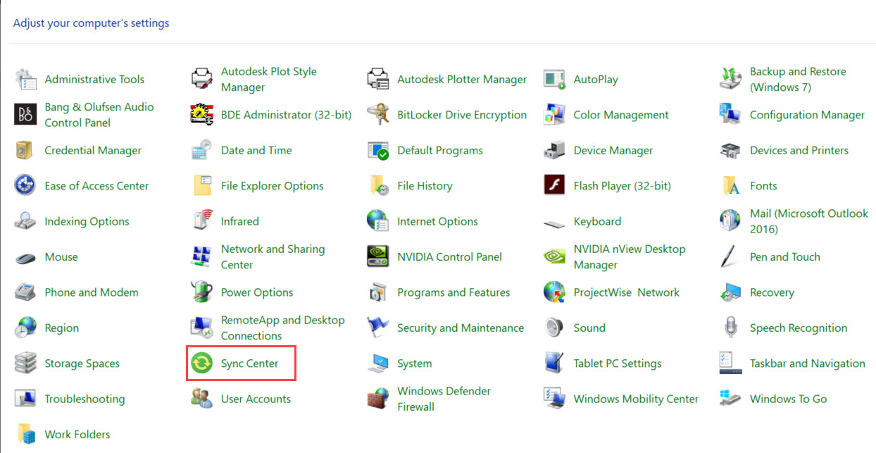

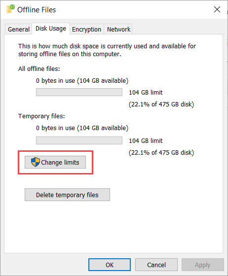

Option 2: Increasing Disk Usage Limits
If the above option does not work, then there is possibility that the available disk space for the program is falling short when running an analysis. If this is the case, then there is a solution which can increase the disk space but requires administrative privileges to change these settings in your system.
Note: If you do not have administrative rights or your organization does not allow changing your system settings, please consult your local IT team before proceeding with this option.
Step 1: Go to Control Panel
Step 2: Select “Sync Center”
Step 3: Go to “Manage Offline Files” on the left side
Step 4: Go to the “Disk Usage Tab” and “Change Limits” and change the disk limits to accommodate more memory for the application to run.
