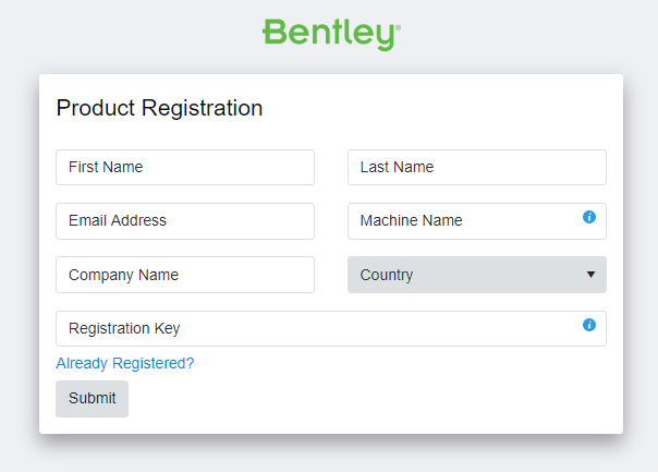

1. Using a web browser, navigate to this page: https://fulfillment.bentley.com/oem/registration
2. Complete the dialog that appears and click Submit. All fields are required fields with the exception of Company Name. If you had already followed this process before and are trying to re-download the software or license file, click "Already registered?".
Note: It is very important for the machine name entered to match the machine that the user is actually going to use the software on. If it does not match, the license file will not work, and the user will need to contact Bentley (bipress@Bentley.com) to reset the key.  We have provided an informational tip in that field that will instruct a user on how to get the correct machine name. Hover your mouse over the blue "i" icon for help.
If you encounter the error "Invalid activation key", ensure that all fields are filled out in the form, that you have entered your own unique registration key from the book (it can only be used by one person), and that no extra spaces were included when pasting in.

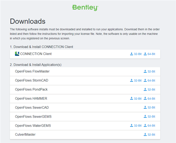

3. First, download and install the provided CONNECTION Client for the architecture of the user’s machine, 32-bit or 64-bit. In most cases you will want the 64-bit version. It is important that the user download the latest CONNECTION Client before importing the license file.
4. Download each of the products you want installed on your computer. The download file will be saved to the default folder for your computer. (It’s best to not Install the product at this point but rather wait until the license file is downloaded.)

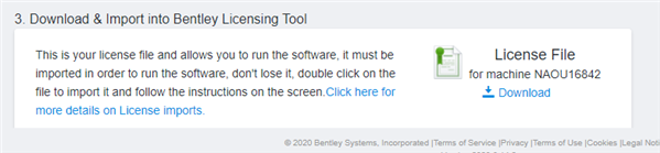

5. Save the downloaded license file (*.belic), which is needed in step 6. by picking Download.
The license file will be in the location where all your downloads are saved. There is no need to open the downloaded license file at this time.

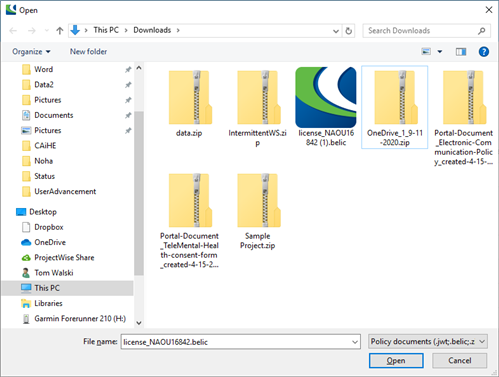

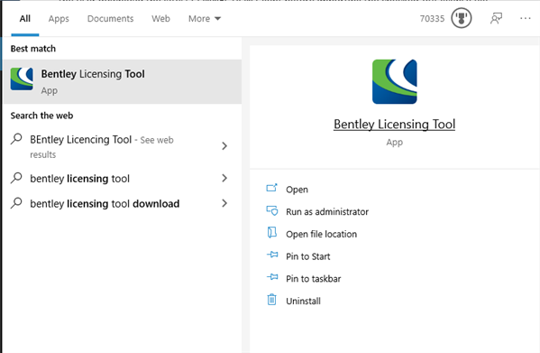

6. Import the downloaded license file into the Bentley Licensing Tool. To do this, first open the Bentley Licensing Tool from the Start menu.
Note: if you are asked to sign in and you do not have a Bentley account, you can dismiss the sign-in dialog and proceed with opening the Bentley Licensing Tool.
Open the File menu and choose Import Policy File. Chose the license file that you downloaded earlier and select Open.
After a successful import, you should see a confirmation that the import was successful. Then, click the Entitlements tab and the software products should be listed. Note that the list of Entitlements may be blank initially or may list other Bentley software already installed.

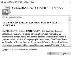

7. Install the products that you will be using. Go to the folder where the downloads are stored (from step 4) and open the installation file which will look like the following (using CulvertMaster as an example):
cvm10030003en.exe
Follow the steps to setup and install the product, then open it.

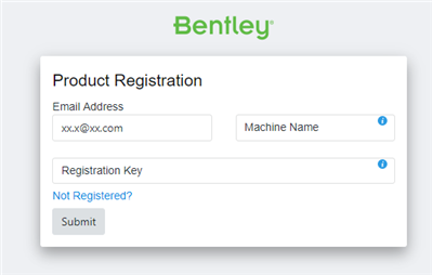

If the user wants to install additional products at a later date using the same registration key, it is necessary to return to the fulfillment center (step 1), pick “Already registered” and complete the dialog below. There is no need to download the CONNECTION Client or license file again.

What if I need to re-download the software or license key?
If you need to download the software installation files or the license file again (on the same computer), use the same link and click "Already Registered?"

  1. From the Windows Start menu, locate and open "Bentley Licensing Tool"
