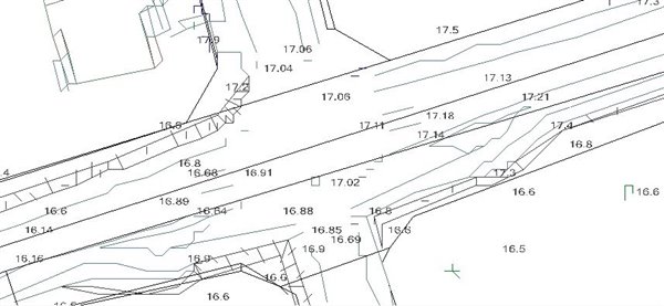

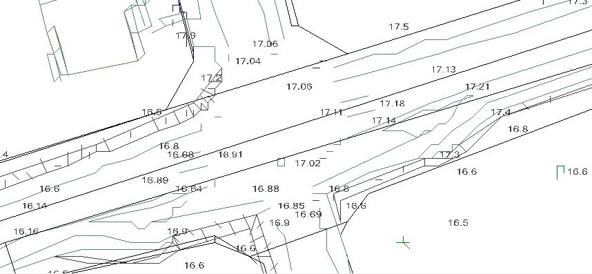

Background layer linework does not appear correct, is badly aligned, or jumps around when zooming an
Product(s):WaterGEMS, WaterCAD, SewerGEMS, SewerCAD, CivilStorm, StormCAD, HAMMER
Version(s):10.00.xx.xx
Area:Modeling
A file such as a DXF or Shapefile looks different as a background layer, compared to how it looks in AutoCAD, MicroStation or ArcGIS.
Or... when zooming in to, or panning around a background layer, it appears to shift around.
Reference # 659289
The issue with the background not appearing the same or shifting around is a known issue related to the use of very large coordinates. When the X/Y coordinates of the linework or image is very large, the accuracy is reduced, and curves and other things will not appear smooth, but rather they will appear jagged. This problem is more likely to occur when non US unit (i.e., feet) map units are in use.
For polyline, point and polygon Shapefiles, an improvement was made in a patch to version 10.00.00.55 of WaterCAD, WaterGEMS and HAMMER, and a patch for version 10.01.00.70 of SewerGEMS, SewerCAD, StormCAD and CivilStorm. Please contact technical support for the patch if the above is the software version that you are using, or, upgrade to a newer version.
Note: Whilst shapefile backgrounds should work with all the newer versions of the Hydraulics and Hydrology applications (newer than 10.00.xx.xx), there is potentially still an issue that can occur with DXF background layers when very large coordinates and non feet map units are in use. Please see the "Workarounds" section for a potential way to work around this limitation for DXF files.
