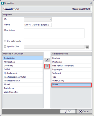

In order to run a simulation with waves (using MOHID Water), first go to the simulation properties and add the Waves module to the list of active modules in that simulation as seen below.
The wave module should appear in the left list of modules. Then press OK.

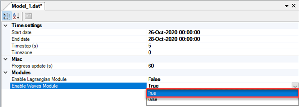

Then go to module Model configuration dialog and select in the Modules section, set the option "Enable Waves module" to True (as shown below) .
