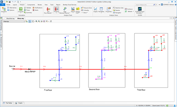

WaterCAD / WaterGEMS support two dimensional drawings, so the problem lies in handling the multistory plumbing system, but there is a solution for that.
In that case you would need to break down each floor separately and accurately in plan view and connect each floor to the building’s riser pipe (e.g. in red below). An example for a three-story building with each floor laid out side by side shows how this can be done in WaterGEMS / WaterCAD.

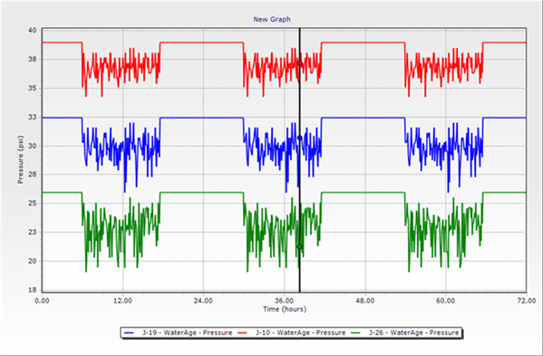

With such a model it is possible to dynamically calculate properties such as pressures and flows. The below graph shows how pressures can fluctuate over the course of three days on different floors of a building. The red line shows reasonable pressure at the bottom floor but only marginally acceptable pressure (green line) at the top floor, which is expected as the height rises pressure will be low.

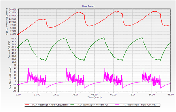

As we know some buildings have rooftop or other in-building tanks which serve to provide reliability and pressure equalization during the day times and store water in case of emergencies. These tanks, however, increase water age and the accompanying disinfectant decay. This can be modeled showing different parameters associated with the tank as per the data available with you.
Below screenshot shows the water age wrt time and flow fluctuations over the time.
Since the use of water is less during night the tank fills and water age increases, whereas in the daytime water age would drop and disinfectant residual stays high. So, these kind of water analysis like water age, water quality standards like constituent analysis also can be performed in premise building models as well, you just need to have sufficient data. These results will help you operate the system efficiently.
