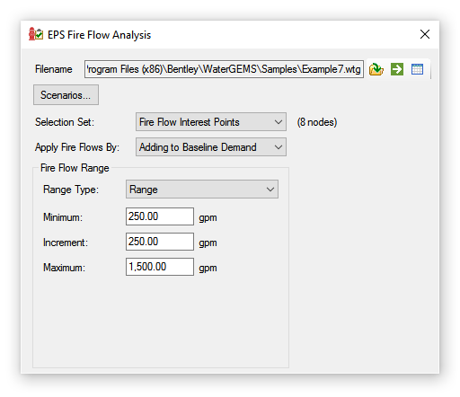

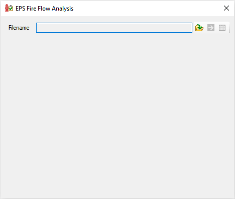

The tool is very simple to use and provides minimal options. When running the "Haestad.EPSFireFlow.exe" file the following dialog will appear.
Note: if there is an issue starting the tool then try right-clicking on the executable file and selecting "Run as Administrator". Also ensure that the version of the tool matches the version of WaterGEMS that you have installed (check under File > Help > About).

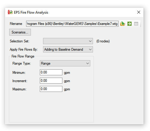

1. Select the model
Click the Open button to select a WaterCAD or WaterGEMS hydraulic model to use for the analysis.
Once the project is open, there are options that must be specified before calculating the EPS Fire Flow.

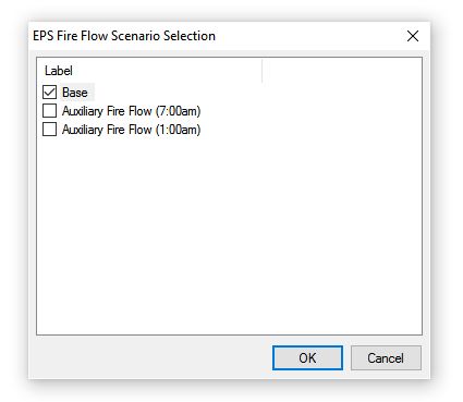

2. Select the scenario(s)
a. Click the Scenarios button to display the "EPS Fire Flow Scenario Selection" dialog.
b. Select at least one EPS scenario, and then click OK.
3. Choose a selection set
Choose a selection set from this dropdown list to use for the EPS fire flow analysis. The junctions and hydrants in the chosen selection set will be included in the analysis. Each of these junctions and hydrants will have the fire flows applied (during the time when the pressure is lowest) for each fire flow included in the range.
Note:
4. Specify how fire flows will be applied
In the "Apply Fire Flows By" dropdown, specify if the fire flows will be applied by adding to the baseline demand or if they will replace the baseline demand.
5. Select a range type

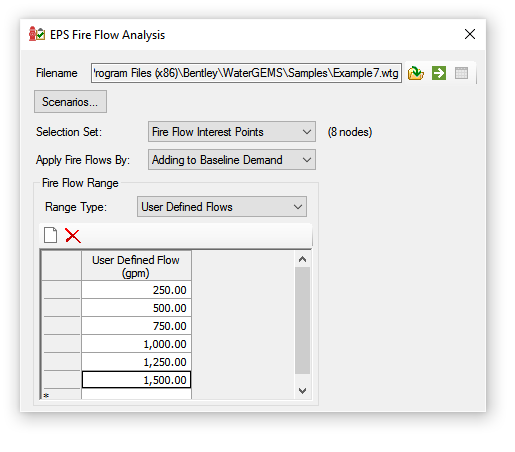

Range: This allows a Minimum, Maximum, and Increment to be entered to establish the range of flows that will be tested for each fire flow node in the selection set.
User Defined Flows: This will establish the range of flows that will be tested for each fire flow node in the selection set. When this is selected then flows can be manually added and deleted in a tabular format.
Calculation Steps

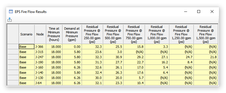

Results
The results are presented in a table once the calculation is successfully completed. If the validation fails, no results are displayed until the issues reported are resolved.
The first three columns are always available showing the scenario label, the fire node label and the time at minimum pressure.
The remaining columns are based on the flow range specified. The hydrant flow curves (created for each combination of scenario, node and time) are used to interpolate the residual pressure for each flow specified in the fire flow range. If the interpolation returns a negative pressure, (N/A) is shown in the table. Otherwise, any pressure greater than zero is displayed.
Units
The units used in the tool are based on the settings of the open project. You can change units by right-clicking the unit next to the minimum, increment and maximum fields on the main dialog and clicking "Units and Formatting". You can change the units of pressure in the results table by right-clicking the column header and clicking "Units and Formatting".
