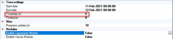

You need to check the Courant number in your simulation and reduce it to around 4, by reducing the time step (in the Model configuration file) - see below (note: the time step shown below is simply an example, you'll have to set your time step so that the Courant number is lower then 4.)
When you setup the time step in Model options you're actually setting the half time step, thus the maximum Courant appears to be double than it should. You can see this a caution procedure. As the engine uses a semi-implicit algorithm, each time step is divided in half. For the first half of the time step, it computes velocities and water levels in one direction explicitly and for the other direction it solves it implicitly. In the second half, it alternates it. Where in the first half an explicit scheme was used, it is now implicit, and where it was implicit it is now explicit.
