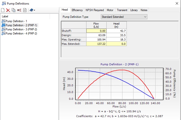

In the pump definition window, what are blue and red curves/lines in the graph window?
Product(s):WaterGEMS, WaterCAD, HAMMER, SewerCAD, SewerGEMS, CivilStorm
Area: Modeling
Original Author:Nancy Mahmoud, Bentley Technical Support Group
In the pump definition window, there are blue and red curves/lines in the graph window. What are these?
Problem ID#: 45261
The default setting for this is that the blue curve is the Pump curve, while the red one is the Efficiency curve.
