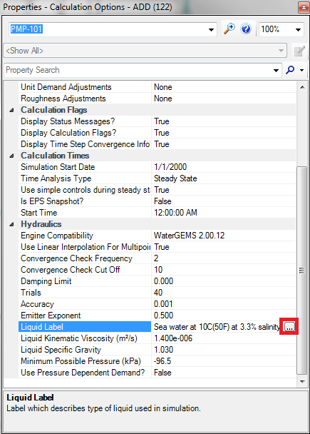

1) Go to Analysis > Calculation Options and click on the calculation option that you'll be using for this analysis to access the properties
2) Go to the Hydraulics section towards the bottom of the properties window and click the ellipsis button on the right side of the liquid label cell as seen below.

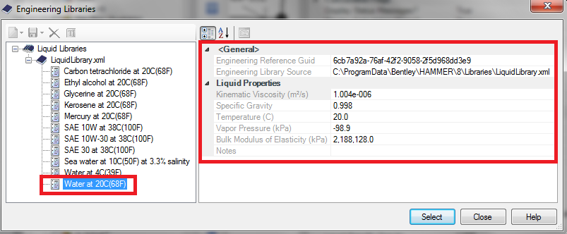

3) This opens the Liquid Libraries for the Engineering Library and you can select the liquid that you'd like to use from there. Note that on the right hand side of the window the liquid properties like Kinematic Viscocity, temperature, Vapor Pressure, and the bulk modulus of elasticity are displayed.
4) After you create or decide on one of these use the select button to choose that liquid. Ensure the appropriate liquid library entry is selected in your calculation options. If you would like to compare different liquids, create a new calculation option with the appropriate liquid selected, then assign the calculation options to a new scenario.

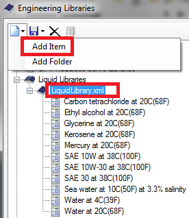

5) If you'd like to create a new liquid with different characteristics go to Components > Engineering Libraries and expand the liquid library. Left click on the 'Liquid library.xml' label as shown in the screen shot below and then click the 'Add Item' option. Finally, enter your data and name the new liquid. Click close when done. See more here.
