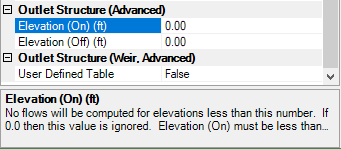

If you want to assume the clogging / debris is stuck at the bottom of a culvert, weir or vertically-oriented orifice, you could use the "Elevation (On)" field in the composite outlet structure for that particular outlet component. Set this to the elevation that the clogging rises up to. For example of a weir invert is at 100 ft but it is clogged up to an elevation of 102 feet, set the "Elevation (On)" to 102 ft and there will be no flow through the weir until 102 ft.
