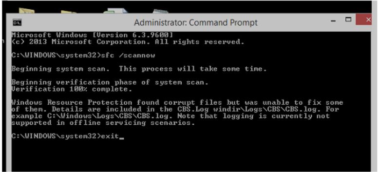

This issue can also occur if there is a problem with the Microsoft .NET Framework prerequisite.
In one case, the Windows Event Viewer Application log contained a separate entry corresponding to the time of the crash, indicating an issue with "CLR20r3".  Running a scan on the system resulted in the following:
It appears the issue has to do with the .NET Framework component that is a part of the operating system.  The user had a repair done on his operating system to resolve this issue.
In another case, a full reinstallation was necessary:
