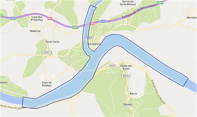

To create a curvilinear grid in OpenFlows FLOOD a polygon covering the area where the grid will be constructed is necessary. You can load the polygon file onto the Map or you can create one using the “Toolbox -> Geometry Layers -> Create Polygons Layer”. Keep in mind that if for example you’re trying to create a curvilinear grid for the river, it is recommended that the polygon covers the river area but also the margins, as shown in the image below.

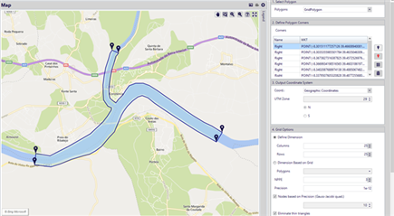

Once you have the polygon layer loaded on the Map, you can create the curvilinear grid by using the “Toolbox -> Grid -> Create Curvilinear Grid".
The tool window appears docked on the right side of the main window.
There are six steps in this tool.

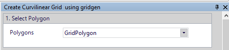

The first step is select the polygon layer mentioned above as shown below (in this example the polygon layer is called “GridPolygon”).
Second, the user must define the grid polygon corners/bends. This is a very important feature as it will determine how the grid is constructed, especially when the area of simulation includes channels, bays, sharp bends, etc. In the “Define Polygon Corners” tool, you’ll have to manually set in the Map window, where the corners are and set their direction (right or left bend). For right bends, select the blue marker and click on the map over the polygon vertex that is located at a sharp right bend, as shown below (in this case we assume the polygon orientation is clockwise, but a counterclockwise orientation can also be used, as long as the right and left bends are identified consistently).

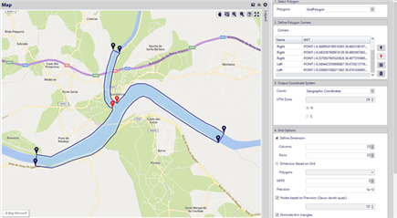

Then do the same for the left turns using the red marker as shown below:
If the polygon corners are not correctly defined, the grid will be highly distorted and might not have a matching boundary with the polygon. In some cases, careful consideration must be given when choosing the corners, and different corner definitions might generate valid, but different, grids. The methodology here is to try different approaches and select the best one.

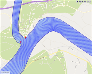

After all the above steps, the grid can be generated in pressing the "Generate Curvilinear Grid" button.
The curvilinear grid will appear on the Map window as shown below.
