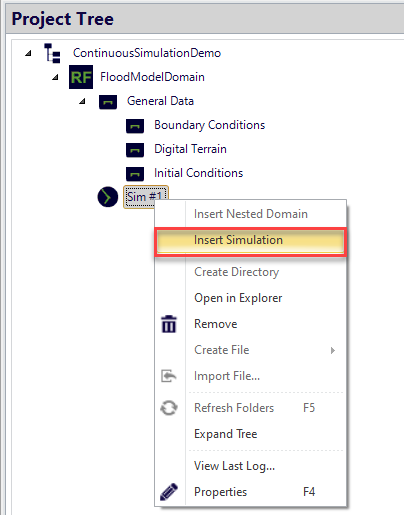

Once you have ran a simulation in OpenFlows FLOOD and you want to restart and continue that simulation from the last computed solution, you have to select the computed simulation in the Project Tree, right click with the mouse and select "Insert Simulation", as shown below:

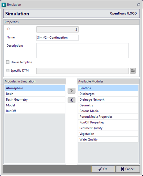

This creates a new simulation. You can give it a intuitive name as shown below:

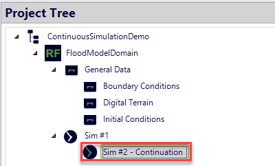

Press OK and then a new simulation will appear in the Domain's simulation tree (as shown below):
Once the simulation is created, the input data files from the previous simulation are copied to the continuation simulation and the restart option is automatically turned off in the modules that require initial conditions (e.g. Basin, RunOff, etc.)
