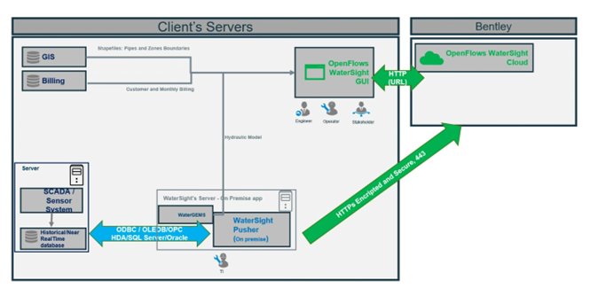

WaterSight consists of the cloud application and includes also an on-premise software tool called the “Sensor data pusher.”  The WaterSight Sensor Data Pusher collects and pushes the raw Sensor values periodically to the WaterSight cloud database at a predefined interval. The sensor data pusher can connect to the following data sources:
  • ODBC
  • OLEDB
  • OPC HDA / OPC DA
  • SQL Server Source
  • Oracle Connection
  • Access / Excel
The data pusher should be installed in a on-premise machine or server that has the right access to the defined data sources, in order to ingest raw Sensor data into WaterSight in the Azure cloud. The installation of this pusher tool will only be done after the utility provides all the access and permission to the on-premise machine and data sources.

Data Pusher General Architecture
A computer screen shot of a computerDescription automatically generated
Minimum data requirements for the server where the Sensor data pusher gets installed:
  • The machine must always be running 24 hours/7 days a week
  • Minimum RAM recommended for operating system
  • Minimum 4 Core CPU
  • Disk space (3 GB initially) for OFOSC files and historical data back-fill
  • Windows 10 or a recent Windows Server
  • Windows Service User account with Administrator privileges
  • .NET Framework installed (ideally)
  • Allow the following connections through firewall:
    • connect-watersight.bentley.com
    • (connect-watersight-weu.bentley.com if hosted on Western European site)
    • Port 443
  • Having WaterGEMS installed

2 - How to assure the connection is secure?
Once datapusher is installed, data will start to automatically flow from the utility server to WaterSight cloud following an unidirectional communication. Nothing can flow in the opposite direction (from outside to inside the utility server). Besides this the connection is done via an HTTPs encrypted and secure API, and the utility can still restrict which connections are allowed through firewall.
