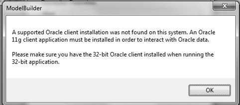

"A supported Oracle client installation was not found on this system ..."
Here are some basic things to check first:
1) First, make sure you have the Oracle 11g client installed, matching the "bitness" of the version of the product you're using. You can find this under Help > About. In the lower-left corner after the version number, you will see "32-bit" or "64-bit". If you see neither, you're using a 32-bit version. If you can confirm that the Oracle 11 client is installed, make sure you have the latest version and/or cumulative patch set applied. Contact technical support for assistance with finding the latest cumulative patch set.

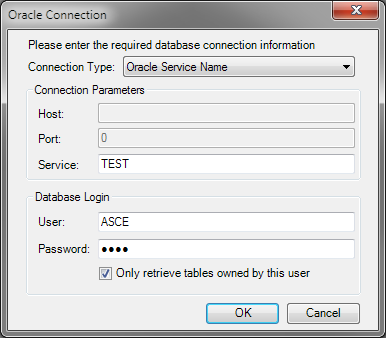

4) If you are using service name, check and ensure that there are no problems with your tnsnames.ora file. On Windows 7, 8 or 10, the default location is C:\app\<User.Name>\product\11.2.0\client_1\network\admin
In here, you would see something similar to the below to define the service name:
  TEST =  (DESCRIPTION = (ADDRESS = (PROTOCOL = TCP)(HOST = exampledb.bentley.com)(PORT = 1521))(CONNECT_DATA = (SID = orcl)))
Then, in the Modelbuilder Oracle Connection dialog, you would enter that service name. Using the example above, it would look something like this:
5) If the tsnames.ora file does not appear to be working, you can try entering the entire connection string in the "Service" field. For example:
(DESCRIPTION=(ADDRESS_LIST =(ADDRESS =(COMMUNITY = TCP)(PROTOCOL = TCP)(HOST = exampledb.bentley.com)(PORT = 1521)))(CONNECT_DATA = (SID = ORCL)))

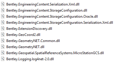

Could not load file or assembly Bentley.Geospatial.SpatialReferenceSystems.MicroStationGCS
This has been known to occur in version 24.00.02.20 when using an Oracle Spatial SDO data source. It was found that some DLL files may be missing from the installation folder, which were present in previous versions. Please contact Technical Support for help, or if you have access to install MicroStation, copy the following DLL files from within the MicroStation 2024 installation folder (some are in subfolders like "Assemblies"), to the root of the OpenFlows Water/Storm/Sewer installation folder:

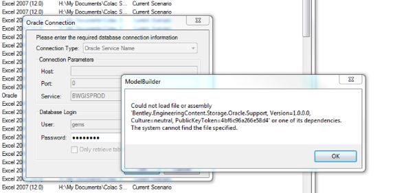

Could not load file or assembly Bentley.EngineeringContent.Storage.Oracle.Support.dll
When using an Oracle file as the Data Source Type in ModelBuilder one of the following error occurs:
"Could not load file or assembly Bentley.EngineeringContent.Storage.Oracle.Support ..."
"Can't convert from String to Double"
This has been known to occur in some cases due to the operating system regional / language options. Specifically the decimal separator when using a region such as Italy. This will be addressed in a future version (reference defect # 382348)
