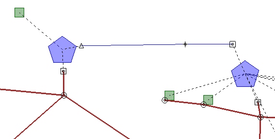

With a pond approach, you would replace the inlets with pond outlet nodes, connected to a single pond. The pond elevation-area or elevation-volume curve would be set up to represent the in-sag area above the inlets that water would pond up in. Overflow from the catchbasin inlets would enter the pond and the change in storage and elevation would be communicated to each of the inlets. When the conditions warrant, water stored in the pond would recede back into the sub-surface network.
The pond outlet node's "has control structure" property would be set to "true" and a Riser could be considered as the composite outlet structure. A riser simulates weir flow at low depths and orifice flow at submerged depths, similar to typical grate and curb inlets.
In many cases you will have multiple sub-surface pipes (conduits) connected to the catchbasin. Since multiple conduits cannot connect directly to a pond outlet node, a large diameter, short length pipe is suggested, between the catchbasin location and the pond outlet. The catchbasin in the model would be replaced with a manhole with a bolted cover ("Bolted Cover?" = True). With this setup, the hydraulic grade should be appropriately "communicated" between the pond and the pipe, though this could pose a hydraulically challenging situation, potentially requiring some calculation option changes. (see further below)

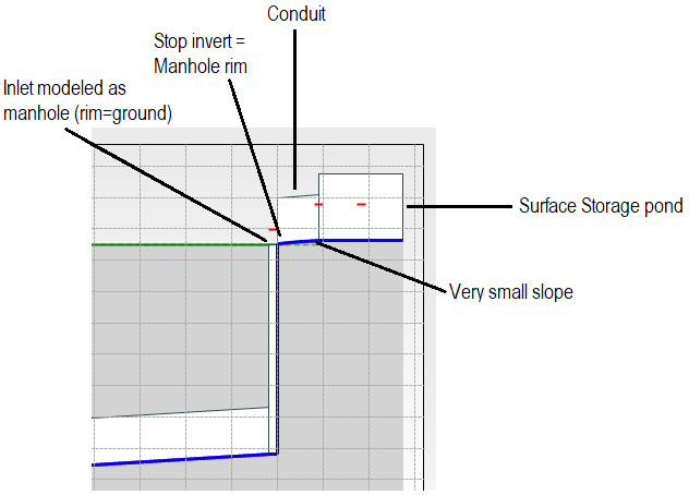

The invert of the end of the conduit next to the pond outlet would be set equal to the invert of the sub-surface pipe leaving the catchbasin vault. The invert of the Riser outlet component and the bottom elevation of the pond would be set equal to the inlet elevation.
Another approach would be to connect the short conduit between the pond bottom and the inlet (manhole) rim elevation. Meaning, set the conduit stop invert equal to the manhole rim. This will enable the numerical solver to "see" this conduit essentially as a gutter between the inlet surface and the pond. The pond outlet structure orifice or riser crest elevation would be set equal to the pond bottom. See below screenshot of the profile view:

Here is an example model demonstrating the pond approach above, including upstream gutters attached directly to the pond via outfalls. Note that this model cannot be opened in versions of SewerGEMS or CivilStorm below 10.01.XX.XX.
