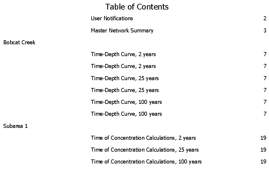

When using PondPack's Report Builder, the table of contents uses the page number of the first page in the section for all subsections.

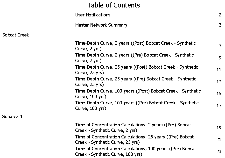

Download and apply the latest patch set (dated July 25th, 2016 or later). After doing this the subsections will show the corresponding page numbers and the scenario.
