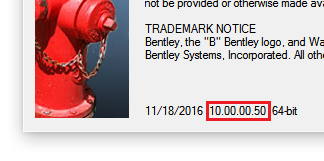

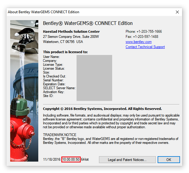

The version number will be shown on the bottom-left corner in the About dialog.
Use the following steps to find the version of the product you have installed.
CONNECT Edition: Go to File > Help > About [Product]
V8i: Go to Help > About [Product]
