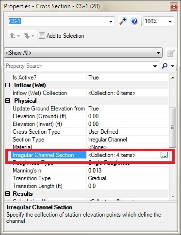

Browse to the cross section(s) generating the error message and open the properties. Click the ellipsis (...) button in the cell for irregular Channel Section.

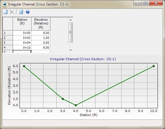

This will open the Irregular Channel dialog.
Make sure that the elevation values entered for "Elevation (Relative)" are set so they are relative to the invert elevation of the cross section. The lowest value will be zero. The highest will generally not go above the ground surface elevation.
