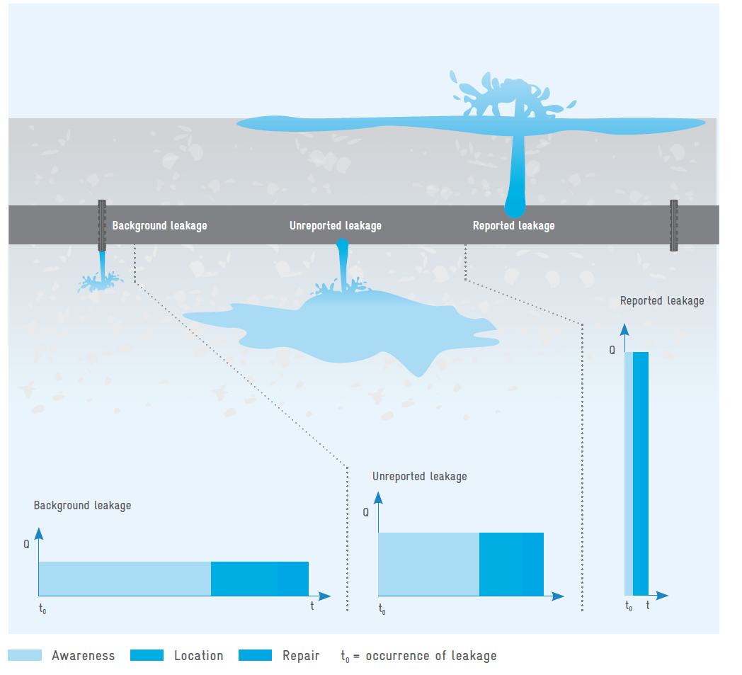

Types of Bursts
Leakage can come from transmission and distribution mains – pipes, junctions or valves (usually have medium to high flow rates and short to medium runtimes) and from service connections (sometimes referred to as the weak points of water supply networks, because their joints and fittings exhibit high failure rates). Leaks on service connections are difficult to detect due to their comparatively low flow rates and thus often have long runtimes.
In terms of leak flow and run time, generally bursts can be grouped in three different types (Farley, M., Leakage Management and Control. WHO, 2001):
 The Figure below presents the different types of bursts and the typical leakage rate and runtime associated.
Figure 1.  Relation between the different types of bursts and their leakage rate and runtime (from Guidelines for water loss reduction)

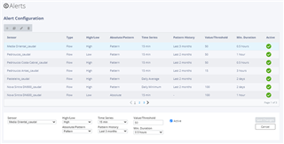

Configuring Bursts Alerts (based on a flow increase)

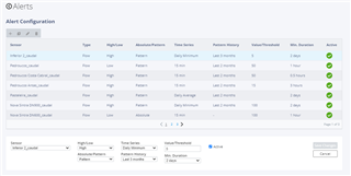

Alerts can be configured by the admin user in the Alerts Administration page and once generated by the system they become available in the Alert list page.
Alerts can be generated based on two methods: i) pattern based alerts, where SCADA or other telemetry data (processed) is compared with the expected behavior for that sensor or zone and ii) absolute based alerts which are evaluated by directly comparing real time data (processed) with the user defined threshold. For more details about this, please go to the Alerts administration help page.
The aim of this article is to support the user in the definition of the most adequate triggers in order to "catch" most of the system bursts and simultaneously trying to minimize the number of false positives.  In order to achieve this, the user should try to replicate in the alerts trigger configurations the type of bursts represented in Figure above.
The examples explained below use the sensor or zone pattern to generate the alarm. This means that the alarm only gets generated if the real values go outside the pattern confidence bands (above percentile 95), and also based on a minimum duration and threshold value defined by the user. These type of alarms (based on the pattern) should only be assigned to flow or zone sensors that really have a typical daily pattern.

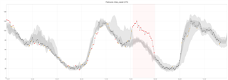

Large Burst Alerts
Large bursts usually correspond to big flow rates and short durations, as they are quickly reported by the public or the utility staff.
WaterSight can help the utility further reducing awareness times for large bursts. Alerts for these events should be configured according with the following:

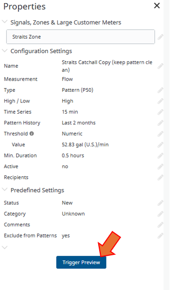

It is recommended to check the trigger preview before enabling the alert trigger. The trigger preview allow to easily assess and understand the number of events that would be generated based on the user configurations. More information in the Alert Administration article, under the Trigger Preview section.
Note: Configuring a large burst alert with bigger durations may increase awareness times for these type of occurrences. Configuring a large burst with smaller threshold values can generate significant false positives.

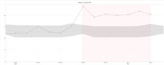

Figure 2. Above - Large burst event represented in the sensor detail graph (15 minutes time series). Below - Large burst configuration example (values in m3/h).

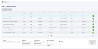

Note: Configuring a medium burst alert with shorter durations or smaller threshold values can generate significant false positives.
Figure 3. Above - Medium burst event represented in the sensor detail graph (15 minutes time series). Below - Medium burst configuration example (values in m3/h).

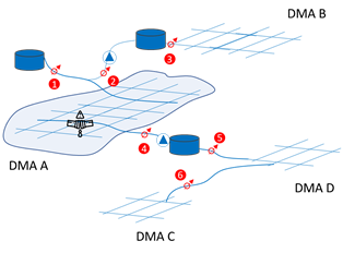

Example below
  1. If there is an anomalous flow increase in sensor number 1, it is not possible to know if the increase is at the DMA A level or in other DMA or even due to some tanks overflows.
  2. Pattern for individual sensor number 1 includes the distribution to DMA A plus pumping to the two downstream tanks, so that is possible that sensor 1 will not have a very clear and well defined pattern (spikes are expected to occur at different times of the day). We can have a much more reliable pattern where we exclude the interferences of the tanks and pumps, if we rather consider the zone flow of DMA A, as it will be already the final balance between all inflows and outflows (in this case 1 – 2 – 4)

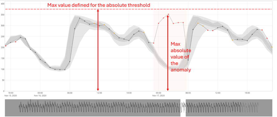

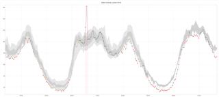

Defining absolute alerts based on an increase in flow or a decrease in pressure to notify about burst and leaks, may only be viable in some conditions when a specific zone does not have a reliable pattern. Whenever patterns exist, the pattern should be used to trigger these alerts. Disadvantages of using absolute alerts to trigger bursts and leaks events are related with the generation of false positives (alerts that are generated and shouldn't have been) or related with missing important real events (alerts not triggered for real events). Below some explanations:
Figure 5. Example of an anomaly not detected because its maximum value was below the absolute value defined in the alert rule.

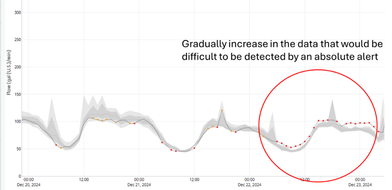

Figure 6 - Gradually increase in the time series values along time that would not be detectable using and absolute alert type.

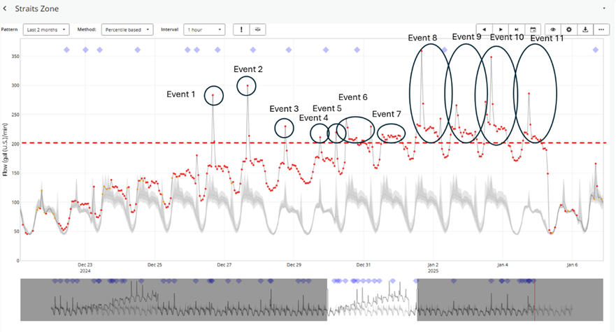

Figure 7. 11 events were generated for the absolute alert (assuming an absolute threshold of 200)

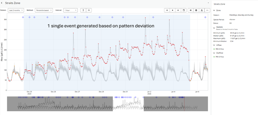

Figure 8. Only one event was generated for the pattern alert. The event starts when values start to go outside the pattern bands and it automatically finishes once returns to normal (to the patterns again).
