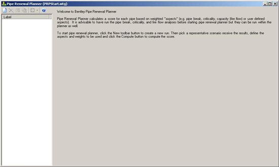

This opens the welcome dialog if no analyses have already been run.

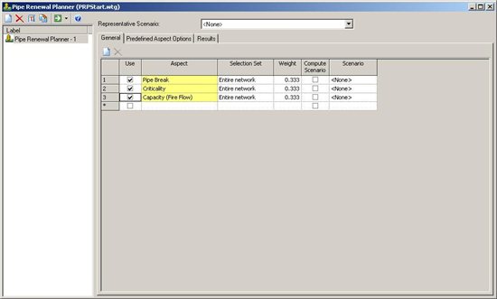

To start a new analysis, click the New icon in the upper left. A new pipe renewal planner label will appear in the list on the left, while the section to the right will be populated with default aspects: pipe break, criticality, and capacity (fire flow).
Each aspect has a select number of properties associated with them. The Selection Set column allows you to choose either the entire network or a predefined selection set of elements for the aspect analysis. The Weight column is a way for you to decide how much emphasis will be placed on a certain aspect in Pipe Renewal Planner. The Scenario column defines which scenario the data for the individual aspect comes from. These different scenarios can be computed ahead of time, which will save some computational time for the Pipe Renewal Planner analysis itself. Computing the scenario ahead of time will also allow you to verify that the results for the aspects are reasonable. However, if you have not computed the scenario, you can put a checkmark in the Compute Scenario column and Pipe Renewal Planner will compute the scenario during the analysis.

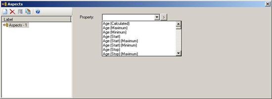

In addition to the default aspects, you can also add new aspects for the pipe renewal planner to account for. To do this, either click the New icon below the General tab or simply click in the empty cell beneath the default aspects. Then click in the cell and select the ellipsis button.
This will open the Aspects manager. Select the New icon to create a selection. Then select which property you would like to be considered in the analysis.
Whether you use the default aspects or create new ones, you will need to select the Representative Scenario for the analysis. This does not need to be the current scenario. The representative scenario will be used as the source of element properties and the location to save results except where another scenario is explicitly called out.
Note: Two Pipe Renewal Planner configurations cannot share the same representative scenario. If a scenario is selected, it is not available as the representative scenario from the pulldown menu for other Pipe Renewal Planner configurations.

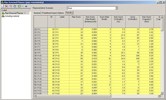

If you click the Results tab, you will see the results of the analysis.
The overall score for the pipe is found in the Pipe Score column. It is the weighted sum of the individual aspect scores. A higher value indicates a pipe with potential problems in need of repair, rehabilitation, replacement or some other remedial action. Scores are presented on a 0 to 100 scale unless the user has set up some different scaling.
Other data included in the results tab include the scores and results for the individual aspects. The data can be sorted by right-clicking on a column header and choosing the Sort function. By choosing “Sort Descending,” the highest score will be at the top.

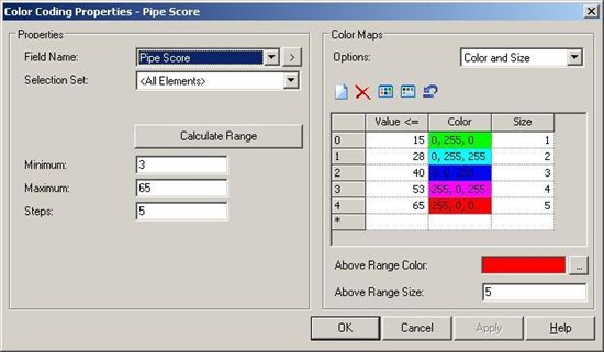

You can also view the data graphically in the drawing pane by setting up color coding in the Element Symbology manager. Open this by clicking View > Element Symbology. Right-click on Pipe and select New > Color Coding. This will open a new manager.
Choose “Pipe Score” from the Properties pulldown and select the range. You can initialize the color coding on the right side of the manager. More information on color coding can be found under Help.
