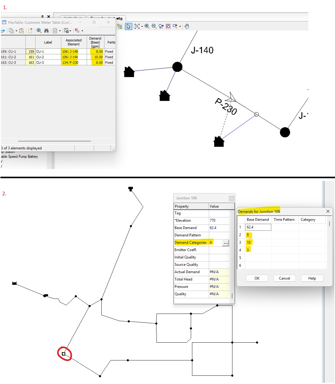

Importing Customer Meter demand to EPANET 2.2
*Although it is not technically feasible to import OpenFlows Customer Meter directly into EPANET, the customer meter demand will be routed to the junction associated with it. As illustrated in screenshot below,"1." displays the WaterGEMS model, with customer meters base demands associated with the pipes and junctions. "2." displays the EPANET model following the importation of the SewerGEMS data. As  shown, the customer meter demands in EPANET have been incorporated into the "Demand Categories" field.
