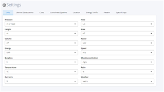

Administration page to configure the general settings for the system (Digital Twin). It is divided into the following tabs:
Units
Definition of the display units and display precision in WaterSight.
Service Expectations
User defines the pressure requirements, and minimum admissible pump efficiency. The minimum pressure requirement will be used the identify all low pressure customers affected during operational events, while the minimum admissible pump efficiency will be used to identify the number of inefficient pumps that are displayed in the Home page.

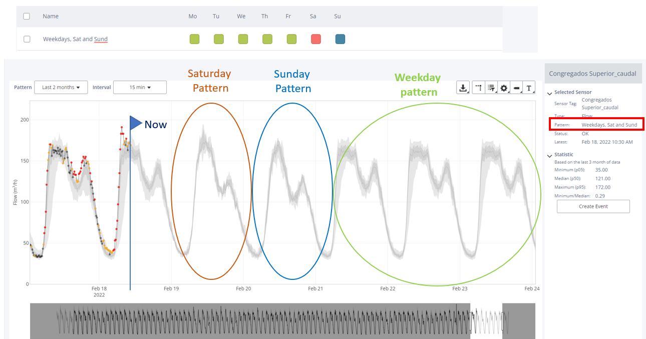

User can customize how patterns are computed in WaterSight by creating different group days. The default is a weekday pattern (that uses past days from Monday to Friday to calculate a pattern), a Saturday pattern (that uses only past Saturdays to calculate a pattern) and a Sunday pattern (that uses only past Sundays to calculate a pattern), as exemplified in Figure below.
The pattern group for any sensor or zone is then displayed on the right side panel of the sensor or zone graph.
Default Pattern - Weekday, Saturday and Sunday
Figure 1 - Default Pattern defined in the settings (above) and how gets displayed in WaterSight (below)

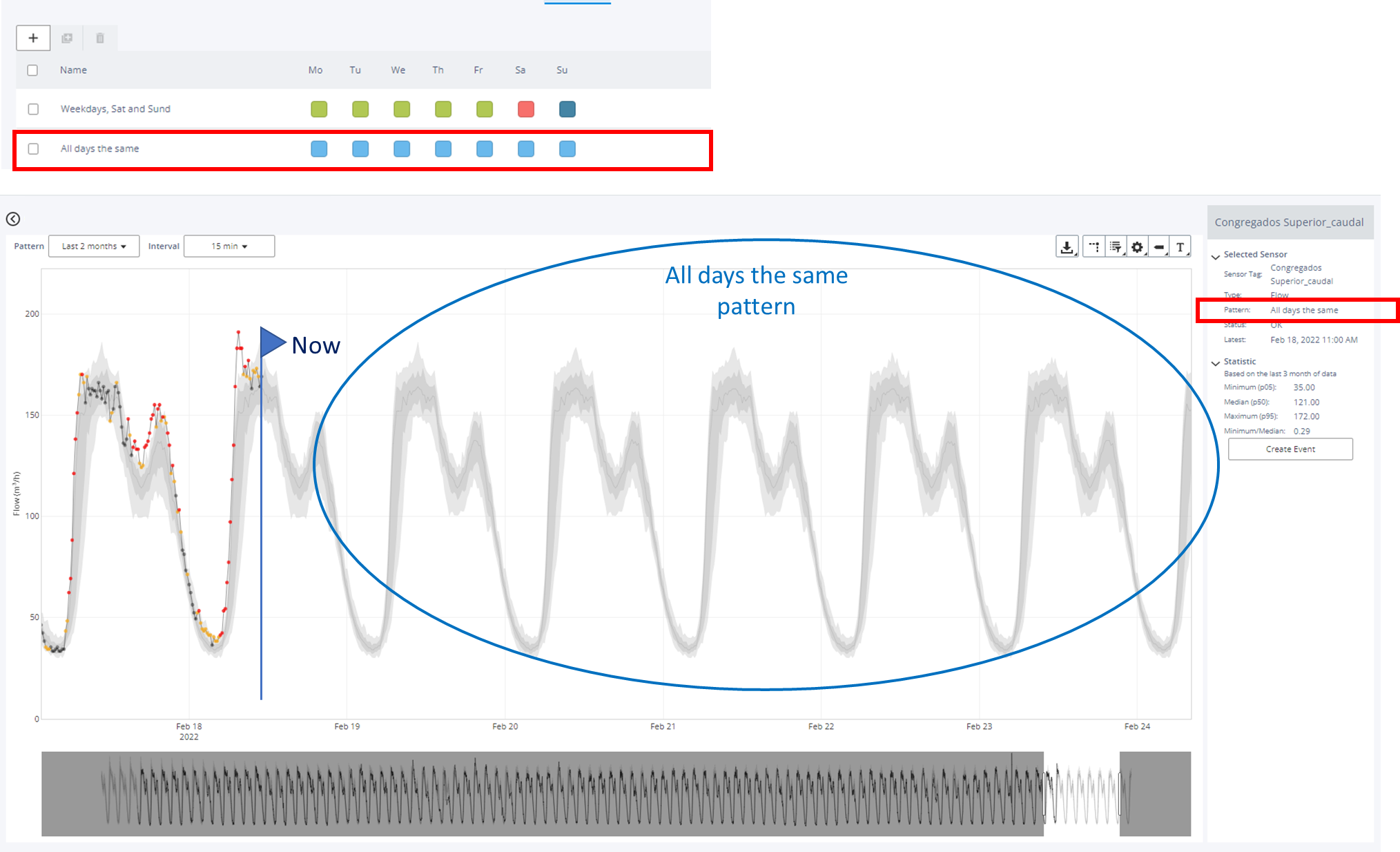

The default pattern can never be deleted, but the user can add as many patterns as needed by clicking in the Add button located above the table. See below for some examples:
Example 1 - All days the same
Figure 2 - Creating a pattern that groups all days will result in the same exact pattern for each day of the week.

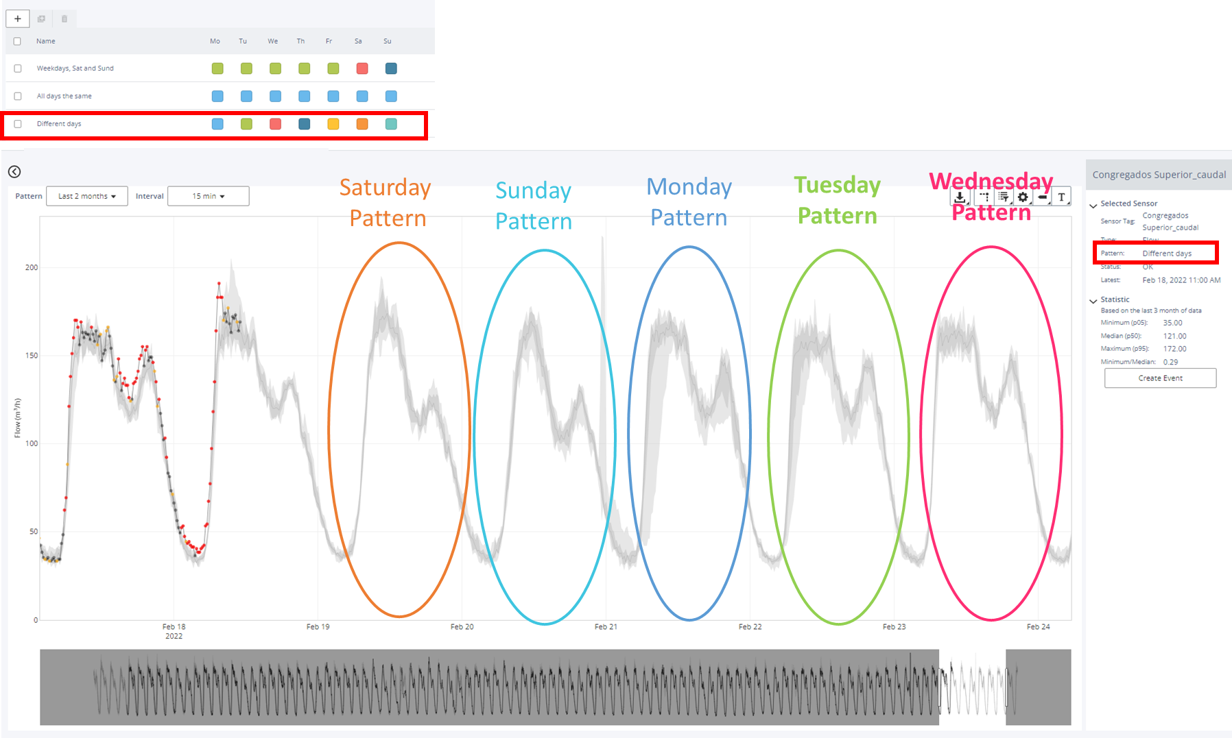

Example 2 - Each day is different
Figure 3 - Creating a pattern that distinguishes each day will result in a pattern different for each day of the week. The bigger the difference in real data for each day of the week, the bigger the difference we will notice in the patterns for each day.

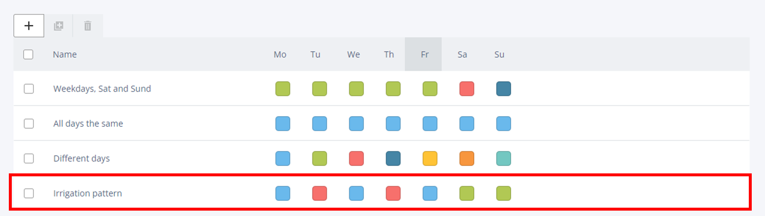

Some other use cases can be for example distinguishing between days with irrigation and days without irrigation. For example imagine that for a specific area irrigation occurs at each Monday, Wednesday and Friday. In that case we could setup a pattern like below:
After creating the patterns the user needs to assign them to the sensors and zones. This can be done through the sensor and zone page configuration. In the sensors and zones configuration page there is also a "None" pattern option. When defined, no pattern (grey bands) will be displayed in the sensor or zone graphs.

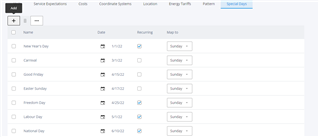

Special Days
Some special days such as national holydays or Christmas day have a very specifically and typical behaviour that are very different from a normal week day. Now we can consider these special days when calculating patterns. By default a national holiday will be treated similar as a Sunday (as people do not work, national holidays tend to be more similar to Sundays than to a normal working week day).
Click on the more (...) button located above the table to automatically add all the holydays for the given location of the digital twin.
The user can still add more special days, apart from those automatically considered, by clicking in the add (+) button above the table.
When special days are added they will be automatically considered and applied in the pattern calculations of all sensors and zones.

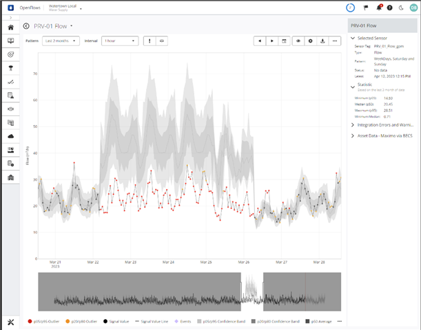

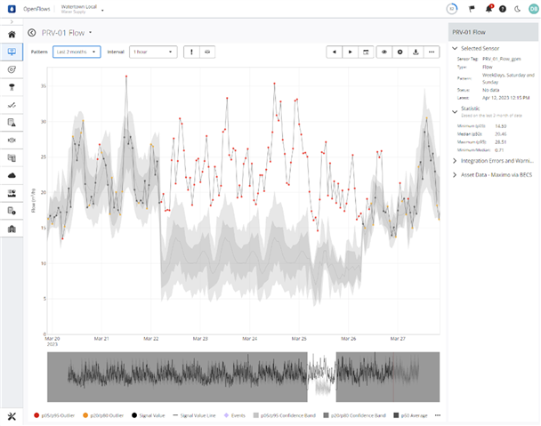

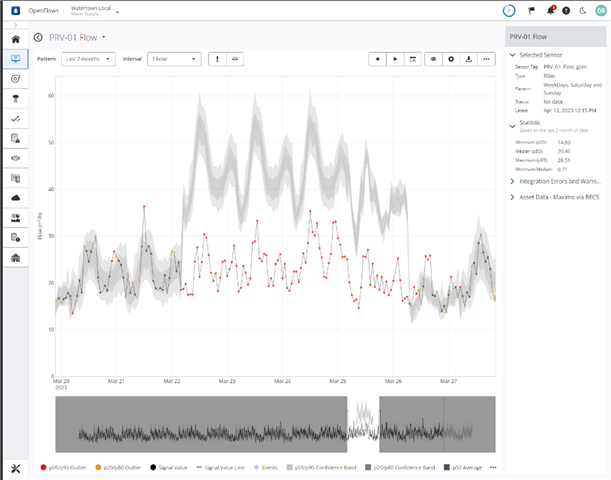

The admin user can control and adjust the way patterns are being automatically calculated by the solution:

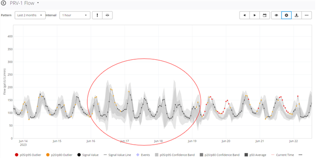

These adjustments may be important when considering special periods such as Christmas holydays, Easter holydays, school breaks, or even seasonality transition periods (transitions between summer/winter periods). For these special periods the default calculated patterns by the solution may not feet precisely with the real time measurements, which can lead to generation of some false positive events during those periods, and adjusting the patterns can avoid this.
Below are some examples of the patterns when changing offset and buffer variables.
Pattern Offset 100%, Pattern Buffer 0% Pattern Offset -50%, Pattern Buffer 0%
Pattern Offset 0%, Pattern Buffer 100% Pattern Offset 100%, Pattern Buffer 200%
Note: Special periods are limited to a maximum of 29 days. The user can include a larger period by creating two consecutives special periods, one after the other. Just note that in that situation the user may start to see no patterns (percentiles bands) at all in the graphs and this may impact events generated based on the pattern. The reason for this is because special periods are considered anomalous periods that are not considered when calculating future patterns (special periods are automatically excluded from future patterns calculation) . Because the patterns are calculated based on history (last month, last 2 months,  last 3 months, etc) and if for example last month corresponds to a special period than the future pattern (after the special period) considering last 1 month of data will not be calculated.

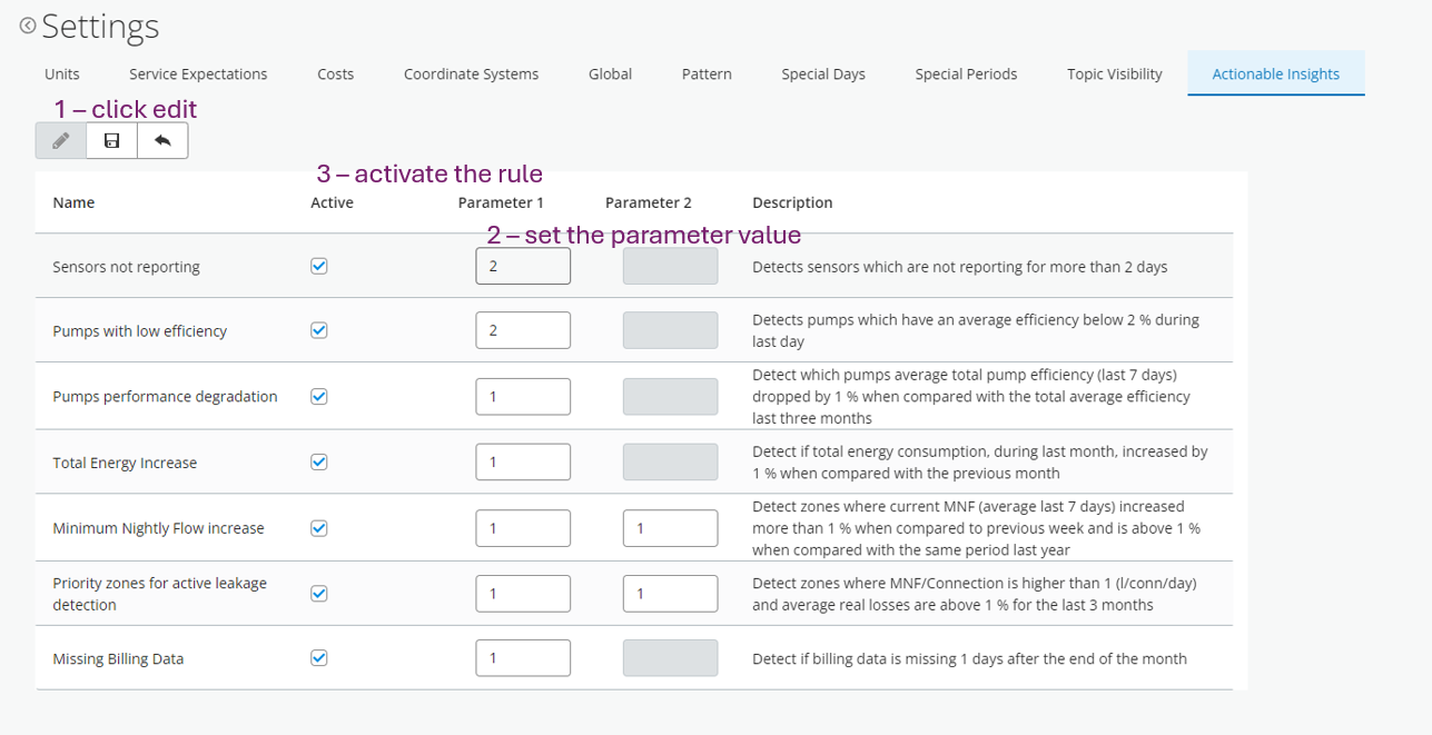

Actionable Insights
WaterSight can automatically generate issues that can translate potential problems, based on the different data that is processing. In this tab seven rules are automatically defined and the user can enable or disable those rules as well as set the parameters that will trigger the issues.
To edit a parameter or to enable one of the rules, the user should first click in the edit button above the table.
Once the rules conditions are met, the issues will be automatically generated and listed under the Event Management menu >> Issue Resolution page. From there the user can see more detail about the issues as well as manage those (assign, change status, comment, etc).
Please note that another issue for the exact same problem/rule will not be generated/duplicated if the current issue listed under Issue Resolution page is still open, instead the existent issue will get updated with the most recent values.
For more information about the Issues that are generated and how to manage, click here: Issue Resolution
