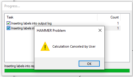

"Calculation cancelled by user" when attempting to compute transient simulation in HAMMER
Product(s): HAMMER
Version(s): 10.03.05.05 and higher
Area: Other
When attempting to compute a transient simulation in HAMMER, it suddenly fails and reports "Calculation cancelled by user" even though the progress was never cancelled by the user.
This can occur if the transient solver encounters a situation that it cannot handle and does not have a validation message for. Here are some possible causes:
