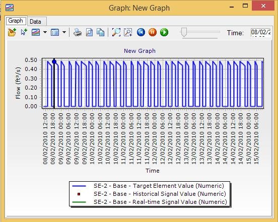

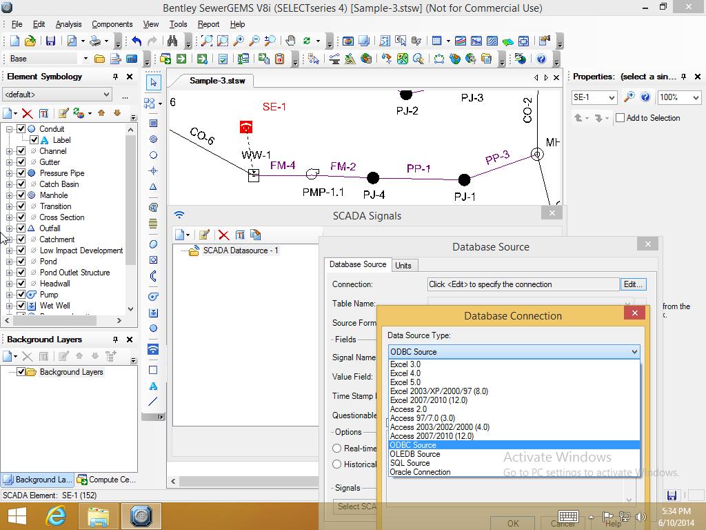

SCADAConnect
Note: this feature is only available in SewerGEMS.
SCADA connection will now be available, live data connections can be set up to SCADA systems, so that SCADA data can be used for calibration purposes and real-time simulations. SCADA data can be added from different sources like ODBC, OLEDB, SQL, oracle connection, Access, Excel etc. Data can be real time or historical.  More information can be found in the help documentation.
To use this function go to Tools>SCADAConnect. Here you can define the SCADA signal, SCADA element's properties and SCADA log, initial settings can be imported as well.
A SewerGEMS license includes an unlimited SCADA signals for use in SCADAConnect.
 SCADA Element
SCADA element has been added to support SCADA connection. This element represents a real-world SCADA signal that is associated with a hydraulic element in the model. It displays both real-time and historical SCADA data as well as the difference between SCADA and model results. Detailed information on the SCADA Element can be found in the New SCADA Element solution.

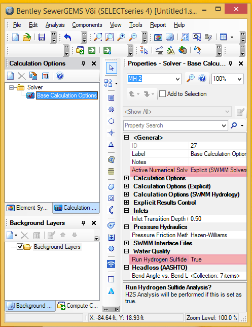

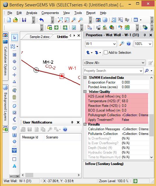

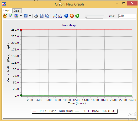

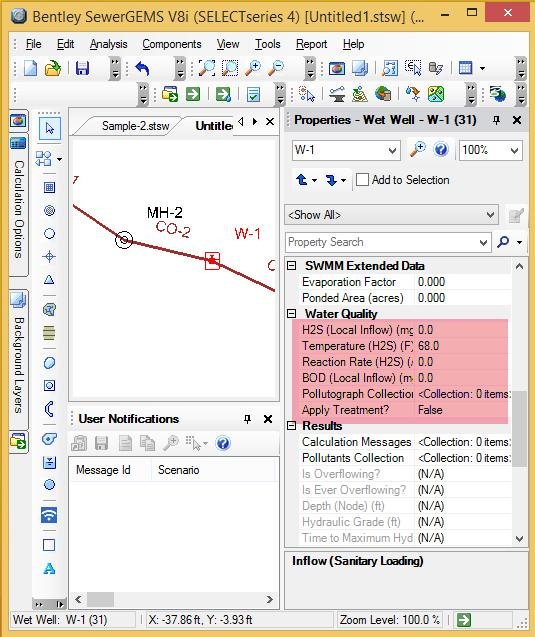

 Hydrogen Sulfide Modeling
Hydrogen sulfide formation in pipes can now be modeled with nodes and wet wells, when using the Explicit (SWMM) solver. Sulfur exists in many organic and inorganic forms. For wastewater, the prevalent forms are sulfate (SO-4), hydrogen sulfide (H2S) and hydrosulfide (HS-). Sulfate is found in all wastewater in high concentration, so there was a need of introducing the option of hydrogen sulfide modeling in SewerGEMS, so this feature has been added.
To run a hydrogen sulfide model, the explicit solver must be selected in the Calculation Options or Compute Center and run Hydrogen Sulfide Analysis needs to be set to True in the Calculation Options.
For more information on modeling hydrogen sulfide, see the below article and imbedded video:
Modeling septicity / hydrogen sulfide (H2S)

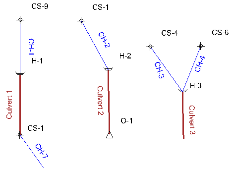

Headwall Elements
New feature has been added which supports culvert headwalls and endwalls, which can connect to open channels or closed conduits. Headwall elements are node elements which enable the modeler to better model conduit and culvert headwalls and endwalls. Headwall elements can be used to model any transition from/to an open channel or pond for/to a closed conduit. Only a conduit link can be used to model a culvert. New culvert inlet coefficient library has been added to design the culverts.
In previous versions to design culvert you needed to choose the option is culvert to ‘True’ in the properties of the conduit. But now headwall has been added as separate element for designing culverts which allows for defining Culvert Physical properties in the headwall element itself rather than the Conduit. Below are some possible combinations of headwall elements.
To understand the Headwall elements briefly please see the support solution below.

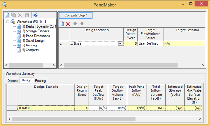

PondMaker
PondMaker tool has been introduced in SS4. It’s an easy step-by-step detention pond and outlet structure design tool. PondMaker was originally implemented for PondPack, now it has been included in SewerGEMS & CivilStorm. So with this release ponds also can be designed. It’s available for Implicit (SewerGEMS), Explicit (SWMM), and GVF Convex solver, but not for GVF Rational solver.

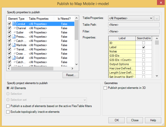

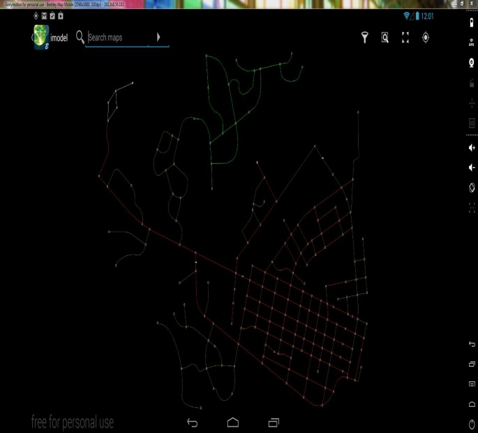

Bentley Map Mobile
It’s possible now to view SewerGEMS/CivilStorm models on Android, iPad & iPad mini tablets; you just need to have the Bentley Map mobile application. The new tool has been introduced-Bentley Map Mobile, which publishes map mobile i-model, available in file export options. Even background files can be viewed but individually in the view filter list in map mobile.
This tool is beneficial for the users who don’t have Bentley software; the models can still be sent to them so that they can view the models on their Android, iPad & iPad mini tablets.

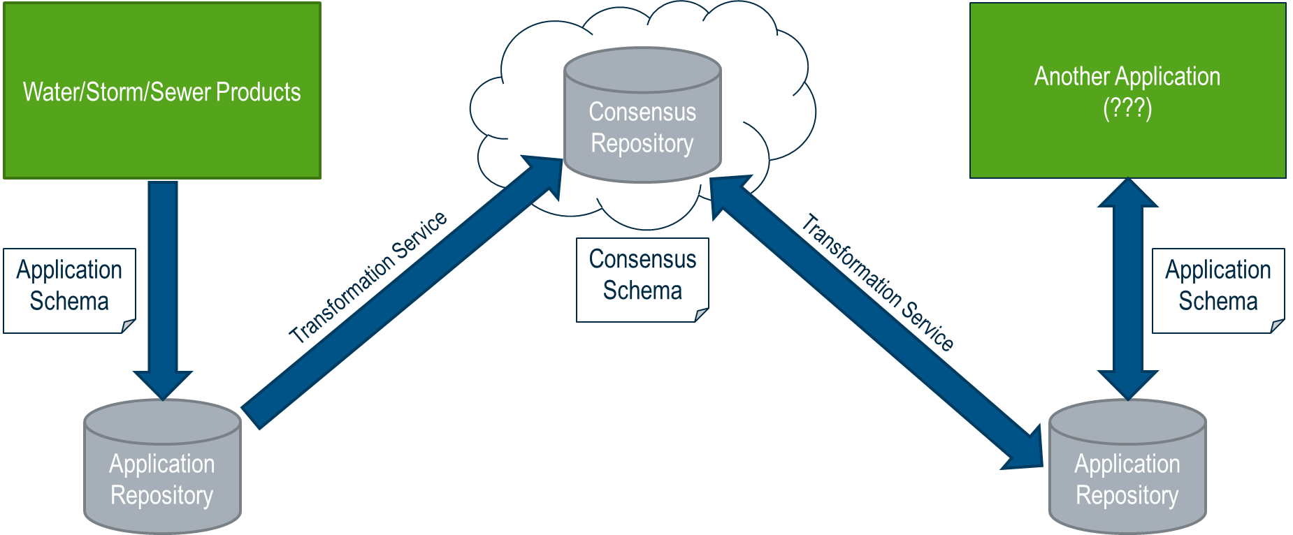

ProjectWise Cross-Discipline Coordination Services
ProjectWise Cross-discipline Coordination Services refers to a shared library of code and tools used to facilitate the communication of model engineering data between two or more separate applications. Repository management allows communication between two different applications, one being SewerGEMS. Repository needs to be created for this, through File>Repository Management>Create/update Repository.
For example, suppose the building construction software wants to communicate relevant information about the model with the software being used to design the parking lot for the building.  PWXDCS allows this communication through a separate store of information called a consensus repository.  This consensus repository has a schema called the consensus schema.  The consensus schema only contains those fields/attributes that are common/relevant to the software using it to sync data (in this example, the common fields/attributes between the building software and the parking lot software). Below is the workflow:

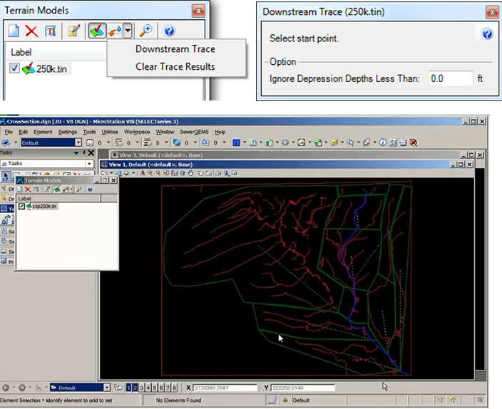

 Downstream Trace
The new tool has been added called Downstream Trace which works with Terrain models. Once you have the terrain model active, then you can find the path from a start point to a lower point with greatest gradient. The trace may stop at a local low point if we do not ignore local depressions; the trace can stop at a lower downstream point if we ignore local depressions. The downstream results can be deleted once viewed.
Downstream trace is ability to trace water drop so that users can place inlets at proper locations according to the catchment delineation. It helps in deciding the inlet locations according to the catchment boundaries & gradient.

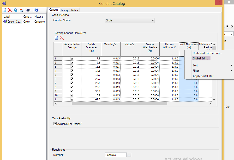

Redesigned conduit catalog
In SS4, the conduit catalog has been redesigned in more user-friendly manner. Wherein you can edit the properties like Manning’s n, wall thickness etc. in the conduit catalog for all the selected sizes at a time.

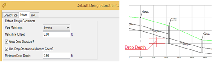

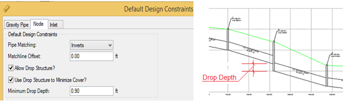

New Drop Structure Constraint Based Design Constraints
With this new release few changes have been made to drop structure modeling as per the requirement of users. Earlier only when manhole upstream pipe slope exceeds the conduit maximum slope and the Allow Drop Structure is set to true in design constraints so we designed manhole drop structure. With this version, now users can design drop manholes to minimize the volume of excavation. Two new design constraints, Use Drop Structure to Minimize Cover and Minimum Drop Depth, are added to node default design constraints. Same has been added to local design constraints.
If both Allow Drop Structure and Minimize Cover of Node Connected Pipes are set to true, Minimum Drop Depth in design constraints will be compared with the Drop Depth when drop structure is designed at the node. Drop Depth is the difference between the upstream pipe invert at the node, when drop structure is designed and the upstream pipe invert at the node when drop structure is not designed.
Please note that this applies to GVF Convex & Rational Solvers.

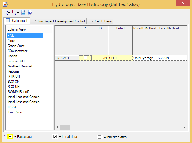

New Hydrograph & Loss Methods
Additional hydrology methods now have been added to the Hydrology alternatives which are ILSAX or time-area hydrograph methods to compute the runoff. As well infiltration losses now can be computed using ‘initial loss and constant fraction’ or ‘initial loss and constant rate’ methods in addition to the existing loss methods. The prior “fLoss” method is renamed as “Constant Loss Rate”, the methodology in calculation remains same. More information you can find in the help documentation.

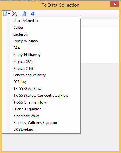

New Time of Concentration Methods
New methods of calculating the time of concentration have been introduced in this version which are Kinematic Wave equation, Friends equation and Bransby-Williams equation. So now SS4 supports total 16 different methods to calculate time of concentration of a catchment. Each method is documented in the help documentation for further review.

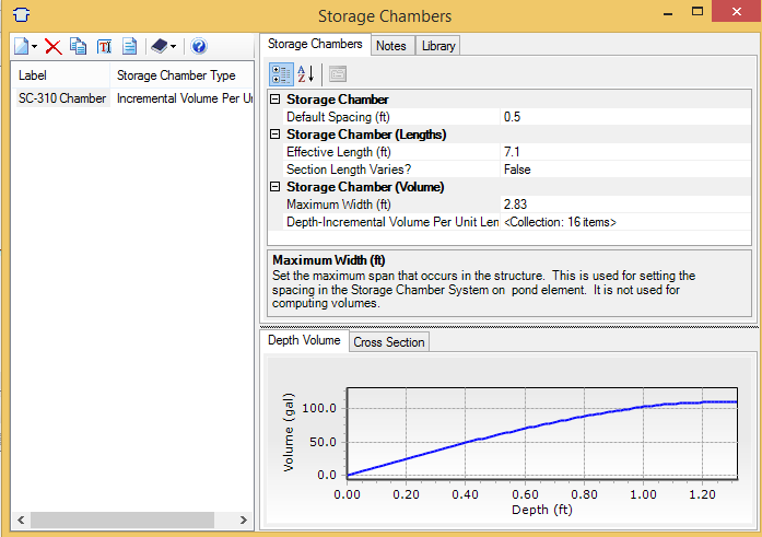

Storage Chambers
SS4 can now model underground storage chamber systems with new component added Storage chamber as the pond type. Storage chambers have been added to SS4 as an option to the pond volume calculation. Now users can construct complex arrays of storage chambers which can be combined with other standard pond components to create a single storage entity to be used in the routing analysis. These can be accessed from the Components menu or from the properties of the pond.
To know more about Storage Chambers please see the support solution below.
http://communities.bentley.com/products/hydraulics___hydrology/w/hydraulics_and_hydrology__wiki/4583.entering-underground-storage-chamber-information-tn.aspx

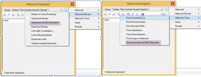

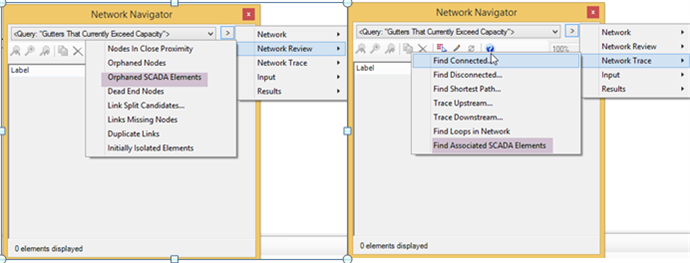

Enhancements in Network Navigator
New queries have been added to Network Navigator like orphaned SCADA elements & associated SCADA elements, in accordance with the new tool added SCADAConnect.

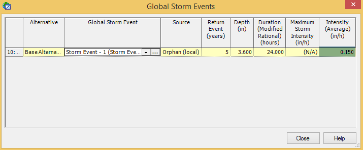

Global Storm Events
New field has been added to global storm events as average intensity. Wherein you can see the average intensity of selected storm event. It’s applicable for Time-Depth (cumulative and incremental) and Time-Intensity storm data.

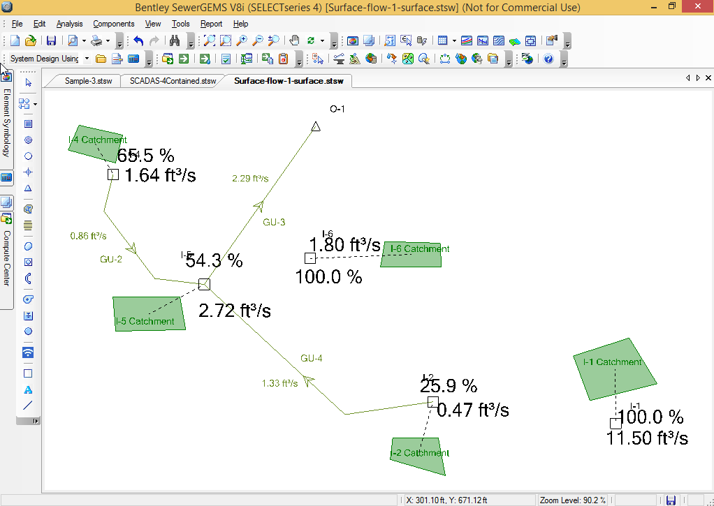

Inlet-only hydraulic calculations
Users can now place inlets, check gutter and inlet carryover flows, and adjusts the inlet positions as necessary, before designing the pipe network. Which may be useful for doing the road drainage design before designing the subsurface piping. In earlier versions, in order to calculate the inlet capacities conduits needed to be placed, but with release inlet capacities can be calculated as can be seen in the snapshot below. This feature is only available for GVF-Rational solver.

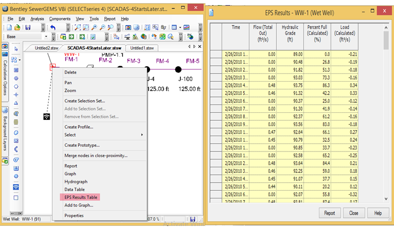

Sparkline in Flex Tables
A new feature is added to the Flex Table allowing users to view Extended Period Simulation result for that element at a glance. This feature is a context menu option which can turn a results column to a Sparkline column that shows the graph of the result values over time. This feature provides a visual representation of the element results.
EPS Results Table
With the addition of this new field, Extended Period Simulation results can be seen for each element separately. It’s available only for EPS run in GVF Convex solver. In early versions, you had to go to Time Browser to see the EPS results. This new enhancement simplifies the results which can be viewed in a single table for all the elements.
