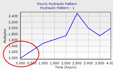

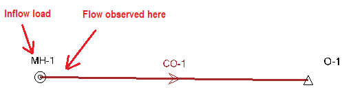

When using the Implicit Dynamic solver in SewerGEMS or CivilStorm, the flow in a conduit at the start of the simulation is lower than expected, for example when compared to the multipliers used in a pattern load.
Expected pattern from inflow load:

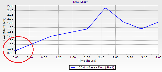

Resulting observed conduit flow, with decreased flow at simulation start:
This is likely due to attenuation effects as the initially dry pipe fills with water at the start of the simulation. (by default pipes are assumed to be dry at the start of the simulation)  So, the correct amount of water volume is entering the pipe, but the hydrograph is attenuated due to the storage space and travel time in the pipe. You may find this effect more pronounced for certain pipe and structure diameters and slopes.

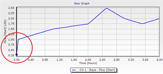

The Start Type calculation option could be used in this case to adjust the assumptions that the numerical solver makes, for the initial hydraulics. See more about that here: Transition Start vs. Warm Start for the Implicit solver calculation options
Warm Start used:
