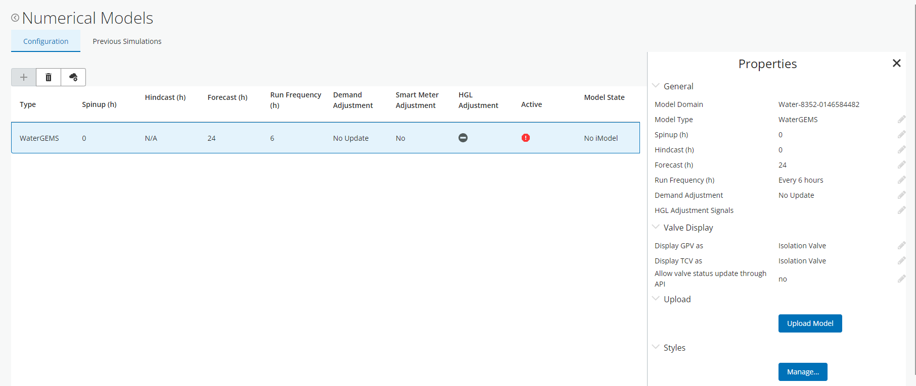

In the Numerical Models Administration page the user can:
This configuration page is used to upload the hydraulic models and set the options for the automated real time simulation.
WaterSight supports up to 10 different and independent WaterGEMS models per digital twin. To add a new model press the add button located on the top and a new row will be created to define the model properties. To add a second model press on the add button again and a second row will be created to define the properties of the second model (and so on). In case the utility has one single hydraulic model for the entire system only one model should be uploaded and considered. In case the utility manages the system through different hydraulic models, each one for example representing different sectors or zones of the system, than all those different models should be uploaded.
One of the advantages of WaterSight is that it can automatically and continuously feed the hydraulic model boundary conditions with real time measurements from sensors (such as real time measured tank levels, real time measured pump status, real time measured PRV settings, etc) and also with real demand patterns, turning the traditional static hydraulic model into a much more accurate real time hydraulic model of the water system. More information can be found here.
The uploaded WaterGEMS model will automatically run in WaterSight, at a given frequency defined by the user and also considering the hindcast and forecast period defined (more detail below). If the WaterGEMS model contains more than one scenario, only the active scenario will be considered in WaterSight.

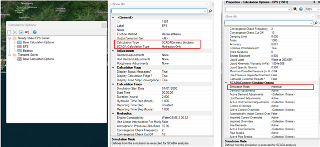

In order to successfully run the hydraulic model in WaterSight, the user should first check if the EPS model is successfully running in WaterGEMS. In case there are errors, the user should first correct them using WaterGEMS. To take full advantage of WaterSight capabilities, the user should check if the WaterGEMS hydraulic model is updated with all relevant network elements (all linear and vertical assets). Some tips below:
customer meter elements should be updated in the model and, ideally, the billing ID field in the model matches the ID provided in the Customer Meter and Billing configuration files (customers will be used in the Pipe Break, Fire Event and Pump Shutdown workflow),
isolation valves should be updated (will be used in the Pipe Break and valve operations workflow). The user can use TCV, GPV or isolation valves types in WaterGEMS to represent the operating valves in WaterSight;
SCADA elements are created and mapped to the respective model elements (this is important to assure that model boundary conditions are being fed by real sensors measurements. Both name of the SCADA signals and units need to match those defined in WaterSight. More information here),
when using the automatic demand adjustment option of WaterSight (see below for more information) it is required that the zones name in the WaterGEMS hydraulic model are associated to the nodes and match the names given to the zones in WaterSight.
tank definition in the model must match the SCADA type. If the SCADA signal is Level, the tank "Operating range type" should be defined by Level. If HGL, then tank Operating range type" should be defined by Elevation.

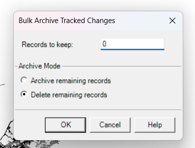

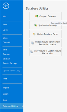

to increase model performance in WaterSight, please make sure to:
delete all track changes from the WaterGEMS model. To delete track changes go to the review tab in WaterGEMS >> select Bulk Archive >> delete records (see image below). After that, please make sure to compact database, by acceding to File >> Database utilities >> Compact Database. At the end, make sure to save the file. This workflow can significantly reduce the size of the SQLite file in case the utility is using the track change functionality quite often.
| Fig 1 - Delete track changes in the WaterGEMS model | Fig 2 - Compact Database in WaterGEMS |

Figure 1 - Updating calculation options in the WaterGEMS prior uploading into WaterSight.
SCADA or other telemetry data can be used to set the initial conditions for the model run when they are correctly configured in the uploaded WaterGEMS model. More information here.

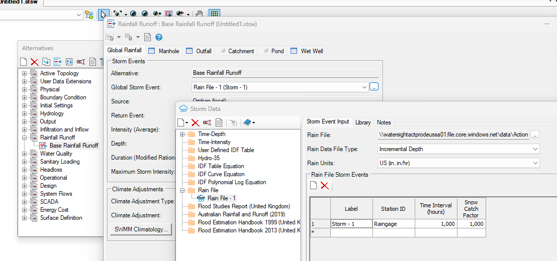

WaterSight can also support the upload of a Sewer Model from SewerGEMS. For that, it is required first to create a digital twin which type is water collection.
The required settings to upload a sewer model in WaterSight are the following:
In SewerGEMS (SWMM Solver) it is possible to connect junction and storage nodes such as Manholes, CSs, inlets, Wetwells, Ponds to import Initial Depth values. It also can import values of Initial Flow for Gravity Conduits/Channels, and Pump's Status, Relative Speed Factor. It's important to notice that values on Pollutant/Contaminant concentration from Sensors are not imported as initial conditions by default on SewerGEMS. Once configured in SewerGEMS (SCADA elements are created and associated with the model element), those can be supported in WaterSight.

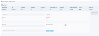

Click in the "Add" button (+) located on top to add a new hydraulic model.
Tips: Only one hydraulic model file is supported by digital twin however it is possible to aggregate several model files into one using the import submodel feature available in WaterGEMS. More information above, under General tips. To upload a new model file, it is strongly suggested to upload a ZIP extension (just including the sqlite extension) and to turn off and delete track changes

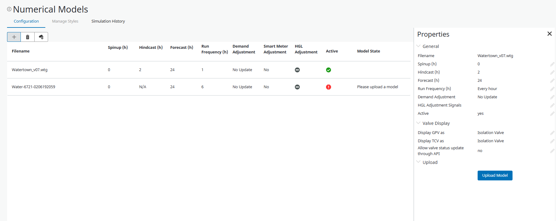

Once clicking "Add", a new row in the table will appear and the user can now upload and edit the configurations of the new model. For that, make sure to click on the row and edit the right side panel that will appear.
To add a second or third model click again on the "Add" (+) button located on top and another row will be added to define the properties of the second or third model (up to a limit of 10 models per DT).
Click in the row and then click in the delete button to delete the entire hydraulic model. A new hydraulic model can then be uploaded again.
Note: It is also possible to reupload a new model without needing to delete the previous one - ideal workflow once the user wants to update a more recent model. For reupload of a new model just click on the first row and then in the right side panel press the upload Model button and upload the latest model.

Name of the uploaded WaterGEMS file.
Time period at the start of a model run where the results are considered unstable and are not displayed. This is particularly important for model runs where initial inertia is important. For water supply models spinup this can be relevant when simulating water quality. In most cases this value can be set to 0, as consecutive model runs use previous results to update initial settings.
The Hindcast is a time period of time leading up to the current time where past model calculated results can be compared with historical sensor values. A hindcast period of 12-24 hours is useful for calibrating and validating a near-realtime hydraulic model, as well as in giving context to current and forecast conditions. If the model is configured with Control Overrides from SCADA sensors, a hindcast period can have accurate behavior of pump and valve setpoints even if logical controls have not been fully defined in the model.
The time period into the future, starting from the current time, for which model results will be calculated. Note that the forecast period cannot take advantage of SCADA Control Overrides, so controls must be defined in the model which appropriately mimic both automated setpoints and typical manual adjustments to pump and valve operations. When first developing a near-realtime hydraulic model, it is often best to focus first on calibrating an accurate hindcast, and then refine controls to improve the forecast.
Results of each model run are automatically saved in the Previous Simulations page.
Define the automatic run frequency of the model. For example if 1 hour is defined, this means that the model will automatically run every hour.
