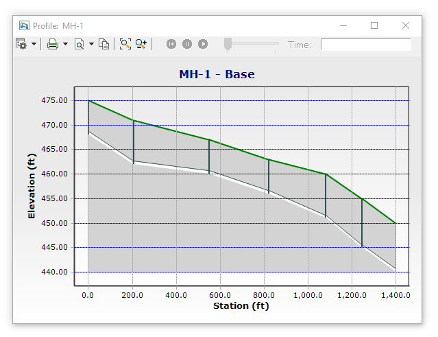

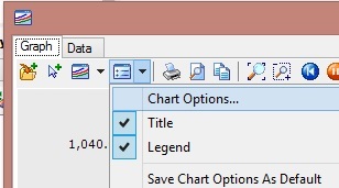

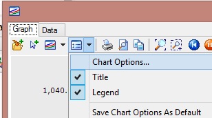

To access the Chart Options function, create or open a graph or profile. Then click the Options button and choose Chart Options.

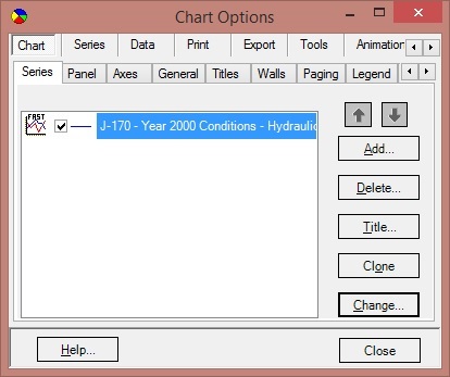

In the Chart Option dialog, you can see all of the available options. Most of what you will do to the appearance of the graph or profile will be from the Chart tab located in the upper left of the Chart Options dialog. (Note: There is a known issue in OpenFlows Sewer version 24.00.03.23, impacting SewerGEMS and SewerCAD, where the language displayed is in Japanese. To resolve this, download version 24.00.03.27 or later from the the Software Downloads page.)

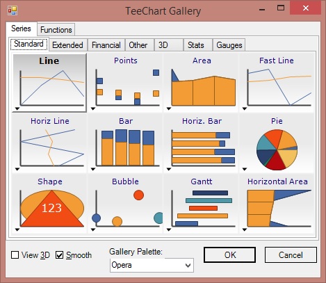

From here, you can change appearance of the data, the appearance of the graph or profile, and some of the information for the axes. As an example, if you wanted to change the way the lines in the graph look, you can select the Series tab (as shown above) and click the Change button. This will open the dialog below and allow you to change the graph or profile appearance.
Note that Chart Options is currently a third-party program and not all features are currently available. Some the options above are available though. Select the option you want and click OK. When you click okay again to close out of Chart Options, the graph or profile appearance will change. These general steps are the same for other options in Chart Options as well.

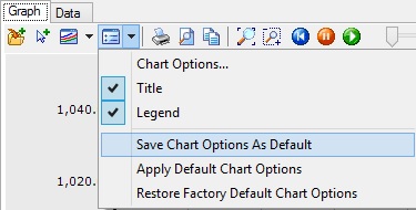

This will save the appearance of the graph or profile when it is open, but other graphs and profiles will not use the same formatting. To make it so other graphs/profiles use the same formatting, click the Options button and choose Save Chart Options As Default. This will save the current chart options settings as the default for future graphs/profiles. NOTE: this is currently not available in SewerGEMS, SewerCAD, CivilStorm or SewerGEMS as of version 10.02.02.04 (reference)

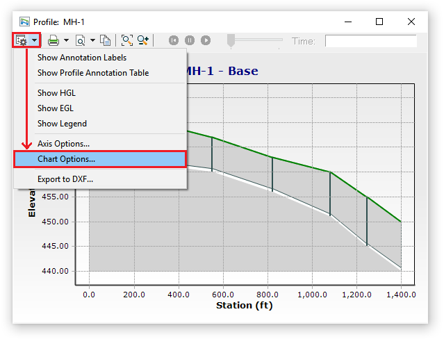

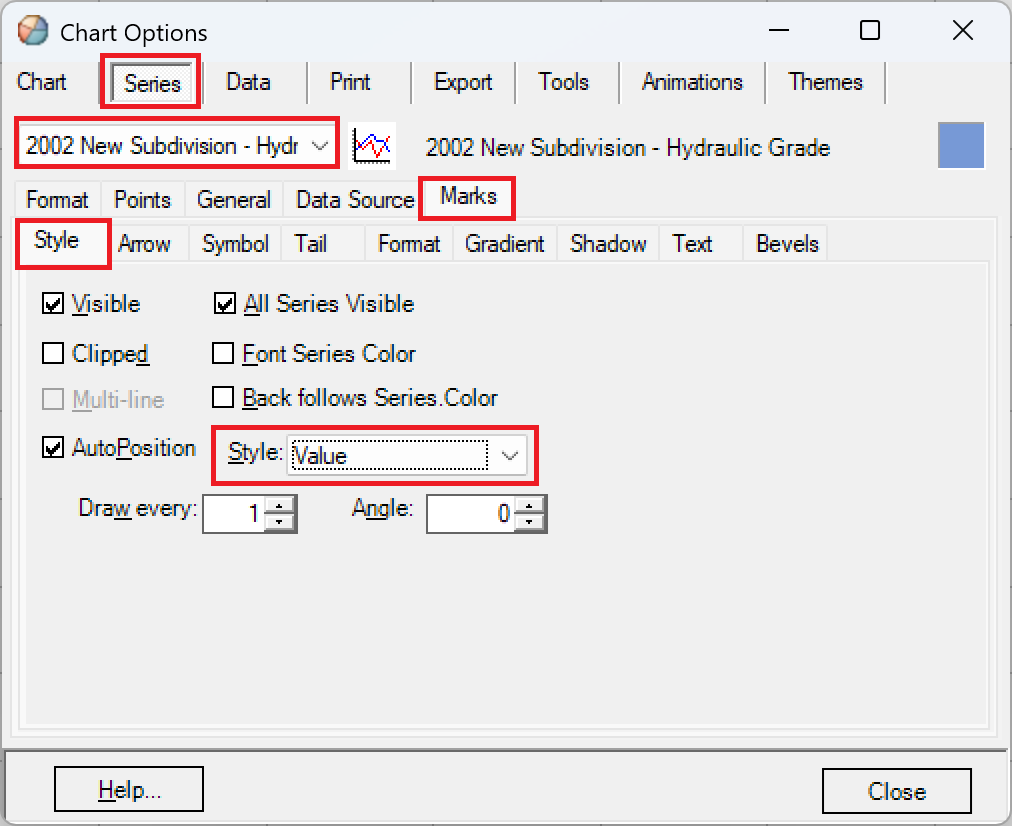

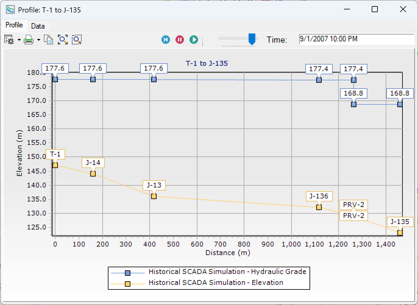

How to show values instead of labels (WaterCAD and WaterGEMS profiles)
With the profile open, click the gear icon in the upper-left corner, choose Chart Options, then navigate to Series > (pick the series like HGL) > click the Marks sub-tab and choose "value" or "Label and value" from the "style" dropdown:

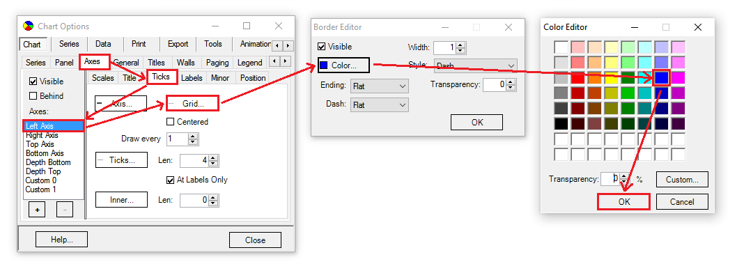

How to Customize the Grid Color
1. Go to Chart Options > Axes > Ticks
2. Select the Left Axis (from the left pane) > Grid > Color > Select new color > OK.
3. Close the Chart Options dialog and the graph/profile will update with the change.

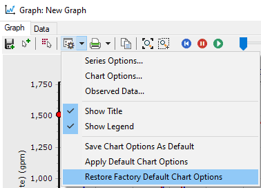

How to reset the graph and profile settings to default
If you have made changes to the chart options and wish to restore the defaults, you can do this using the gear icon at the top - choose "Restore factory default chart options".
