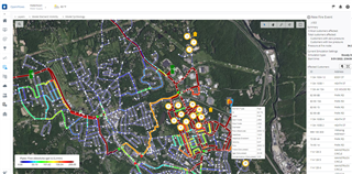

Map view
Map automatically zoomed to the location of the event, highlighting all customers affected by the fire event, as well as flow location. Customers are represented with the following colors:
- Red customers: customers with no pressure (no supply) due to the event (see more information below)
- Yellow customers: customers with low pressure due to the event (to be able to identify low pressure customers, please make sure a minimum pressure threshold is defined in the digital twin settings, under the service expectations tab. See below for more information on how they are considered)
In the identification of the affected customers all those that always have low pressure or no pressure even without the event (no pressure or low pressure chronical customers) are ignored.
User can click in any element in the map to see the results for a specifc element. Graph result will only be available if the event simulation run is Extended Period type, please see below for more information.
Using the map controls, the user can also analyze several hydraulic parameters, such as pressure, flow, velocities, etc.

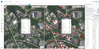

Side-by side view:
Syde by side view will only be available for emergency events that were created in the last 7 days. If side-by-side view option is on, it will be possible to easily compare the baseline scenario (with no event) with the event scenario. User can click in any element in the map to see the results for a specifc element and compare pre and post event conditions. Graph result will only be available if the event simulation run is Extended Period type, please see below for more information.
Summary
Statistics about the simulated fire event:
- Number of critical Customers affected
- Total number of Customers affected, including zero pressure and low pressure
- Pressure at the fire node
Affected Customers
Customers Without Water
Customers that in the baseline scenario (with no event) had pressure and during the event scenario end up with no pressure, during at least one time step of the all simulation period.
Low Pressure Customers
Customers with low pressure:
- All customers that in the baseline scenario (with no event) were above the minimum pressure threshold (defined in the administration, under the service expectations tab) and during the event scenario end up with pressure below the minimum pressure threshold, during at least one time step of the all simulation period
- All customers that were already below the minimum pressure in the baseline scenario (no event) but had a pressure decrease greater than 30% with the event, during at least one time step of the all simulation period
Examples: Low pressure threshold: 50psi
Case 1: Without event 70, With event 60 -> do NOT highlight (good conditions)
Case 2: Without event 70, With event 40 -> highlight (it passed the threshold)
Case 3: Without event 51, With event 49 -> highlight (it passed the threshold)
Case 4: Without event 49, With event 48 -> do NOT highlight (it was already low and variation less then 15%)
Case 5: Without event 49, With event 35 -> do highlight (it was already low but a variation greater then 15%)
- Time-steps related to unbalanced time steps are now ignored when calculating affecting customers
Critical Customers Affected
Number of critical customers with zero pressure or low pressure during the simulated event. The information about critical customers need to be previously provided by the user and filled in the configuration template used to import customers information, in the digital twin administration.
