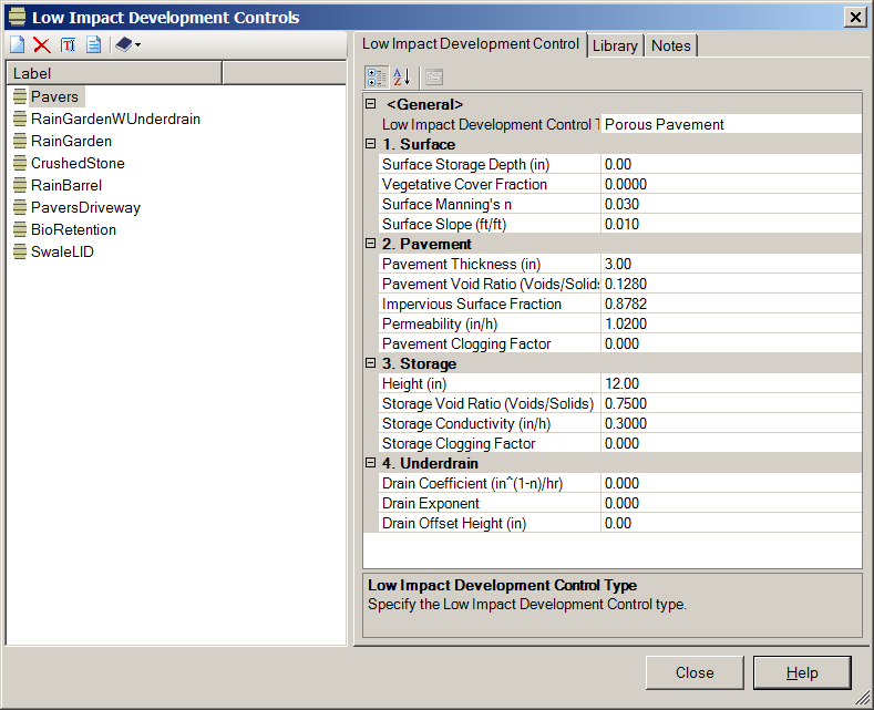

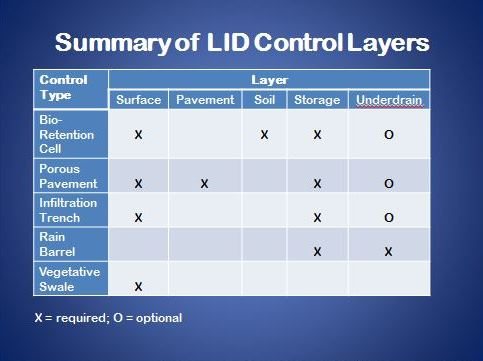

LID control is represented by a combination of vertical layers, which may include (in top to bottom order):
In the Low Impact Development Controls dialog, the input parameters will be filtered based on the input. In other words, If you add a Rain Barrel LID Control, pavement parameters will not be displayed. As shown in the table above, underdrain parameters are optional for some LID control types.

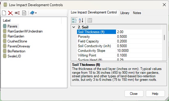

You can find some additional information on the properties available for different LID controls. Note: A description of the properties, and in some cases information on what values to enter, can be found by highlighting the property in the LID Controls manager. Below is an example of this for Soil Thickness:
Controls are defined in the LID Controls editor:
The model performs a moisture balance:
In a project, you would go to Components > Common > Runoff > Low Impact Development Controls. You can also use the Ribbon search to access this. The Low Impact Development Controls manager is where you would enter the different LID Controls for the project. After these are set up, you can export them to the Engineering Libraries for use in other projects.
Note: The underdrain is only required on a rain barrel control. If using a rain barrel, you will notice that it has a Drain Delay. The drain delay is the number of dry weather hours that must elapse before the drain line in a rain barrel is opened (the line is assumed to be closed once rainfall begins).

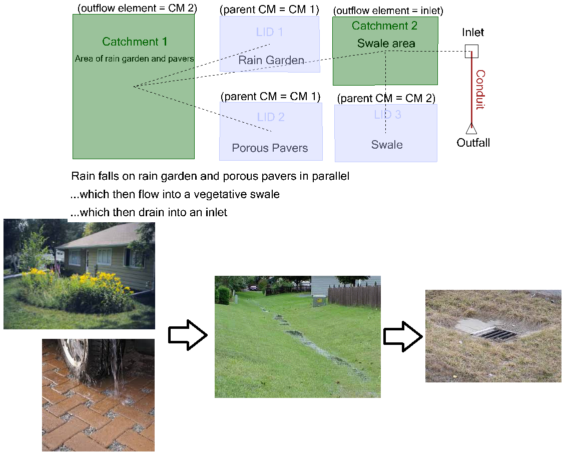

After entering the Low Impact Development (LID) Controls, you will add the catchments and LID elements to the network.
Note:
When you add the LID element to the model, it will be associated with a catchment. Typically you would add the LID element directly on top of the catchment.
What this might look like in an actual model:

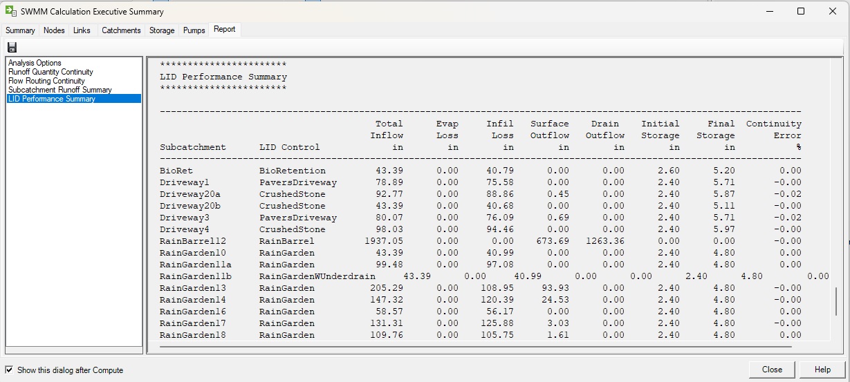

Mass balance in Text report
The SWMM Calculation Summary includes LID results. This is available after computing the model or by going to Home > Summary or Analysis > Summary. In the Summary tab, there are mass balance results, which will include information on LID.
More detailed information can be found in the Report tab of the SWMM Calculation Summary, in the "LID Performance Summary" section (see below), including inflow and outflow data.
Note: The values in the LID Performance Summary are expressed as depths (inches or mm) over the specific footprint area of the LID control itself. Meaning, they are not straight volume units like acre-inches, but are actually the depth (in inches) of water if it were spread evenly over the LID's footprint area. So, the same volume entering a smaller LID area will result in a large depth value in inches. You can determine the volume by multiplying the inches (or mm) figure by the LID area, enabling you to compare the actual volume to other LIDs, for example.

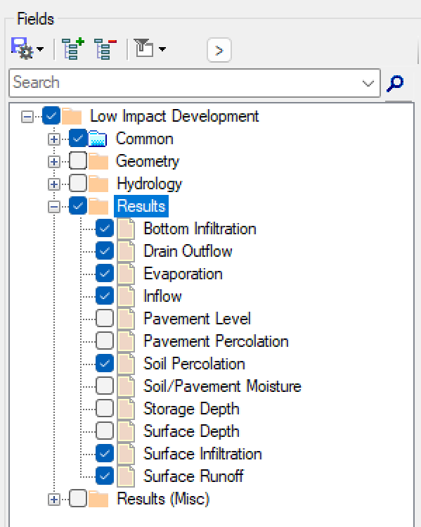

Time series results from the LID element
In the "Output Options" field in the LID element properties, you can choose between Summary Results and Detailed Results.
If you are using the Detailed Results option, you could also graph results from the LID element. Note that these results may show as "N/A" for the first timestep (time zero) - ensure that the Output Increment is set equal to the Hydrologic Increment (in the Calculation Options) and set to an even value such as 0.05 hours (re-compute the model if a change was needed), then graph the results of interest:

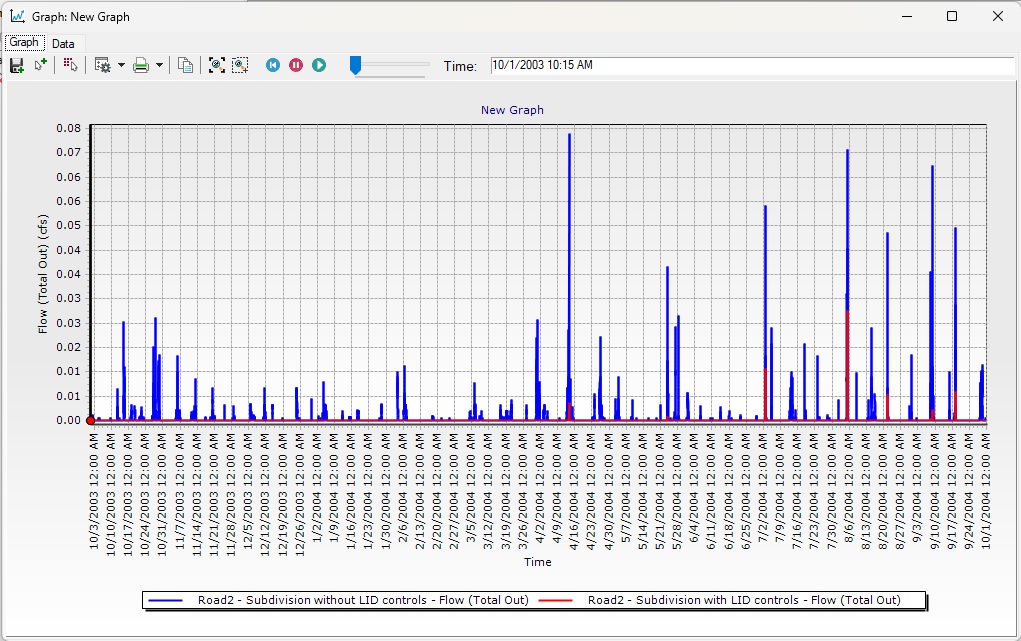

From parent catchment
Time series results can be viewed by graphing the parent catchment for the LID. The following is a screenshot of the runoff from a catchment without LID and one with a porous pavement LID:
Note: the "Infiltration" volume will be zero for a green roof that occupies the full catchment, as the rainfall in that case can either becomes runoff, is stored inside the LID or exits via an underdrain.
