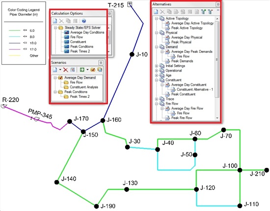

In this example, the Submodel and Target Model have no elements in common (i.e., scenarios, alternatives, calculation options, and network elements do not match).

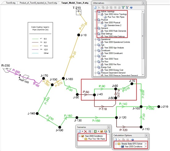

Town 'A' (The Target Model)
In the model illustration below, take notice of the labels for the elements outlined in red:
Alternatives e.g., "Year 2000 Active Topology" "Plus Two 18in Pipes," "Diameter times 2")
Scenarios (e.g., "Year 2000 Conditions," "Plus Two 18in Pipes")
Calculation Options (e.g., "Year 2000 Conditions")
Network Elements (e.g., Pipes P-90 and P-60, Junctions J-50 and J-40, Pumps, Reservoirs, Tanks, etc.)

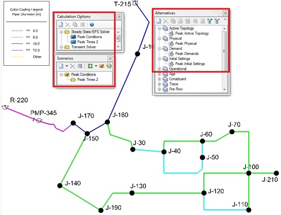

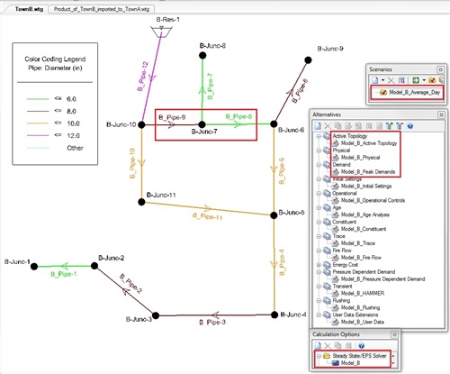

Town 'B' (The Submodel)
In the model illustration below, take notice of the labels for the items outlined in red:
Alternatives (e.g., "Model_B_Active Topology")
Scenarios (e.g., "Model_B_Average_Day")
Calculation Options (e.g., "Model_B")
Network Elements (e.g., Pipes B_Pipe-9 and B_Pipe-11, Junctions B_Junc-7 and B_Junc-6, Pumps, Reservoirs, Tanks, etc.)

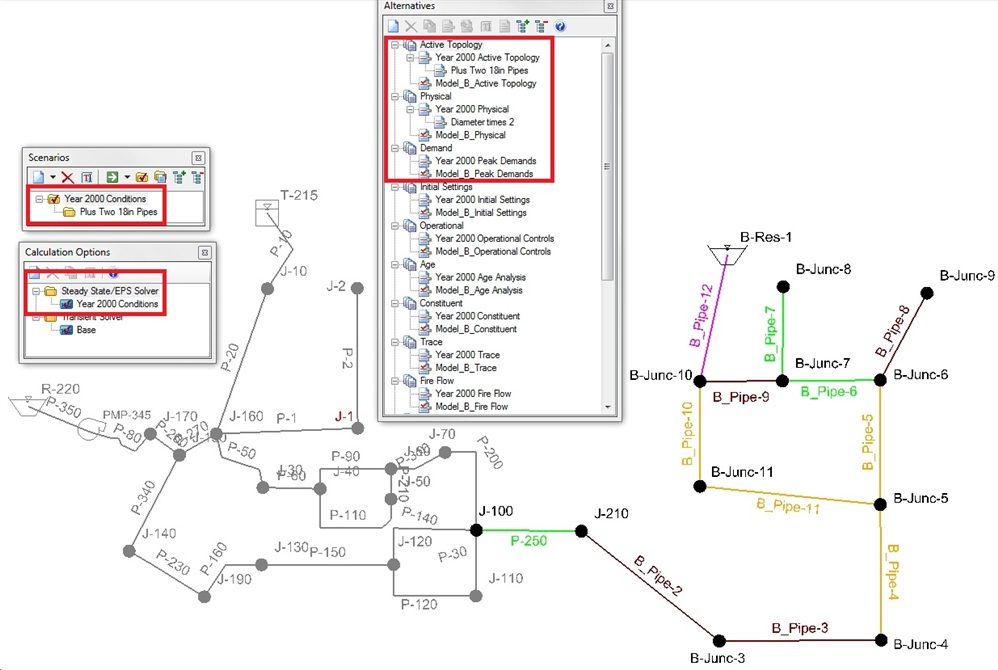

Result of Importing Submodel into Target Model
In the illustration below, the target model network elements are visible on the left, and the imported submodel network elements are outlined in red on the right. Since the target model elements have no label names in common with the submodel elements, all of the submodel elements will be created the target model, according to rule 3 above. None of the data in the target model will be overwritten in this case, since there were no matching labels.
Observe how the scenarios, alternatives, calculation options, and element labels for all the submodel items have been brought into the target model (see red outlined areas). For example, for the Active Topology alternatives, all of the submodel's (Town 'B') network elements have come in as inactive for the original "Year 2000 Active Topology." The reason is because the newly imported elements did not previously exist in that alternative, so the default attributes are used. In the case of active topology, the default is inactive. So, the newly imported elements are inactive in the "Year 2000 Active Topology" alternative. In the case of the physical alternative, if the submodel's physical alternatives don't match the target model's, the default physical attributes will be used for the newly imported elements, for the physical alternatives that already existed in the target model. So in this example, since the physical alternative in the submodel ("Model_B_Physical") doesn't exist in the target model, it was brought in as a new alternative. So, the pipes from the submodel in the scenarios that use the "Year 2000 Physical" will have 6" diameters and junctions will have zero elevations and so forth. In order to see the original attributes of the submodel elements, the scenario would need to use the "Model_B_Physical" physical alternative.

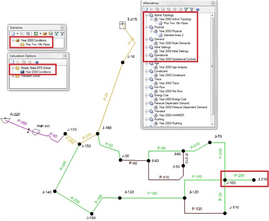

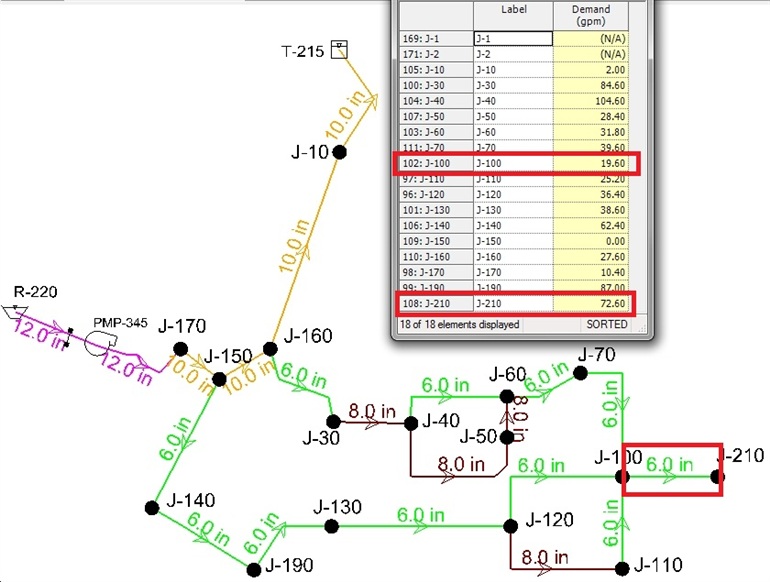

Alternatives (e.g., "Year 2000 Active Topology" "Plus Two 18in Pipes," "Diameter times 2")
Network Elements (eg., Pipe "P-250" and Junctions "J-100" , "J-210")

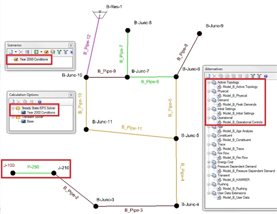

Alternatives (e.g., "Model_B_Active_Topology")
Scenarios (e.g., "Year 2000 Conditions")

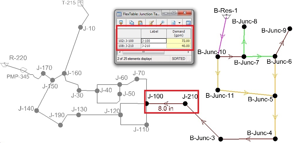

 In this model below we have connected the submodel (right) network to the target model network (left) at junctions J-100, J-210, and pipe P-250 (center). This connection occurs because both models shared some of the same junction and pipe labels as import rule 2 states. The submodel data is therefore going to overwrite the existing target model data in any items governed by the rules that are common to both models (illustrated below).  You can see that for both the submodel and target model there is also a common scenario name. If any of the properties for this scenario were different the submodel properties for this scenario would overwrite the properties for the target model. Above we see the target model network has all become inactive except for the junctions and the pipe that are shared by both models. This happens because the submodel data is overwriting the scenario data for the 'Year 2000 Conditions' scenario (import rule 2).
In the illustration below, Town 'A' Demands and Pipe Diameter before the import are outlined in red
Junction Demands Pipe P-250 Diameter
J-100 = 19.60 gpm 6 inches
J-210 = 72.60 gpm
In the illustration below, Town 'B' demands and pipe diameter before the import are outlined in red
J-100 = 72.0 gpm 8 inches
J-210 = 40.0 gpm
In the illustration below, pipe size and junction demands after the import are outlined in red
J-210 = 40.0 gpm

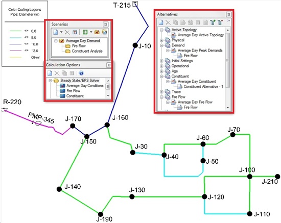

 In this example, the submodel and target model share all of the same network elements but, none of the same scenarios, calculation options, or alternatives.
Scenarios Calculations Options Alternatives
Average Day Demand Average Day Conditions Average Day <Alternative Type>
Fire Flow Fire Flow Fire Flow
Constituent Analysis Constituent Constituent Alternative - 1

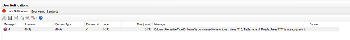

NOTE :
When importing submodels if both the submodels have UDX i.e. user data extensions defined for the same elements e.g. outfall has UDX defined in both submodels that you are importing, then an error is seen like:
Or
"Column 'AlternativeTypeID, Name' is constrained to be unique.  Value '100, Outfall_Field_13292' is already present."
The workaround is to remove the UDX from submodels, copy and paste that data in excel format and use Modelbuilder to import that UDX data. Once UDX data is removed from common elements you should be able to combine the submodels. We have filed a defect for this as of 10.03.XX.XX version, reference number is 306679 and we are working on it to get it resolved in future release of the products.
