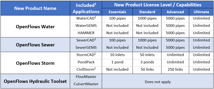

As of July 1st, 2024, OpenFlows product licenses have been consolidated, for simplification. Please see the following link for more information:
OpenFlows Product Licensing and Feature Levels (New for 2024)

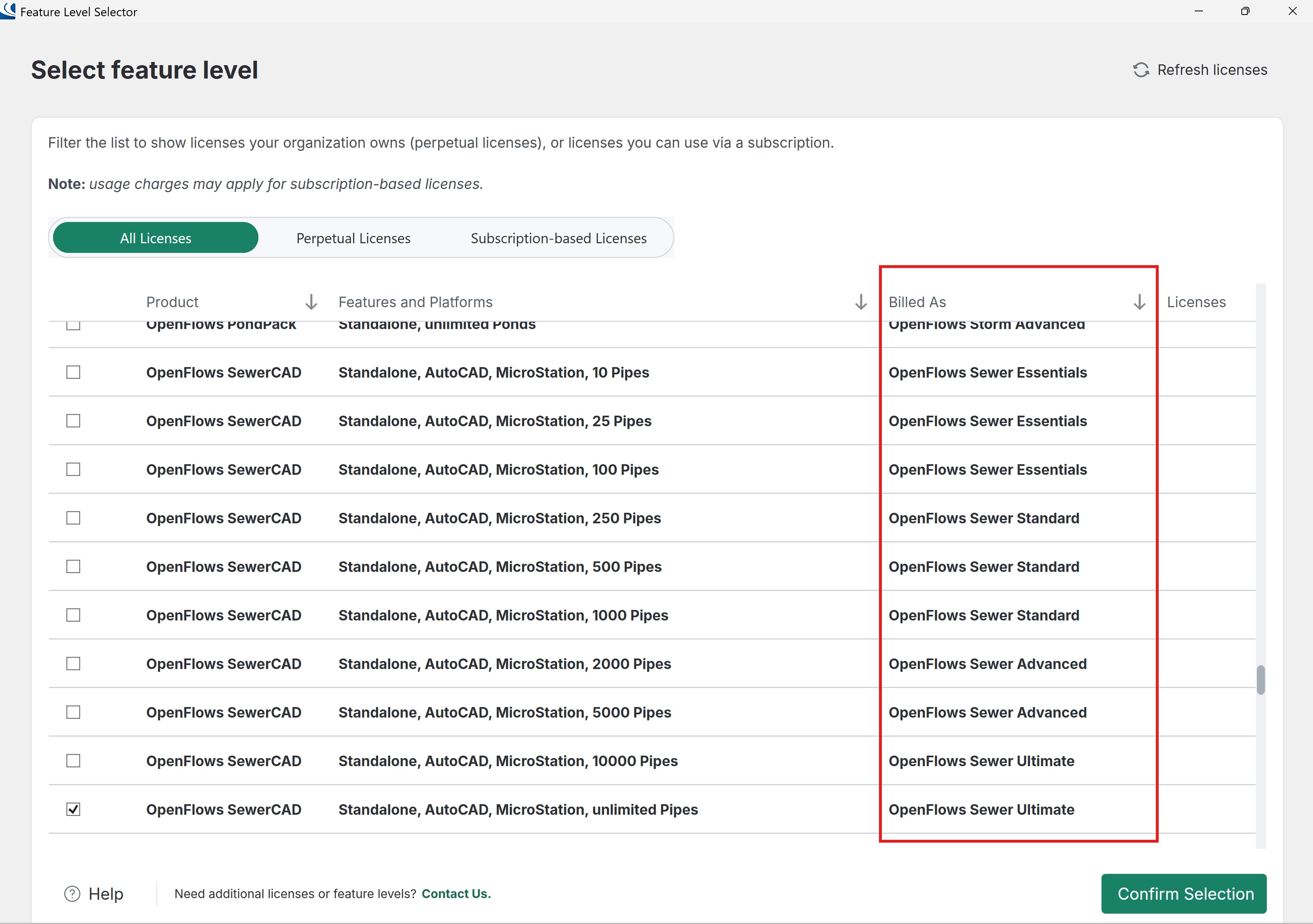

As noted in the above article, the installation files include a suite of applications. For example, OpenFlows Water includes WaterGEMS, WaterCAD, and HAMMER; OpenFlows Sewer includes SewerGEMS and SewerCAD; OpenFlows Storm includes StormCAD and CivilStorm; and OpenFlows Hydraulic Toolset includes FlowMaster and CulvertMaster. How the applications are installed will depend on what you are licensed to use. The section called "OpenFlows 24.00.01.05 and higher Product Installation" in the link above has details on this workflow.
This will not have a significant impact on the license activation through the Feature Level Selector. You will still select the feature level that you own in the Feature Level Selector to activate the license. The chart in the article above, and in the FAQs linked to from the bottom of the next article, explain which feature levels are granted for each tier of the new products. You will also see a "Billed As" column in the Feature Level Selector (Bentley Licensing Tool > Change Feature Level)  to clarify which license tier the respective feature level will bill as:

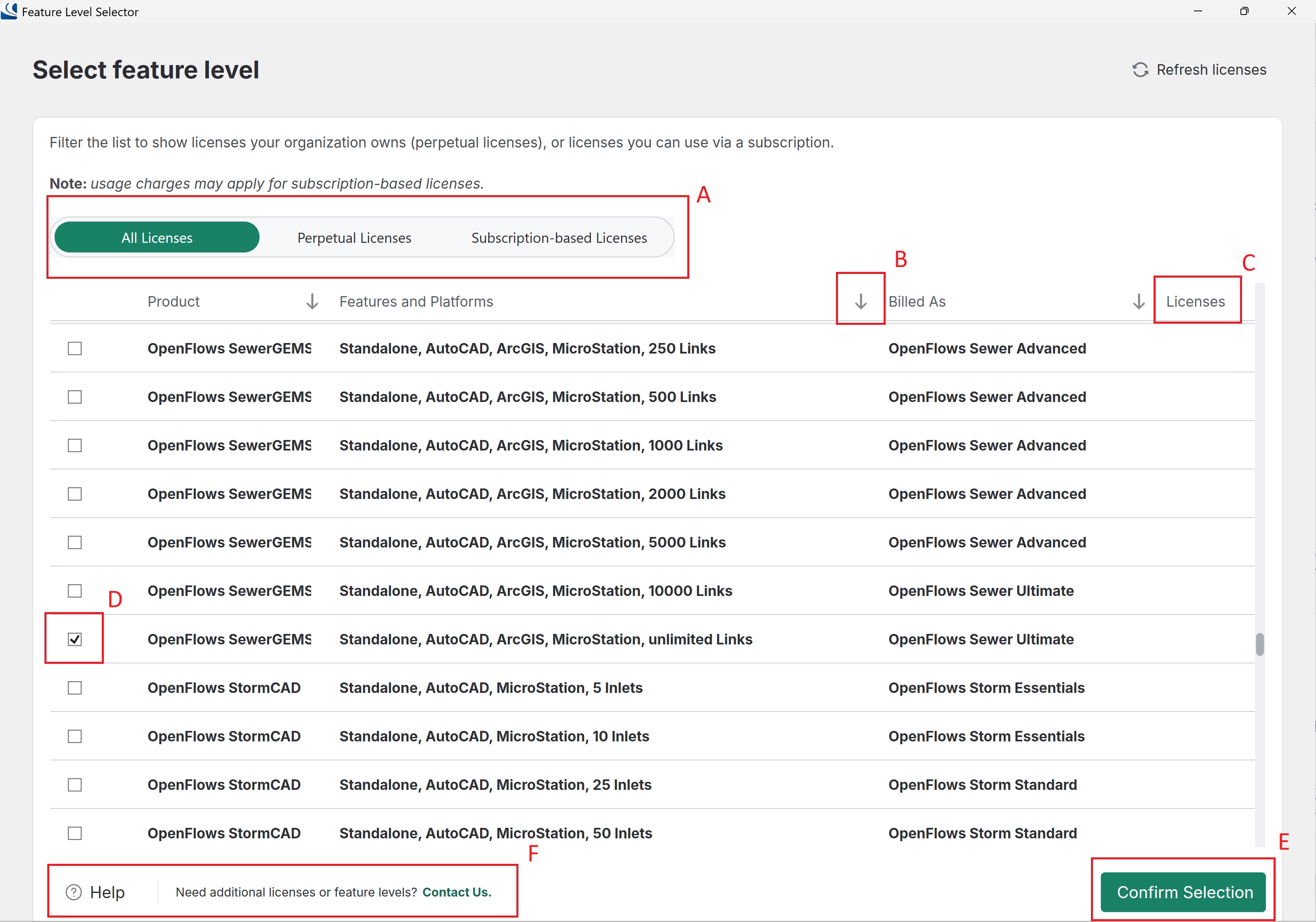

If you own multiple feature levels of the product (for example from OpenFlows Water Standard and OpenFlows Water Advanced), or if you do not own any, but have feature levels available to you from your subscription (ex: SELECT OpenAccess, ELS, E365 or a Practitioner license), the Feature Level Selector will appear when first opening the product: Click the "Select" button next to the feature level that you would like to use, then click the Done button to open the product.
Highlights of the Feature Level Selector
Components
A - Enables you to filter the type of feature levels displayed in the table.
B - You can sort the list of license feature levels if needed. When opening the Feature Level Selector from within the License Tool, a Product column will also be displayed, with a sort available.
C - The "Licenses" column indicates the number of perpetual licenses owned of a respective feature level.
D - Click the check mark button to select a feature level that you want to use.
E - Once you have selected a feature level, the "Confirm Selection" button becomes available, as the final step of the process. When clicked, the Feature Level Selector will close.
F - The "contact us" button directs you to the form to request more licenses (for example if you need to purchase a license or subscription to gain access to a higher feature level. The "Help" button links to the following article for general help: Licensing OpenFlows products - Subscription Entitlement Service (CONNECT Licensing)

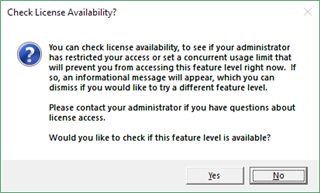

License Availability Check (General Access and Concurrent Use Threshold Alerts)
When choosing to "Select" a feature level in the Feature Level Selector ('D' above), you may be prompted if you would like to check if the feature level is available. Choose "Yes" to check if your license administrator has restricted your permissions ("General Access" settings), or if a threshold was set (concurrent use threshold alerts) and all licenses are currently in use (these are configured in Entitlement Management.) This check should only take a few additional seconds, and gives you the opportunity to select another feature level if needed (since the Feature Level Selector will still be open.) Otherwise if the license is not available, you would need to re-open the Feature Level Selector (see "Changing the Feature Level" below) in order to choose another feature level.
Note: this prompt will not appear if you have accessed the Feature Level Selector from within the Bentley Licensing Tool (separate tool/shortcut)
An "Access Denied" message box indicates that your administrator has restricted your access to this particular feature level (but not necessarily other feature levels for the product you are trying to use). Dismiss this message box to return to the Feature Level Selector, to select another feature level for that product, if available. Contact your license Administrator (typically in your IT or Helpdesk) if you believe that you should have access.
A "License Information" message box that indicates that your license administrator has set a threshold on the number of concurrent usages of that particular feature level, and all licenses are currently in use by other users. This often means that if you continue and open the product, your organization will incur usage charges. This may be acceptable during times when multiple users need to be working in the software, in which case you can click the "acknowledge" button. This records the event and may alert the license administrator to your choice. When this appears during the availability check in the Feature Level Selector (see above), "acknowledge" results in the feature level being selected, after which you can click "Done" and open the product. You may encounter a second instance of this dialog box when doing so.

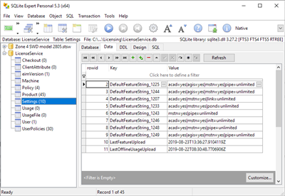

However if you have a need to check what the feature level is from some type of monitoring system, without opening the product or the feature level selector itself, you can do so by looking at the license database file where the feature level setting is stored.
  1. Install a SQLITE browsing application such as SQLITE Expert Personal
  2. On the Windows user profile in question, navigate to C:\Users\<username>\AppData\Local\Bentley\Licensing\
  3. Locate the file named LicenseService.db and open it in your SQLITE viewing application.
  4. Open the table named "Settings" - this will show one row for each product that has a feature level set, with the corresponding feature string. Note that modifying this table is not supported by Bentley.
The four-digit number at the end of the "Key" field determines the product, as shown in the table below.
What are the standard feature levels?
Starting July 1st, 2024, the license features have been simplified. See the following table for the license features for the different suite of applications.
The following are the possible feature levels currently available for OpenFlows products prior to this consolidation. If you have an ELS or SELECT OpenAccess subscription, you may see all of these possible feature levels (check with your Site Administrator if you are unsure which one to select)
