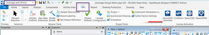

OpenFlows license management within the Civil products.
Note: for a video demonstration, see: Activating Advanced Drainage Capabilities in OpenRoads Designer: Part 1 | Part 2
How to change active OpenFlows license

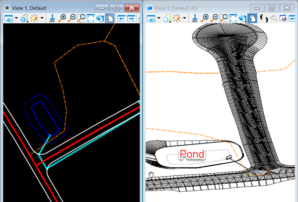

OpenFlows Functionality - how it works in Civil products
With the availability of the Drainage & Utilities tools within your Civil products, you can perform the following things:
Updating a Drainage and Utilities model after changes are made in a storm or storm sewer standalone product
A Storm or Storm Sewer file can be updated in standalone and opened in Subsurface Utilities using the steps below:
1) Open the .DGN file using any of the hydraulics and hydrology Select Series 5 or CONNECT version standalone products.
2) Update and save the file
3) Open the file in one of the Civil products.
4) Go to the Drainage & Utilities workflow > Tools > Synchronize Drawing...  the file should update.
