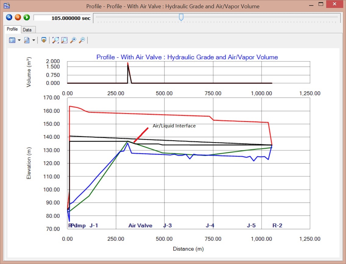

Tracking the air/liquid interface:
There are two ways to observe the air/liquid interface tracking when using the Extended CAV option:
    1. Open the Transient Analysis Output Log under Report > Transient Analysis Reports and scroll down to the section beginning with:
*** SNAPSHOT OF EVERY END POINT AT START OF TIME STEP 2 ***
Below this table, you will find information pertaining to element statuses, including Extended CAV air/liquid interface. For example:
At time step "4341" at CAV "Air Valve" with neighbor "J-3 ", the elevation, level and volume are: 137.000 135.361 0.966
  1. Open the Transient results viewer and animate a report path including the air valve and adjacent pipes. As the pipeline fills with air, you can observe the change in HGL downstream of the air valve. This is the air/liquid interface:
In some cases, the extended CAV model may not be appropriate. For example, if you have a triple acting air valve with transition volume, it may not be appropriate since that is more of an elastic situation. The extended CAV option is typically used when relatively large volumes of air enter the system.
Note: the Extended CAV option will only track air volume up to the extents of the adjacent pipe(s). In the event that the air expands greatly so that the interface moves down towards the neighbor node to the verge of draining, HAMMER issues a warning message, freezes the horizontal surface at the elevation of the neighbor node, and continues to track the volume (which could conceivably exceed the branch's volume).
