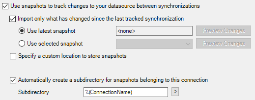

    6. "Specify snapshot settings" step (available in CONNECT Edition Update 1 and greater)
      1. If you had followed the above suggested workflow ("Initial Model Creation from the GIS") - check the box for "Use Snapshots..." and the box for "Import only what has changed...", then select the snapshot from the dropdown (if you stored it in another location, choose "Specify a custom location..." and browse to it). This will enable you to only import things that have changed since the last synchronization. Click the "Preview Changes" button to review details of what has changed, and accept or reject as needed. See more here.
      2. If you did not already establish the initial snapshot - check the box for "Use Snapshots...", to establish a snapshot of the GIS at the time of this synchronization. This will be helpful for future Sync-Ins, so it is more clear to you what has been changed since the last update. You can leave the "use latest snapshot" field blank if this is the initial snapshot.

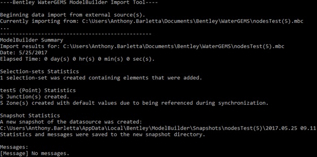

      3. Review the Summary at the end of the ModelBuilder run and check for anything unexpected. You may also want to note the names of junctions that were deleted from the model (see item #5 below)

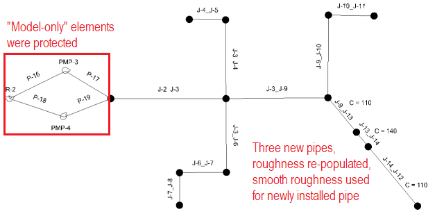

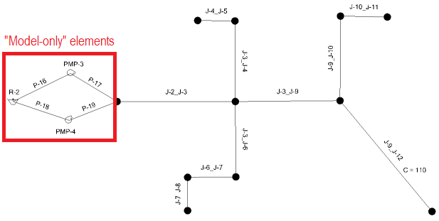

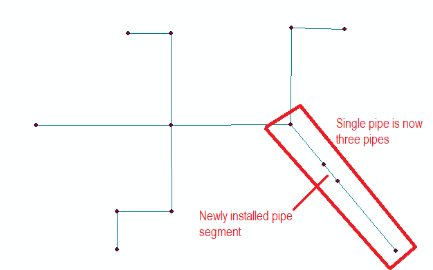

The below example is a case where a single pipe in the hydraulic model is now three pipes in the GIS, because a segment in the middle was replaced due to a pipe break. The hydraulic model also contains some "model-only" elements; a pump station seen on the left side, which does not have a detailed representation in the GIS. In this case, you want to keep the model in sync with the GIS and update it with the changes, but you do not want your pump station to be "touched", and you want to re-establish calibrated roughness for the segments of pipe next to the newly installed segment.
Hydraulic Model:
GIS representation:
Model, after update:
