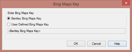

For CONNECT Edition Update 2 and greater, you do not need to obtain your own Bing Maps key from Microsoft and can utilize a special per-product Bentley key, as long as you are signed into the CONNECTION Client.
For CONNECT Edition Update 1, you will need a Microsoft account to generate a Bing Maps key -https://www.bingmapsportal.com/.
Starting with CONNECT Edition Update 2, you can choose to use a built-in Bentley Bing Maps Key, or choose your own user-generated Bing Maps key as before. You would click the ellipsis (...) button in the upper right of the dialog shown above and will have the option to toggle between the two different keys.

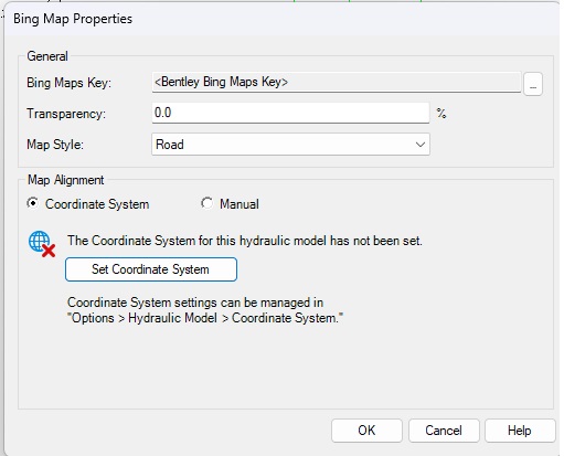

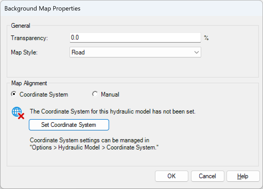

Starting with version 24.00.02.XX, you use coordinate systems to align your model. When you open the Bing Maps background manager, you have an option to Set Coordinate System. If you select this, you will be able to choose the coordinate system for your model. Detailed steps can be found here: Working with coordinate systems in the OpenFlows standalone platform.
You can also set the alignment and projection manually. The Bing Maps feature works off of Web Mercator projections, using the Map Alignment field. The Map Alignment can be used to help transform the background and align with the model. However, this feature doesn't use a true State Plane-like reprojection like you might see in a program like MicroStation or ArcMap, where you can list what the projection is.

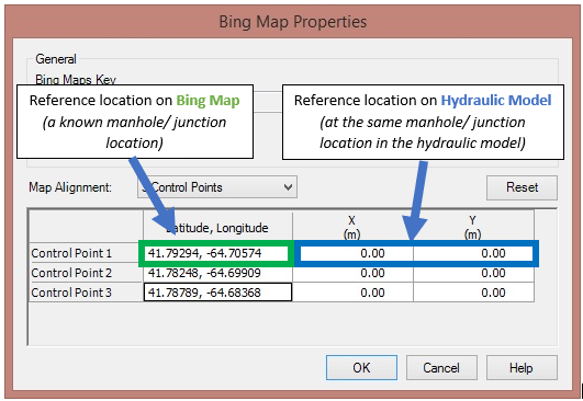

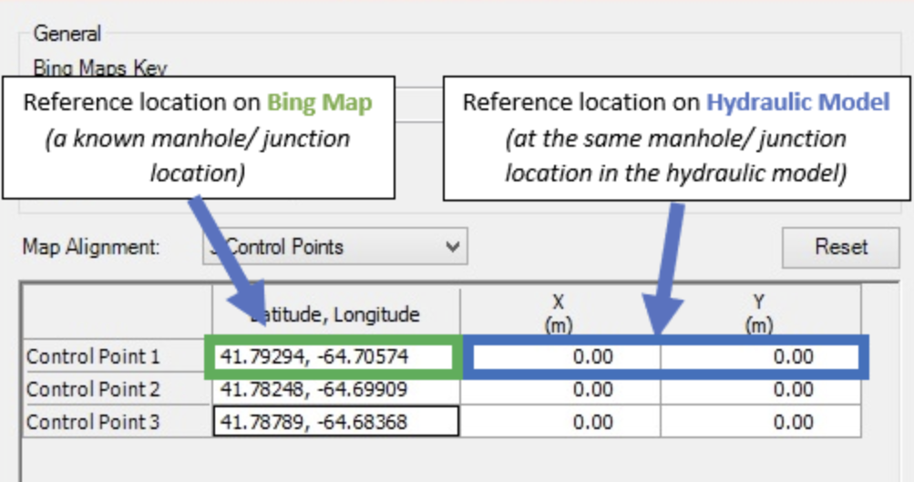

To manually align the map with the model:
  1. Select "3 control points" for the "Map alignment" dropdown in the Bing Maps Properties dialog.
  2. Click the first blank cell under the "X" column and click the ellipsis "..." button. This enables you to select a point in your model plan view for alignment.
  3. Click the point in the model to select the first point. For example this could be a particular node that is known to be at a particular road intersection that you know is visible in the aerial map. The model X and Y coordinates will be populated.
  4. Click the first blank cell under the "Latitude, Longitude" column and click the ellipsis "..." button. This enables you to select a point on the Bing Map that corresponds to the point you had selected from the model in step 3.
  5. Use zoom and pan to locate the corresponding spot on the Bing Map and click to select. The latitude and longitude will be populated and the model will be aligned with these pairs of points. Note that at this point the model will not move until the other two points are defined.
  6. Repeat steps 2-5 using the second and third rows in the table (Control Point 2 and Control Point 3) to define the three other points. It is recommended that you select three points along the outer boundaries of the site location for a triangulation.
  7. Click OK. The map will be rotated and stretched to align with the three points.

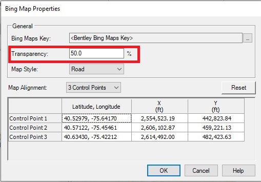

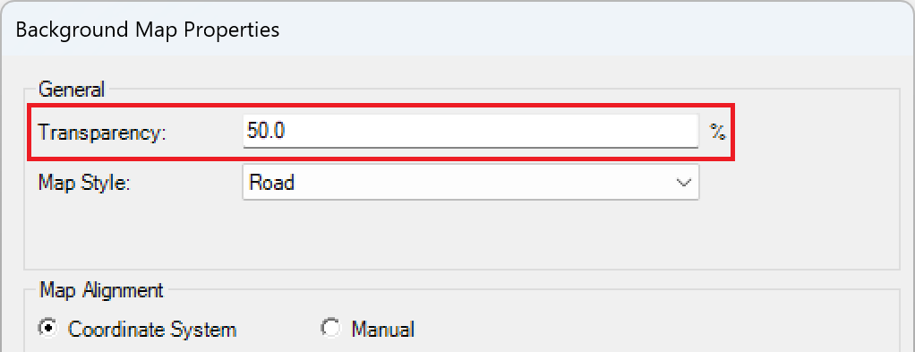

Setting Transparency
Starting in CONNECT Edition Update 3.4, it is possible set the transparency for the Bing Maps background.

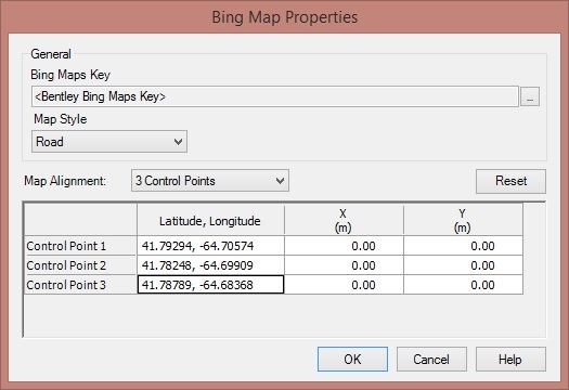

Bing Map shifts position: There is also another known issue (reference # 1025234) which can cause the Bing Map to shift positions when reopening the model, due to a problem with the one point vs. three point option in the Bing Map properties. This issue has been resolved in the CONNECT Edition Update 3.4. For earlier versions, edit the Bing Map properties (from the background layers manager), set the number of control points to 3, define three points to align the Bing Map with the model and click OK. Save, close and reopen the model to confirm that the map is still aligned. If this does not help, try going to File > Database Utilities > Synchronize Drawing / Update Database Cache.
If neither of these methods corrects your model placement on the Bing Map, and if you believe the drawing is drawn at the correct scale and the Y-axis is aligned with North, simply try using 1 Control Point to move the map to the correct location under the model.
Just right-click the previously attached Background Map - Bing line from the background layer dialog, select 1 Control Point from the pull-down, click in the Latitude, Longitude field and select the ellipses (…) button, and then click a point on the map of a known coordinate in your model. Then click in the X (ft) field and again select the ellipses (…) button and click the point in your model. that corresponds to the map point you selected.
This should re-align the map and your model.

Ability to change Transparency: This feature was introduced in CONNECT Edition Update 3.4.
Bing Map transparency not applying to Print Preview: The transparency used in the Bing Maps properties will not currently carry over into the Print Preview for a report. This will be reviewed for inclusion in a future release of WaterGEMS and WaterCAD. The reference number for this is 983435.

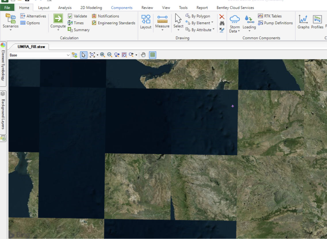

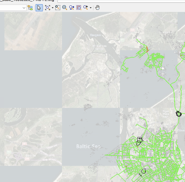

Bing Map tiles are jumbled / mixed up - this has been known to occur in certain network configurations such as when using a proxy server or caching service. A fix was made in a patch for version 24.00.01.12. Please upgrade to a newer version when available, or if you have 24.00.01.12 (check under File > Help > About), please contact Support for the patch.
Examples of this issue:
