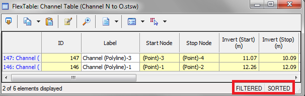

I don't see any elements listed in my FlexTables (the table is blank or empty), or there are only a limited number of elements showing in the FlexTable.
I can't see my flex table data - the data in the table is missing.
It's likely that your FlexTable is just filtered on a value that returns no results.
  1. Look in the lower right hand corner of the table to see if it says "SORTED", "FILTERED", or both.

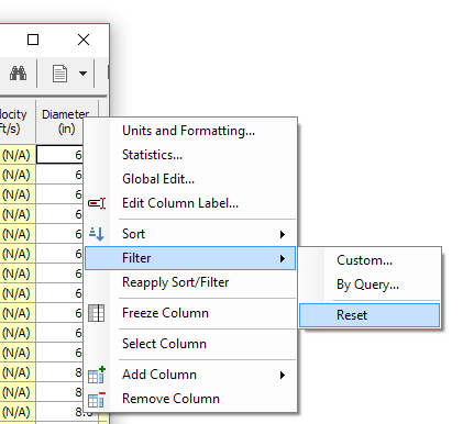

  2. Right click on any column header in the FlexTable and select Filter > Reset.
If this does not help, you may have experienced the problem described here: Flex table reports appear blank
