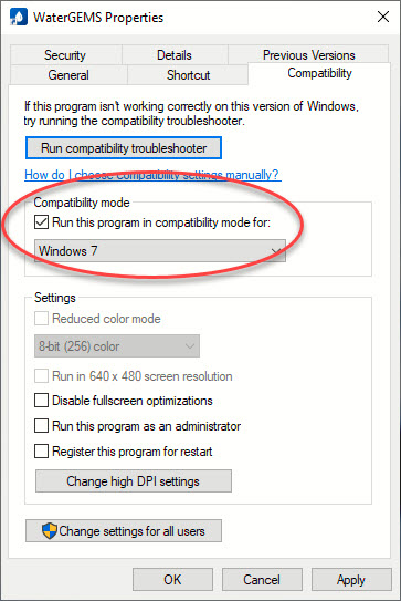

If the product installs but will not launch -
If the product will not launch, right-click on the program's executable file (C:\Program Files(x86)\Bentley\WaterGEMS\WaterGEMS.exe for WaterGEMS) and look at the Properties dialog.  There should be a "Compatibility" tab and in that tab, set Compatibility Mode to Windows 7 or Windows 8.
Then launch the program again and see if it will run in Windows 7 or Windows 8 Compatibility Mode.
