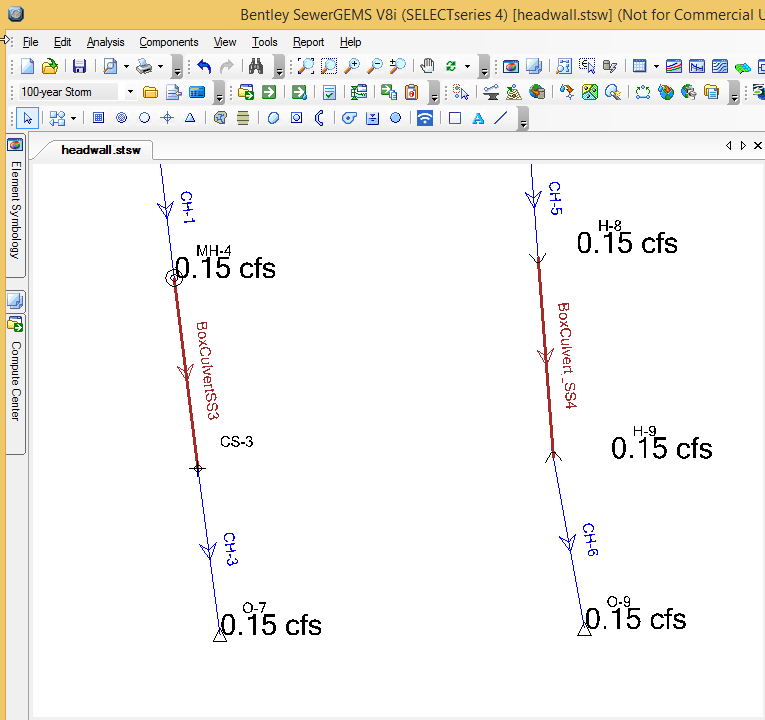

Layout and Configuration

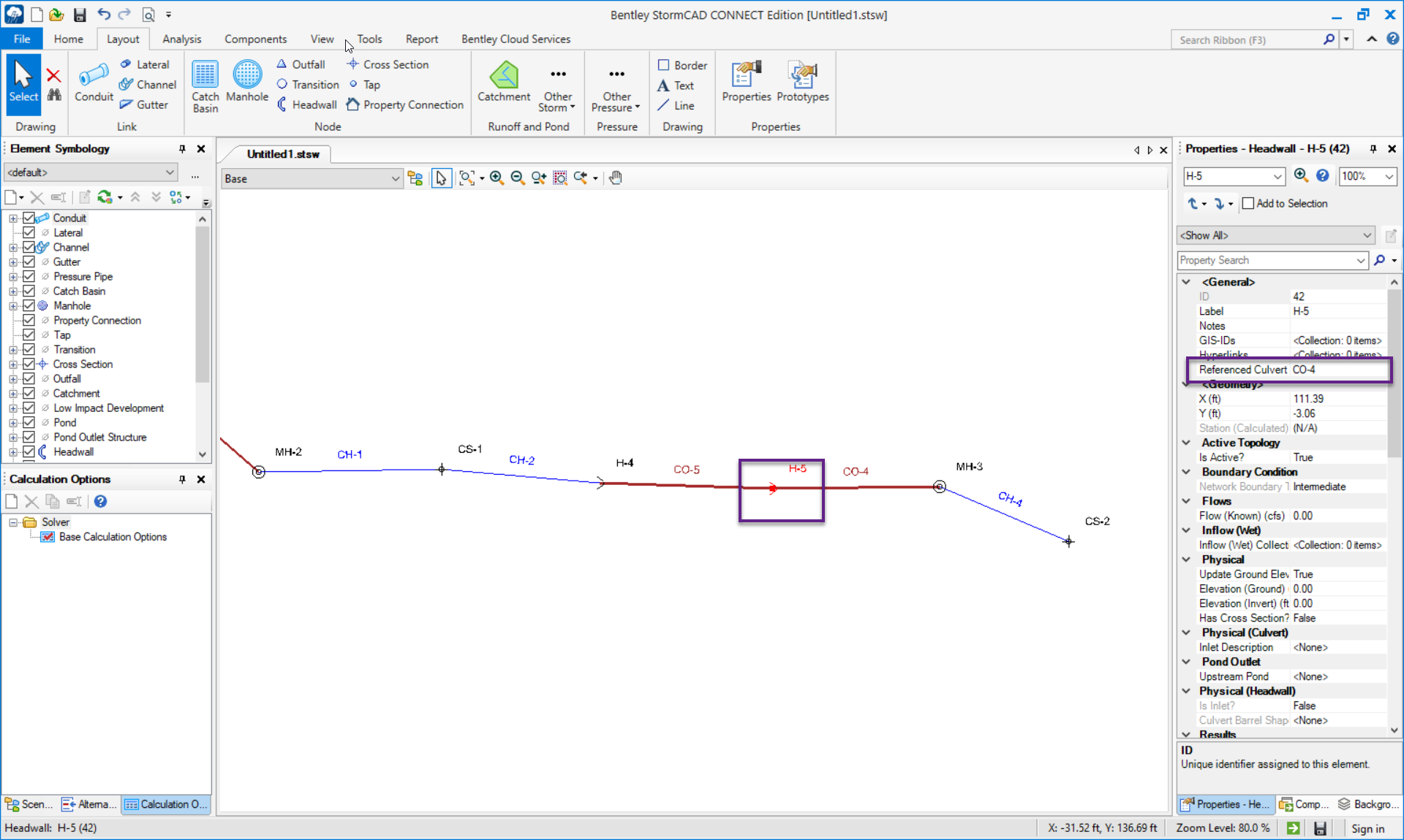

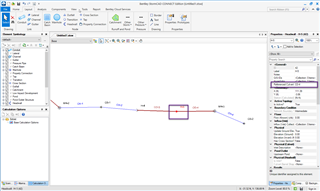

The Headwall element is available for modeling in the layout toolbar as shown below for V8i, or within the Layout toolbar for CONNECT Edition.
Headwall node within the Standalone Layout Toolbar

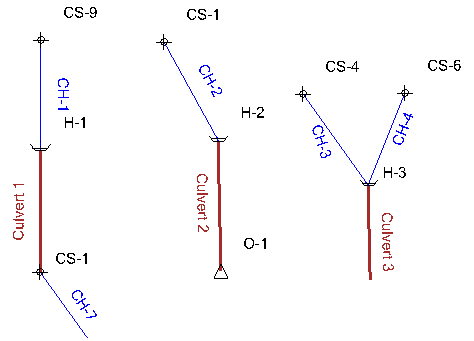

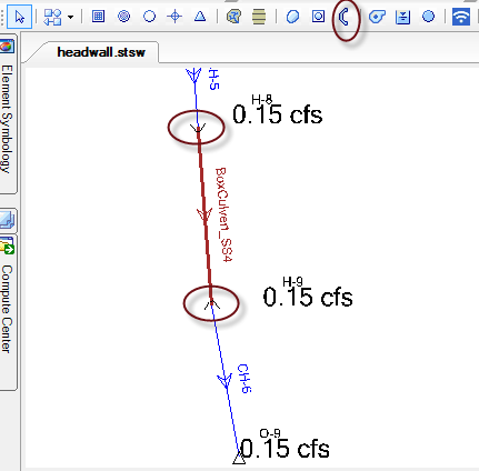

A headwall node that is the Start Node of a conduit will be laid out as a mirror image of a headwall node that is a stop node. A headwall can only be used with a conduit, and only with closed section shapes. It is not possible to connect two conduit links with a headwall node during layout. If you have a change of slope along your culvert barrel, see "broken back culverts" further below. The headwall element would only be used on the actual ends of the culvert where it meets the channel.

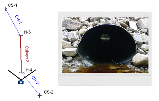

By hydraulic convention, culvert entrances usually have end-treatments that correspond to headwalls at the entrance and endwalls at the outlet. We will refer to all end treatments, regardless of upstream or downstream location or structural aspect as Headwalls. A reverse flow coefficient can be entered for the endwall, to model any additional head drop from the resistance through that endwall, and to account for the possibility of reverse flow (which could happen with the dynamic solvers when using a SewerGEMS/CivilStorm license).
If you only have a headwall on the upstream side, and the downstream side of the culvert barrel discharges into a channel without any endwall, you can model the connection between the culvert conduit and the channel, as a cross section node. See the left side of a screenshot further below for an example of this.

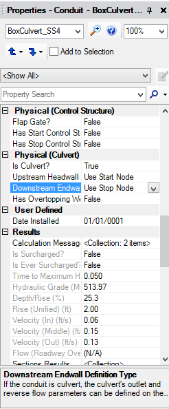

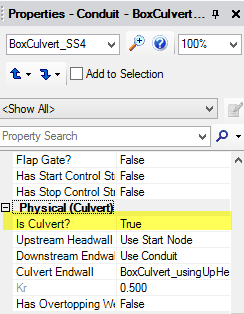

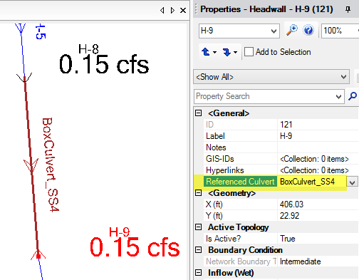

While setting up the headwall in the model you will need to define the referenced culvert in the properties of the headwall as seen below.
The conduit link element adjacent to a headwall should also be configured to represent a culvert, by selecting "True" for the "Is Culvert?" property. Select "Use Start Node" and/or "Use Stop Node" for the additional fields that appears when designating a conduit as a culvert, and the conduit will automatically use the inlet description (HDS-5 coefficients) that you already selected in the adjacent headwall, to model the headloss across the headwall.
Note: whether you have a headwall on one side or both sides of a conduit, that conduit needs to be set as a culvert in order for the head drop to be calculated across either headwall.
You may model projected or mitered end treatments on a culvert link with connection to a cross section or outfall node. Different possible combinations of headwalls can be seen below. If you attempt a configuration that is not permissible, you will get user notification for that.
(above) More Valid Configurations: Culvert with channel links.
(above ) Some Invalid Configurations, yet possible to layout. User notifications expected.

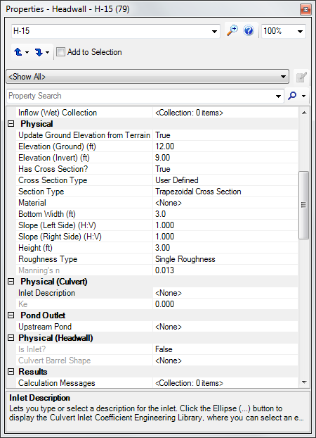

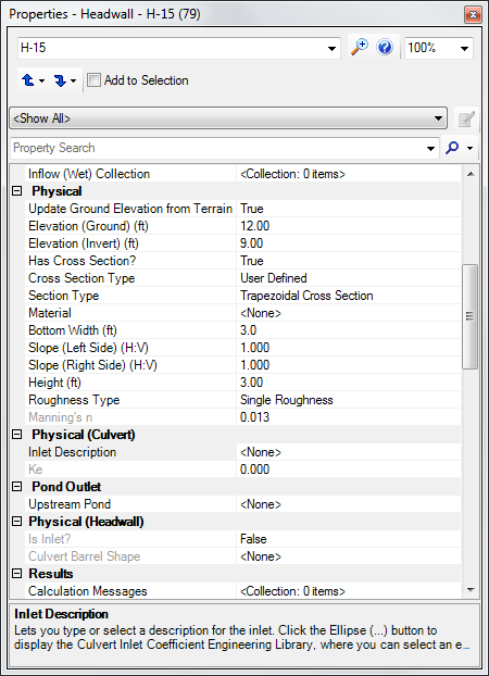

Headwall Property Grid: Basic Attributes
The following attributes of a headwall node are visible in the headwall property grid.

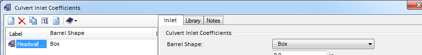

Culvert inlet Coefficients
For headwalls, the 'Culvert Inlet Coefficients' manager is accessible from the Components menu, appearing just after Conduit Catalog. This manager dialog is similar to Conduit Catalog manager, including sync capabilities to the Culvert Inlet Coefficients type of engineering library data. The headwall section properties can be set through the headwall property grid & as well as the conduit property grid.
The Culvert Inlet Coefficients manager dialog has two label columns: Label and Barrel Shape.
Mock-up of Culvert Inlet Coefficients dialog
All the attributes of culvert inlet coefficients engineering library data are mirrored and made available for editing in the right side of the dialog.
From a headwall property grid, you can reference from the culvert inlet coefficient manager by selecting […] from inlet description. This function is similar to selecting a conduit catalog reference. A non-editable preview of referenced support element data values is displayed in the corresponding fields in the headwall property grid.

The culvert barrel shape field reflects as a read-only value of the downstream conduit's shape if the headwall node is a start node. It reflects the value of the upstream conduit shape if it is a stop node.
The read-only 'Is Inlet?' attribute is 'True' if the headwall node is a start node. It will be set to 'False' if the headwall node is the connected downstream node of the culvert link.

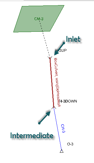

Inlet (headwall with no upstream elements)
A headwall node can be the most upstream node in a gravity sub-network, similar to other gravity network nodes. In this case, the 'Network Boundary Type' will automatically show as 'Inlet' when it detects that there is no upstream element.
Note that in this case, the 'Cross Section' related attributes are visible in the property grid, but they will not be used. You will receive a user notification "Cross section dimensions are ignored. Conduit attributes are used instead."
Intermediate (headwall between elements)
If the headwall connects between two link elements (for example a conduit discharging into a channel), the "Network Boundary Type" will automatically show "Intermediate" when it detects that the headwall connects between two link elements.

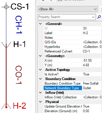

Outlet (headwall as terminating point of the network)
A headwall node can be the terminal point of a gravity sub-network, in place of an outfall element. In this case, the 'Network Boundary Type' will automatically show as 'Outlet' when it detects that there is no downstream element. You will also see the same options in the "boundary condition type" field that you would get for the outfall node element. For example you can choose the free outfall option, user defined tailwater, and others.
This is appropriate in cases where the downstream end of your system (the point after which you do not want to model, and the flow leaves the system) is an endwall structure. The outfall node element can be used to terminate the downstream end of the network as well, but the headwall element enables you to visualize the system more accurately since you can see the endpoint as the endwall symbol and be able to list it along with other actual headwall/endwall elements (for example in the flextables).
Note that in this case, the 'Cross Section' related attributes are visible in the property grid but they will not be used. You will receive a user notification "Cross section dimensions are ignored. Conduit attributes are used instead."

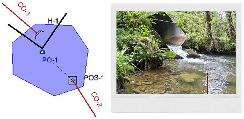

Pond Outlet (Headwall as a Pond Outlet Structure)
The headwall element can be used as the outlet of a pond, instead of using the pond outlet node element with the culvert modeled in the composite outlet structure. In this case, the 'Network Boundary Type' will automatically show as 'Pond Outlet' when it detects that there is an upstream pond. The pond outflow will then be based on the hydraulics of the headwall element.
A dashed line connected to pond will be drawn, with the same behavior as a pond outlet structure node.
Valid configuration: Headwall instead of a Pond Outlet Structure.
Discharge To Pond (Headwall that empties into a Pond)
If the headwall node discharges into a pond, you can select the 'Boundary Element' option for the "Boundary Condition Type", then select the pond as the "boundary element" (similar to using the outfall element) In this case, the 'Network Boundary Type' will automatically show as 'Discharge to Pond' when it detects that there is a downstream pond.
Property grid state for Headwall when selecting a Pond as a Boundary Element.
Valid configuration: Headwall empties to a Pond.

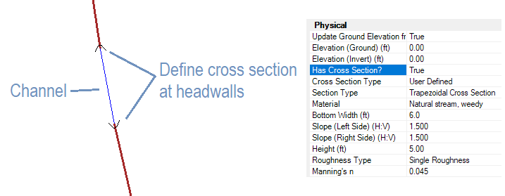

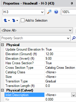

Headwall on both sides of a channel
By setting the headwall property field "Has Cross Section?" to True, you can place a channel between two headwalls. The channel link element needs to define its cross sectional area at the end nodes (normally done with the cross section node element) so this option in the headwall properties facilitates that. When you set this to True, you will be able to enter the start and/or stop properties for an irregular or trapezoidal channel.

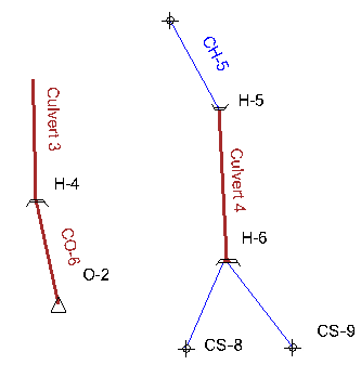

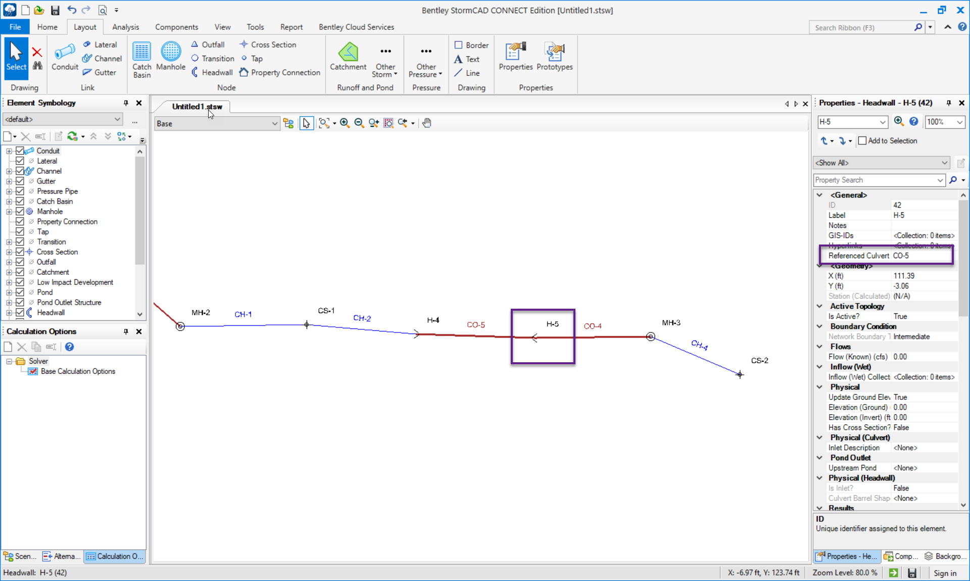

The orientation of the headwall depends on the referenced culvert in the headwall properties. As shown in the below screenshot headwall can be referenced to different conduits when they are adjoining, based on that it will change its orientation/direction
Referenced culvert - CO-5
Referenced culvert - CO-4

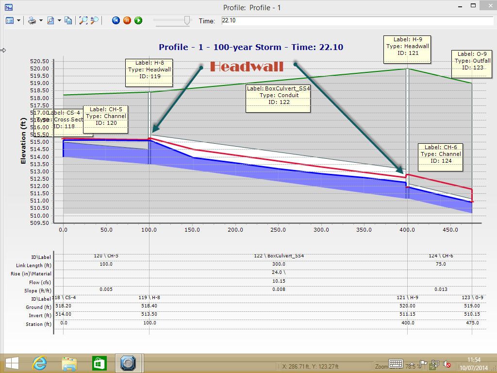

Profile View
The headwall element can be seen in the profile view as below, wherein the drop in the HGL is seen in the conduit. Note that a small, non-zero width is used to display the headwall in profile view, and this width cannot currently be changed. (reference # 64687)
Note: Starting with version 24.00.03.23 of OpenFlows Storm and OpenFlows Sewer, the profile will display using input for roadway dimensions based on input for Elevation (Roadway Crest). Roadway Distance from Start, and Roadway Cross Section Length

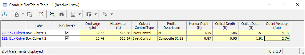

HY-8 style HDS-5 Culvert Reports
To create a culvert report similar to HY-8, create a new project-level conduit flextable and add the respective fields, renaming the column headers if needed. Below are the HY-8 results with their equivalent results field in the OpenFlows product. More information on customizing Flextables can be found here. A more direct way to produce an HY-8 report will be considered by our Development team for a future release (reference # 668413)
Note: see also: How to match culvert results with HY-8
- Culvert discharge: see "Flow"
- Total discharge: This would be the same as "culvert discharge". If this is only different in cases where roadway overtopping flow occurs, roadway overtopping flow would be seen in the "Flow (roadwater overtopping)" result, culvert flow would be seen in the "Flow (middle)" result, and the total flow combining both the culvert and roadway flow would be seen in the "Flow" Result. Note: Results for roadway overtopping are available for all solvers start with version 24.00.03.23 of OpenFlows Storm and OpenFlows Sewer. Prior to that version, roadway overtopping results were only available with the Implicit and Explicit solvers.
- Headwater elevation: see "Upstream structure hydraulic grade line"
- Inlet control / Outlet control depth: although the comparison is performed, only the controlling depth is used. To see the headwater depth you would either need to look at the "Depth (in)" for the upstream headwall element, or create a conduit formula-derived User Data Extension that subtracts the conduit start invert from the "Upstream structure hydraulic grade line" result field. See this.
- Flow Type: see "Profile Description". More information here.
- Normal depth and critical depth: see "Depth (Normal)" and "Depth (Critical)"
- Outlet depth and tailwater depth: see "Depth (out)". In StormCAD, CivilStorm and SewerGEMS in most cases these would be equal since the network is solved as a whole. If there are significant losses across the downstream node, see "Depth (in)" in the downstream node.
- Outlet Velocity: see "Velocity (out)"
- Tailwater velocity: If this is different than the velocity on the downstream side of the culvert, you would look at the "Velocity (In)" for the next-downstream conduit or channel.
