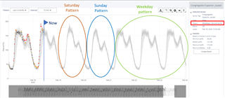

Yes, WaterSight uses AI algorithms and advanced data analytics as a support to calculate the expected behaviors (patterns) for sensors and zones, as well as to calculate forecasts, including demand forecasts up to one week. Some examples where these patterns and forecasts are used:
Patterns and forecasts calculation
Alerts generated based on deviations to patterns

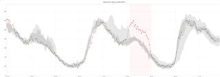

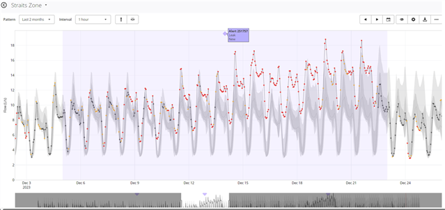

WaterSight can alert in advance when real values goes outside the expected trends and before a minor leak becomes a larger burst. Volume lost in each event is automatically calculated, and user can manage the event (update status, category, made comments, etc) - see below an example.
Alerts can be configured by the user in the Alerts administration page. The user can define four different types: Pattern based, Absolute based, No Data and Flat Reading.
Absolute based alarms are evaluated directly by comparing real time series values with the user defined threshold and are more useful to identify situations that do not depend on the sensor or zone pattern, like for example problems related with pressure service requirements - pressure below the minimum or maximum required by regulation - or tank overflows (more information here).
On the other hand, Pattern based alarms are evaluated using the pattern as a reference. Pattern based alarms are useful to trigger and detect anomaly or extraordinary events that don't occur often, and therefore do not make part of the normal behavior/pattern of the zone or sensor. Some examples are events like bursts and leaks, fire events, or a flow meter or PRV malfunctioning (more information here).

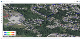

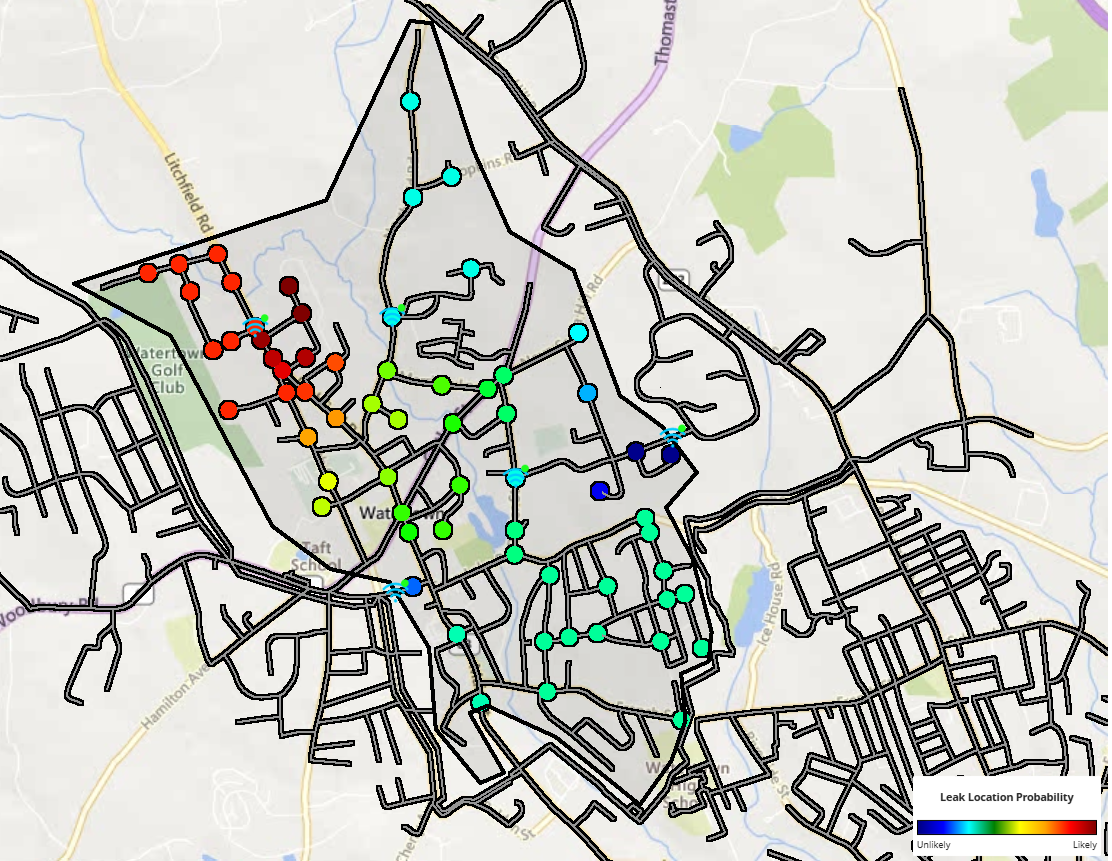

Yes. Timely notification of potential burst and leak events, along with the ability to promptly locate and address them, is a fundamental component in minimizing real water losses. WaterSight can monitor in near real time each zone flow and pressures and automatically alert for any potential leak or burst in the system. Once an event is generated or manually created by the user, the platform can effectively narrow down the search area by pint-pointing in a map the most likely hotspots (at red), as shown in figure below.
Figure 1 - Map with the most likely (at red) and unlikely (blue) spots of potential leakage.
For the leakage geolocation to work it is required to have at least real time zone flow data and a good hydraulic model. More information can be found here - Geolocation of leaks.

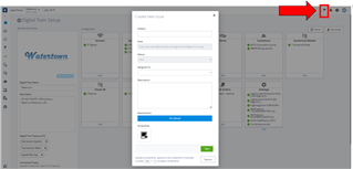

Yes. You can create an issue (this is the name given in the solution) based on any observed data, directly from any page in WaterSight, by clicking the issue flag button located on the right side of the header.
Issues are a particularly important communication tool between operators and managers to identify and track potential anomalies observed from any page within WaterSight. Some examples can include:
More information can be found here.

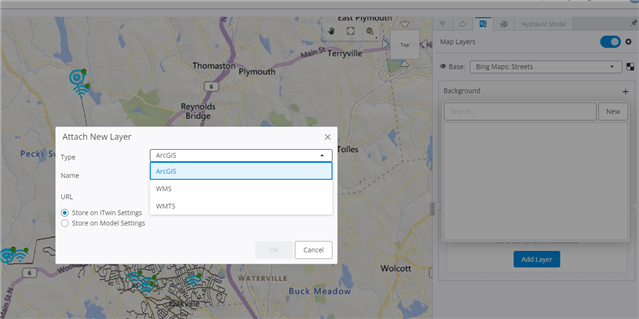

Yes. WaterSight supports ArcGIS map service connection, including connection to ArcGIS online and ArcGIS Enterprise (on premise). If there is a need for you to connect with a Esri Feature Service, please reach to your Bentley point of contact for more information.
Besides this it is also possible to connect with other map layers such as WMS and WMTS and upload any other GIS data, through a shapefile upload in the GIS administration page.
For more information please take a look at this article - WaterSight - Maps (Map Layers/GIS).

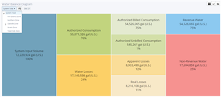

Yes, WaterSight can automatically calculate water balance for each zone based on sensors data (from SCADA for example) and billings (uploaded via administration):
For more detail about the calculations, please click here.
