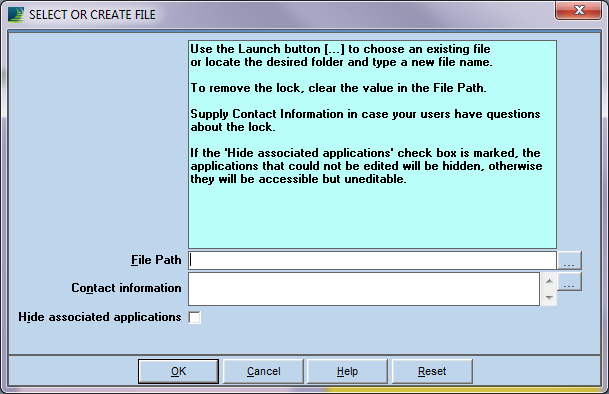

Select File -> Secure Library. The SELECT OR CREATE FILE dialog box appears.
This populates the File Path field with the path and name you specified.
The Contact Information field is for optional name and contact information that will appear when a user attempts to access the locked library. This is so that the user will know who to contact if he or she needs changes made to the library. We will leave this blank.
Check the Hide Associated Applications checkbox. This hides the application and application group tabs for unauthorized applications in a locked library, including REPORT DESIGN, SYMBOL DESIGN, Lib Merge/Copy, and all DATA DESIGN applications other than Project Database and Correspondence Files.

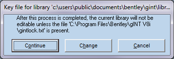

Click OK. You see the following warning:
Click Continue. The library is now locked. You can continue to make modifications to the library because it references gintlock.txt, and that file is present in the specified location on your computer.

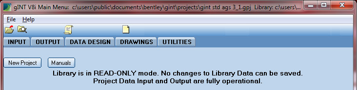

If the library were to be distributed to another user, or if you deleted gintlock.txt from your computer, the next time this library was opened, the following would appear:

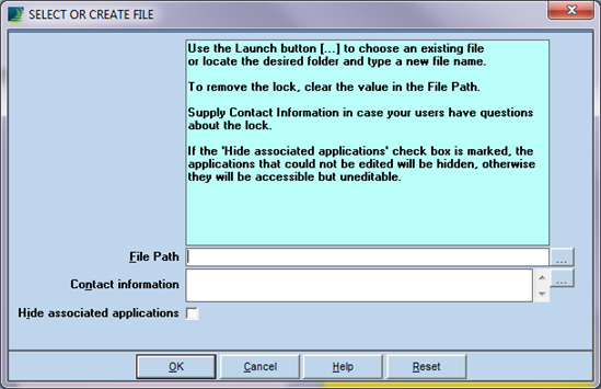

While still in UTILITIES -> Lib Merge/Copy, select File -> Secure Library. Delete the contents of the File Path field, and then click OK. This unlocks the library. It can be edited by all users to whom it is distributed.
