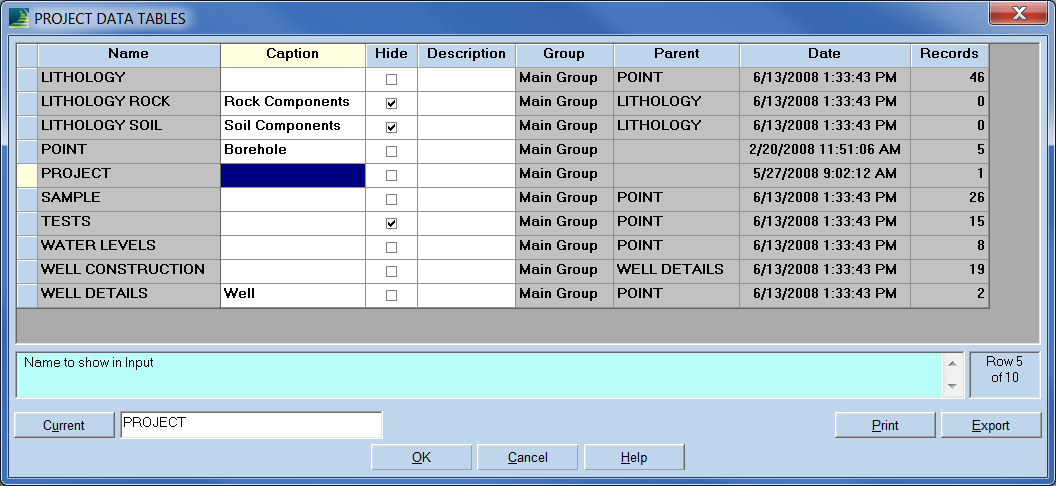

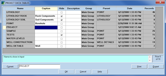

How can we hide or show Input table tabs?
Often it is better to hide a table than to delete it.
  1. Go to INPUT. Notice the set of table tabs.
  2. Select Tables -> List or click the List   icon. The PROJECT DATA TABLES window appears.
  3. Add and remove some checkmarks in the Hide column. Click OK.
  4. Notice your changes reflected in the tab bar.

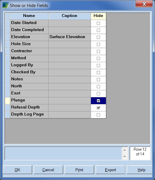

How can we hide or show a field?
Often it is better to hide a field rather than delete it.
  1. Go to INPUT.  Select the tab with the field you wish to hide.
  2. Select Tables -> Show or Hide Fields. The SHOW OR HIDE FIELDS window appears.
  3. Add and/or remove some checkmarks in the Hide column. Click OK. Notice your changes reflected in the grid.

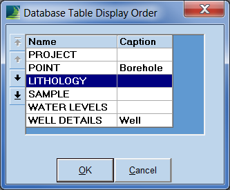

How do we change the order of the table tabs in Input?
This command allows you to rearrange the display order of the table tabs in INPUT.
Do the following:
  1. Select Tables -> Input Sequence. The Database Table Display Order window appears.
  2. Highlight one of the tables, then click the Up Arrow   or Down Arrow   to change its position.
  3. Click OK. Notice the change in the order of table tabs.
