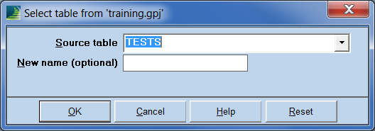

  3. Select Tables -> Import Table. The CHOOSE A DATABASE file browser window appears.
  4. Browse to training.gpj click Open. The Select table from dialog box appears:
  5. In the Source table field, select ‘TESTS’.
  6. Click OK. Notice that ‘TESTS’ now appears in the object selector, and the Fields list shows the full set of fields obtained from the TESTS table in training.gpj.

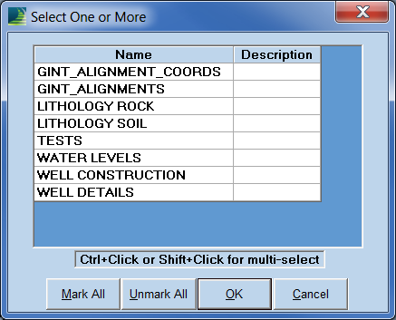

  5. The Select One or More dialog box appears.
  6. Notice that all tables in the source database that are not already present in the target are listed.
  7. Click Mark All, then click OK.

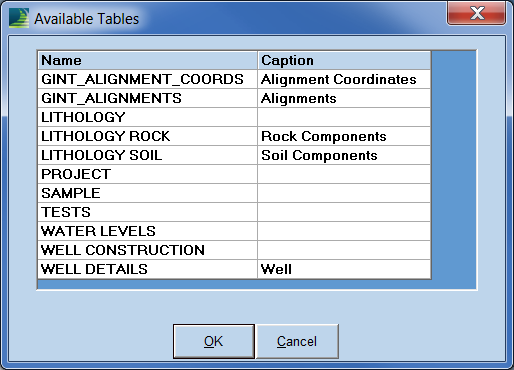

  6. Select Tables -> Merge Fields from Current File. The Available Tables dialog box appears.

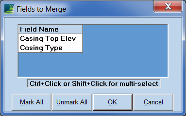

  7. Highlight ‘WELL DETAILS’ and click OK. The Fields to Merge dialog box appears.
  8. Click the Mark All button, then OK. A warning message appears to tell you that only the field structures are copied, not the data. Click OK to dismiss the message.
  9. Notice that Casing Top Elev and Casing Type are now present in the POINT table. Normally we would now copy the data into these fields in POINT, then delete the WELL DETAILS table. However, this was just for demonstration purposes, so we will delete the new fields from POINT instead.

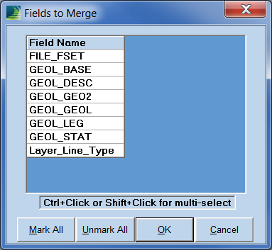

  6. Select ‘GEOL’ and click OK. A field selection list appears, listing the fields in the GEOL table.
  7. Select Mark All, then OK. Click OK to dismiss the warning message that tells you that only structures, not data, are imported.
  8. Notice that the fields list from the external GEOL table is now present in the new GEOL table in the project.
