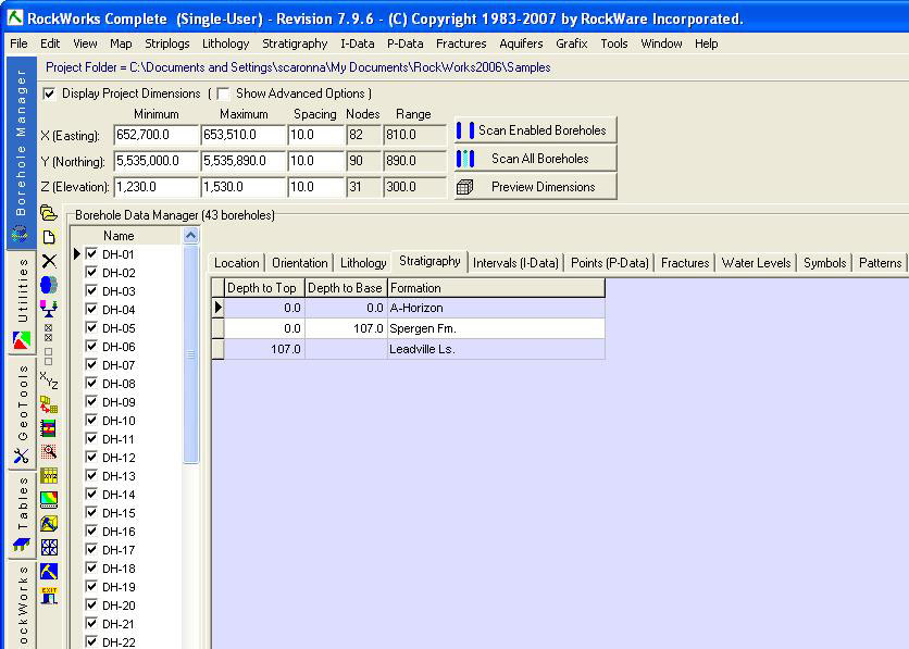

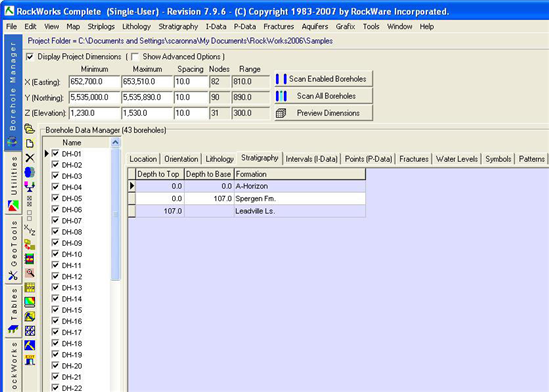

Consult the Rockworks documentation for instructions on how to import and manipulate the data. We will only briefly describe some of the capabilities. (For more information about Rockworks, please visit RockWare’s Web site at www.rockware.com.) After import, the data looks as follows in the RockWorks Borehole Manager:
Notice the tabs for various data tables corresponding to the structure we created in the export file.

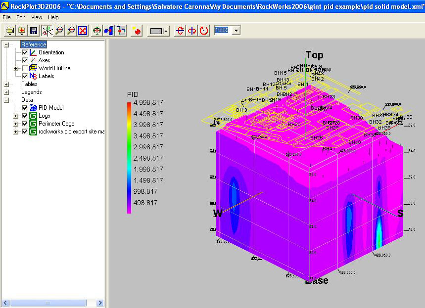

The following screen capture shows a model of chemical concentrations from PID data. Increasing concentration is represented with colors further from the purple and closer to the red end of the spectrum. Notice the site map and borehole numbers overlaid at the top.

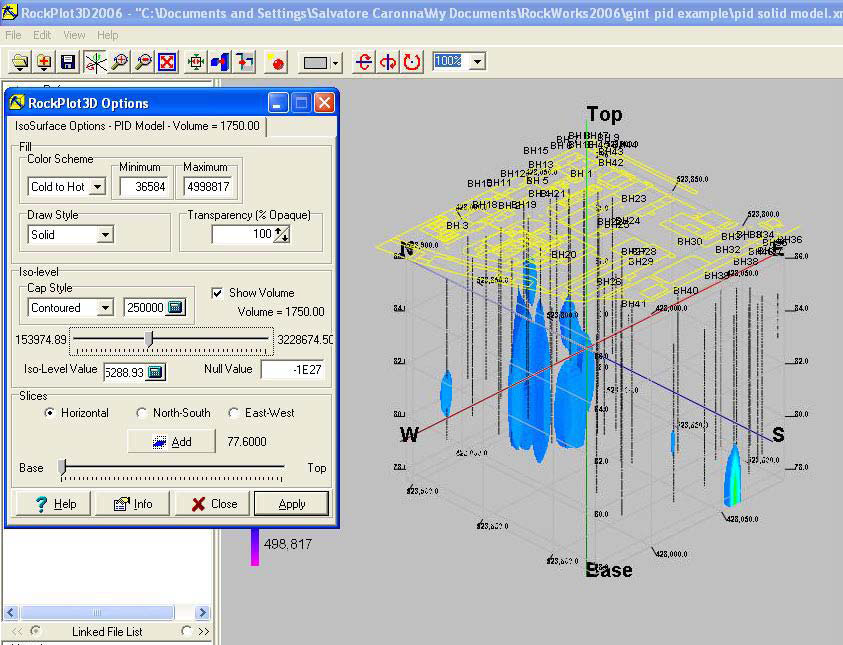

By modeling specific PID ranges only, a clearer view of the high concentration areas is revealed:
