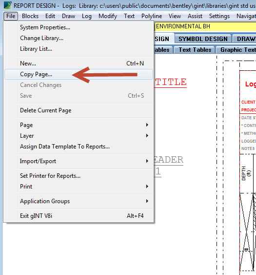

- Go to the Report Design tab.
- From the yellow Template selector, select the desired Report template of which you want to make a copy of.
- Go to File Menu. Select Copy Page.

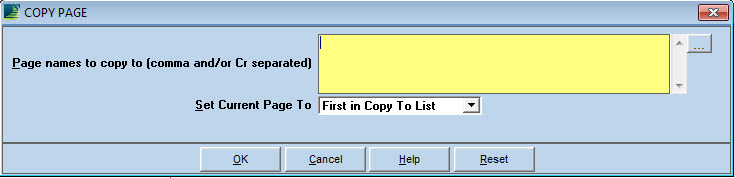

- A Copy page property dialogue box opens up.
- In the yellow box, type in the desired name of the copy page report template what it would be named as. The ‘Set Current Page To’ filed must be set to ‘First in Copy to List’. Click OK.
- You will see the new copy page name in the yellow report selector. The original report template would also be listed in the drop down menu.
