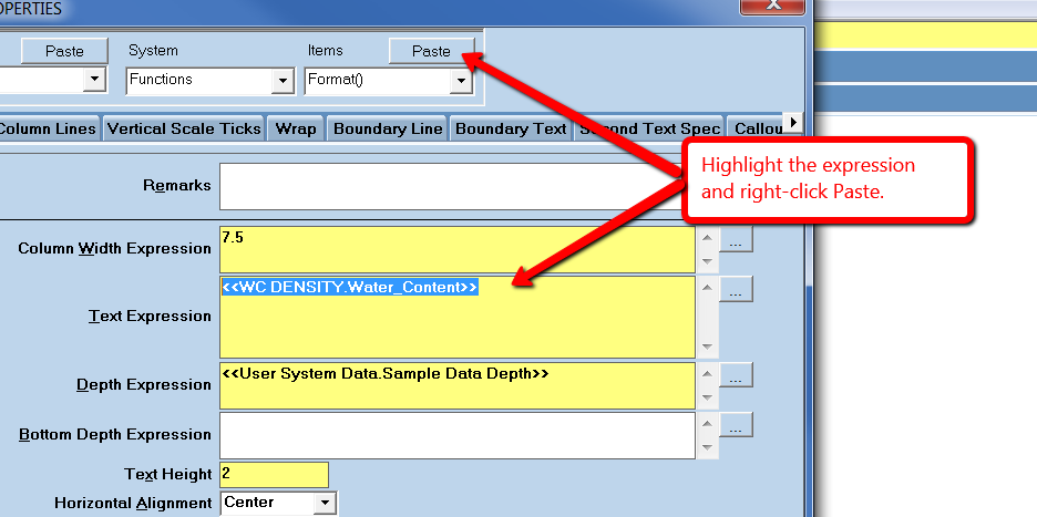

  1. Move to the Report Design tab.  Select the Logs tab.  Select the appropriate log template from the big yellow drop-down.
  2. Double-click on the Water Content column entity to open it for editing.  This Text Expression displays the water content data just as it is entered:
    <<WC DENSITY.Water_Content>>
  3. To format the water content, from the System area of the Data Tool, select Functions.  From the Items area, select Format.
  4. Highlight the Text Expression and right-click the Paste button on the right:
    This will wrap the Format function around the text expression:
    <<Format(<<WC DENSITY.Water_Content>>)>>
  5. Click to place the cursor just before the close paren.  Add
    ,0.0
    The expression now reads
    Format(<<WC DENSITY.Water_Content>>,0.0)>>
  6. Click OK and OK to close the column entity.

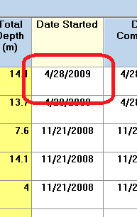

To Format a Date
In this example, we will format the Date Started field with 2 digits for month, day and year, and with slashes.  The date circled below appears as 04/28/2009 INPUT.  We want it to print on the log report as 04/28/09.

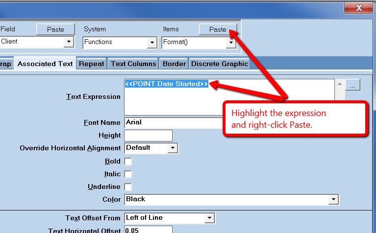

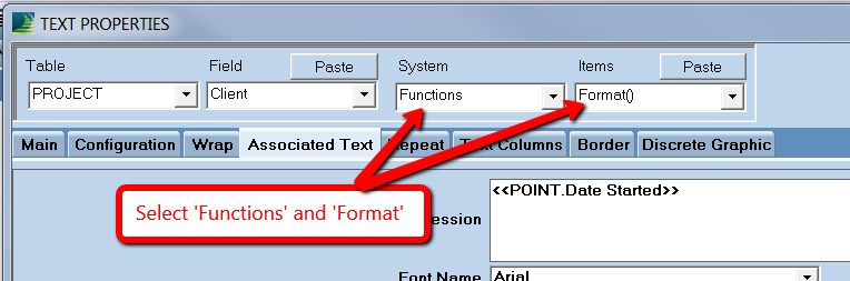

  3. To format the date, from the System area of the Data Tool select Functions.  From the Items area, select Format.
    <<Format(<<POINT.Date Started>>)>>
    ,MM/DD/YY
    Format(<<POINT.Date Started>>,MM/DD/YY)>>
  6. Click OK and OK to close the text entity.

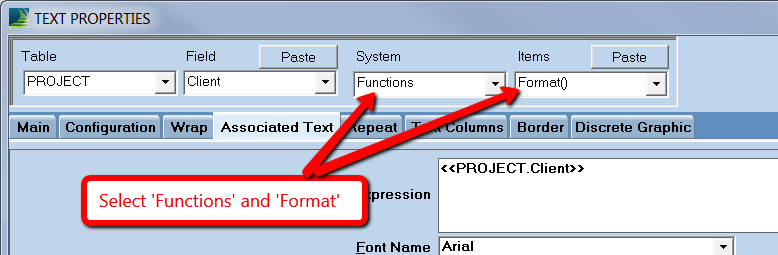

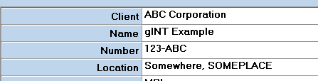

To Format Text
In this example, we will format the client name to appear upper case.
  2. Double-click on the client name text entity to open it for editing.  This Text Expression displays the client name just as it is entered:
    <<PROJECT.Client>>
    Note: If you see only the label for the client name move to the Associated Text tab.  The expression you want is probably in the Text Expression box here.

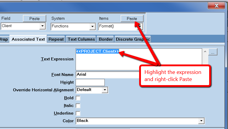

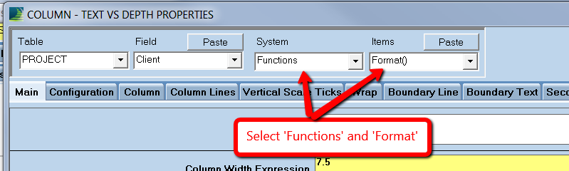

  3. To format this text, from the System area of the Data Tool select Functions.  From the Items area, select Format.
    <<Format(<<PROJECT.Client>>)>>
    Format(<<PROJECT.Client>>,>)>>
