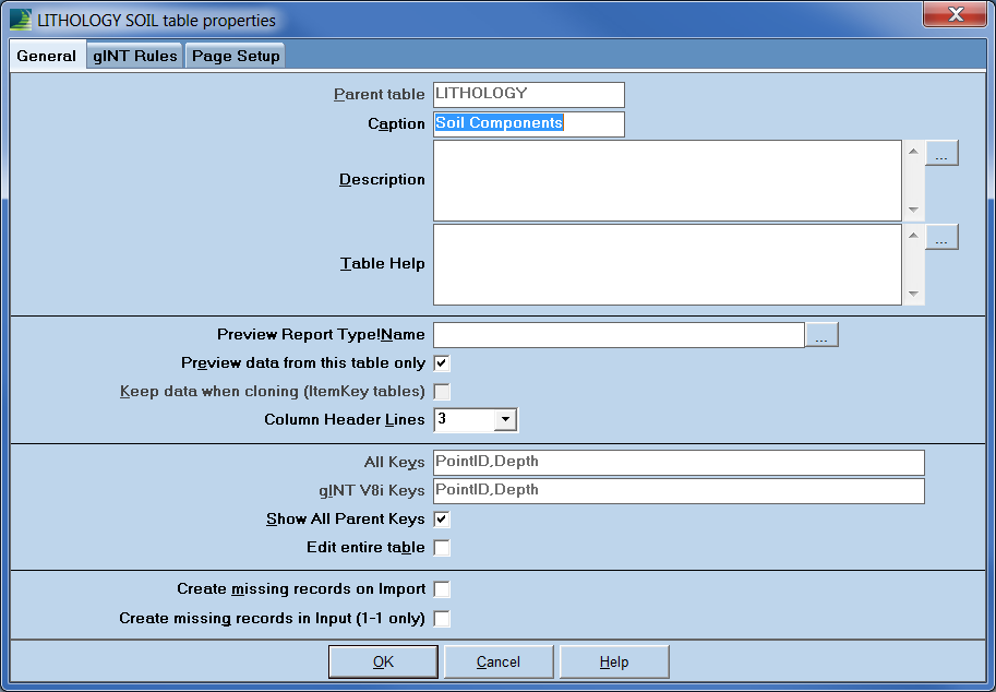

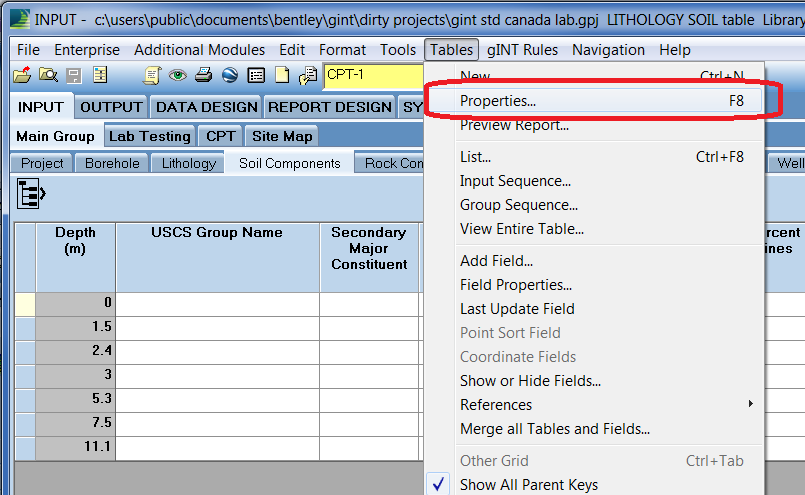

Add a caption to a table/tab in Input
  1. Open the project in Input.
  2. Go to the table/tab you wish to modify.
  3. Go to Tables Properties
    The properties dialog opens.
  4. Enter a caption and click OK.
  5. If you clone new projects from a data template remember to update your data template.

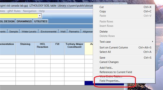

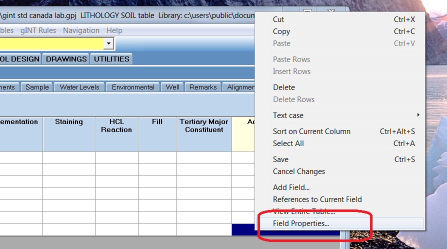

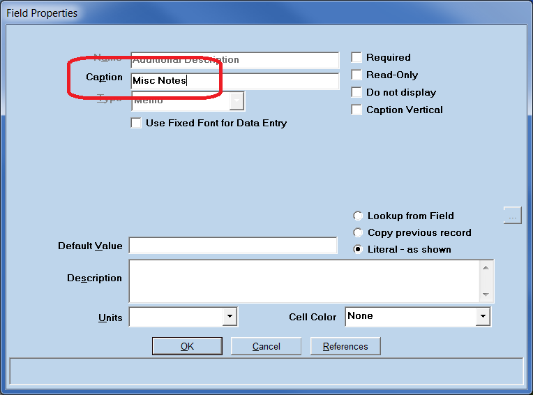

Add a caption to a field in Input
  3. Right-click in the field and select Field Properties.

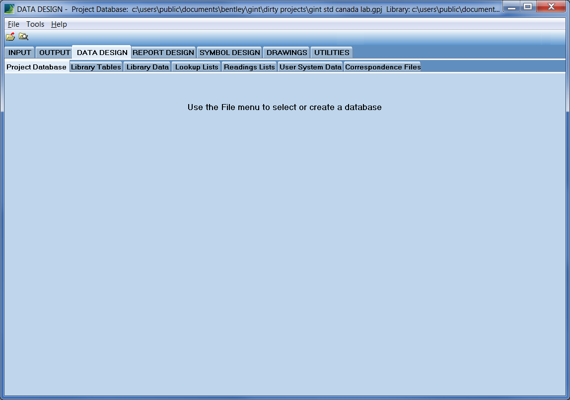

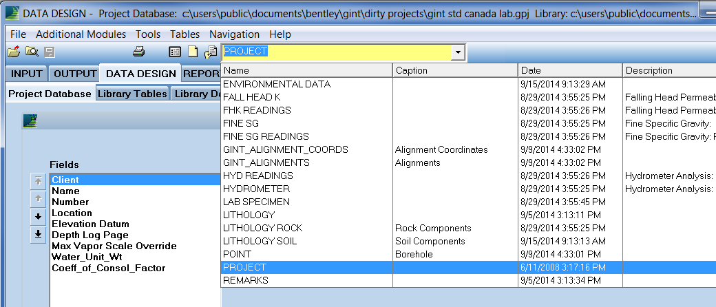

Change the name or add a caption to a table/tab in Data Design Project Database
  1. Go to Data Design Project Database.
  2. Go to File Open Project.  Select a project to modify.
    The field list for the Project tab/table opens.
  3. From the big yellow drop-down list, select the table/tab you wish to modify.

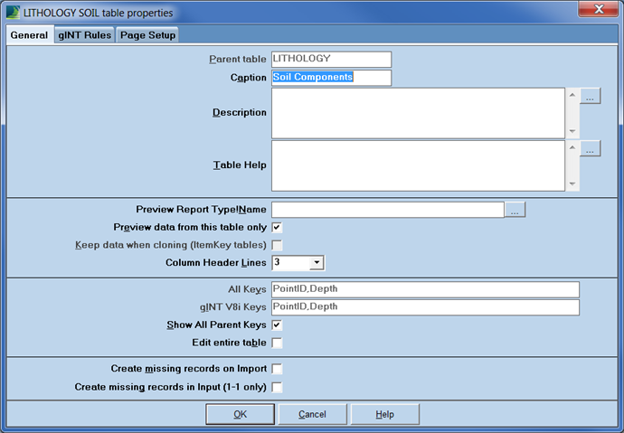

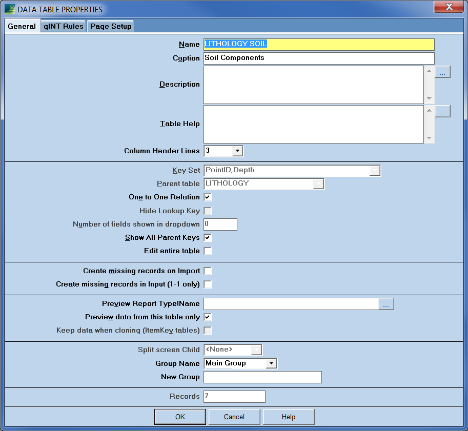

  4. Go to Tables Properties
  5. Modify the table name and/or enter a caption and click OK.

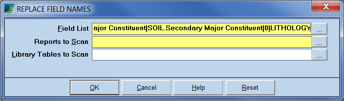

  6. If you change the table name you will see the Replace Field Names dialog.
  7. After selecting which reports and library tables to scan, gINT will look for all instances of the old table name and replace it with the new name.
  8. If you clone new projects from a data template remember to update your data template.

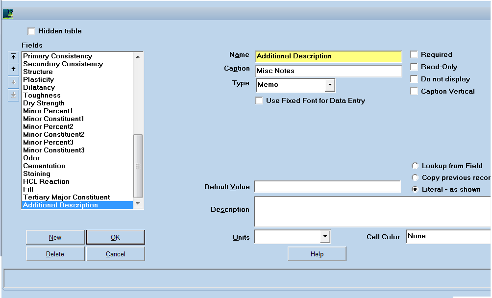

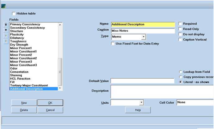

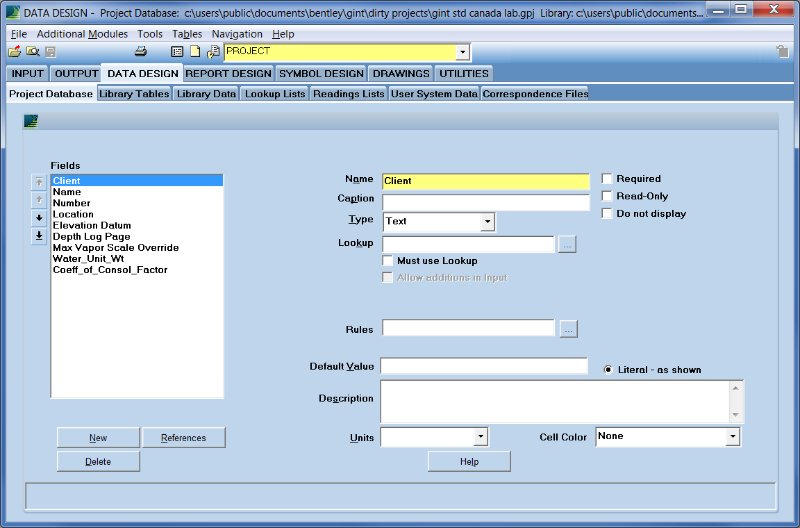

Change a field name or add a caption to a field in Data Design Project Database
  4. Select the field to modify and enter a caption.
