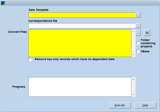

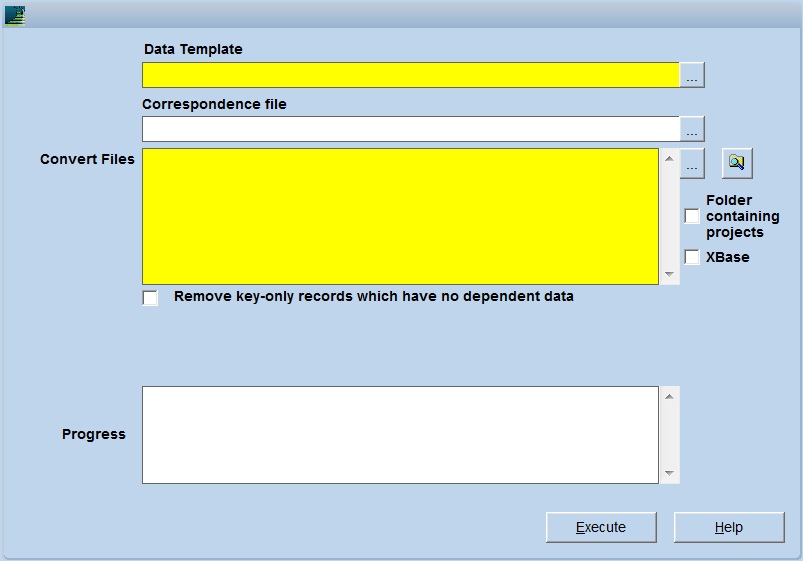

  3. Go to UTILITIES -> Convert Projects.
  4. Click the Browse   button to the right of Data Template.
  5. Click the file type selector in the lower right (above Open).  Notice you can select either a data template or a project.
    Select data entry.gdt click Open.
  6. Click the Browse button to the right of the input databases (large yellow) list box. Select surfaces.gpj and click Open. (Note that multiple input databases could be selected at this time).

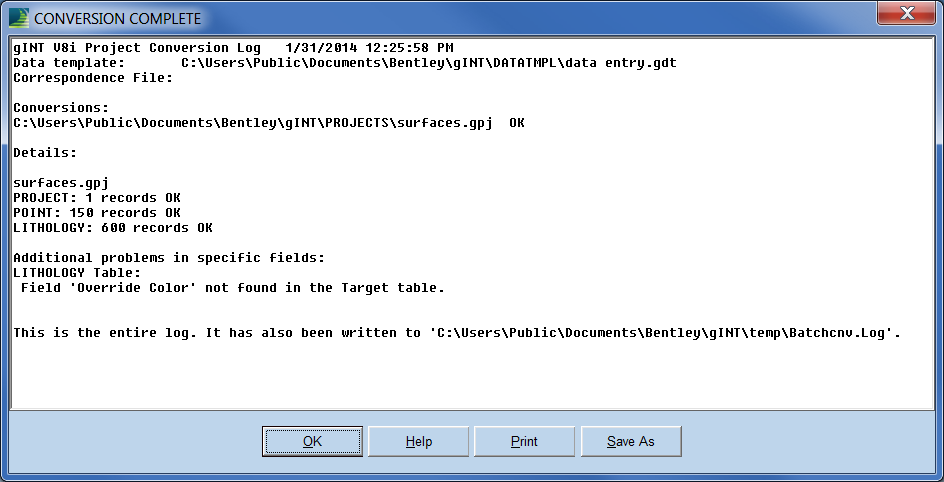

  7. Click Execute. The conversion is processed, and a status log window opens.
    Notice the message "LITHOLOGY Table: Field 'Override Color' not found in the Target table."  Because that field was not in our data template, it has been removed from surfaces.gpj during conversion and the data is lost.
  8. Click OK to close the status log window. Go to INPUT.
  9. Click on each of the table tabs in turn. Note that empty new fields have been added to the PROJECT, POINT, and LITHOLOGY tables without disrupting the existing fields, and empty SAMPLE, WATER LEVELS, and WELL DETAILS/WELL CONSTRUCTION tables.
