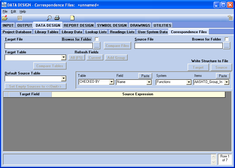

  5. Go to DATA DESIGN->Correspondence Files.
  6. Important: Select File->New File. This starts a new correspondence (GCX or GCI) file.
  7. Important: Select File->Save As, and specify a file name of test import.gci in \gINT\datatmpt\. Click Save.
  8. In Source File, click the Browse   button, specify ‘Excel 2003’ for Files of Type, and select corresp file test data.xls in \gINT\projects\, then click Open. This is the spreadsheet to be used as a model for Excel files to be imported.
  9. In Target File, click the Browse   button and select simple project.gpj in \gINT\projects\, then click Open. This is the project database we will import into, with the aid of the correspondence file.
  10. Click the drop-down arrow on the Target Table drop-down list. Notice that the table names in simple project.gpj are listed. Select ‘POINT’ in the list. Notice that a list of fields from the POINT table appears in the Target Field column of the mapping table.
    Each Target Field is what is being mapped to (in the destination project). You need to provide a Source Expression to specify what you are mapping from (for those fields that are mapped from the source spreadsheet).
  11. Select a Default Source Table of POINT. This is the name of the table (actually the sheet) in the source spreadsheet that maps to the POINT table in simple project.gpj.

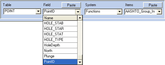

  12. In the Data Tool (shown below), set the Table drop-down selection to POINT and click the drop-down for Field to see which fields are available in the POINT sheet in the spreadsheet.
  13. Click in the Source Expression to the right of ‘PointID’. In the Data Tool, select a Table of ‘POINT’ and a Field of ‘PointID’, then click Paste. Press Tab to exit the Expression popup. ‘<<POINT.PointID>>’ appears in the Source Expression.

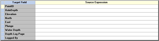

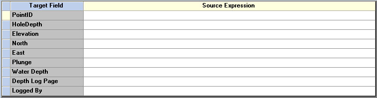

  14. Enter the following values in the mapping table for POINT, using the Data Tool:
    Target Field
    Source Expression
    PointID
    <<POINT.PointID>>
    HoleDepth
    <<POINT.HoleDepth>>
    Elevation
    <<POINT.Elevation>>
    Logged By
    <<POINT.HOLE_LOG>>
    North
    <<POINT.North>>
    East
    <<POINT.East>>
    Plunge
    <<POINT.Plunge>>
  15. Click Save   to save the mappings to the correspondence file.

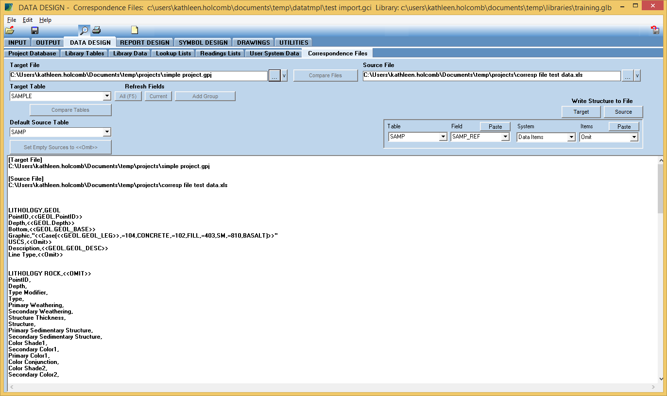

  21. Select File->View As Text to view the contents of the test import.gci (alternately you could open it with Notepad or another text editor in \gINT\datatmpl\). Notice how this correspondence file captures the conversion settings you specified.
  22. Select File->View As Text again to uncheck this option, and restore the standard correspondence file builder view.

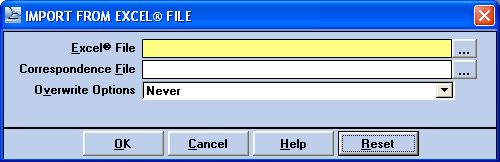

To test the import feature using the new correspondence file, do the following:
  1. Go to INPUT->Borehole.
  2. Select File->Import/Export->Import from Excel File.
  3. Click the Browse   button for Excel File, and select corresp file test data.xls in \gINT\projects\.
  4. Click the Browse   button for Correspondence File, and select test import.gci in \gINT\datatmpl.
  5. Leave Overwrite Options set to ‘Never’, and click OK.
  6. Look at the results in the status log, then click OK to dismiss it.
  7. Select ‘Test1’ in the Borehole tab, then view the records for this point in the Sample and Lithology tabs.
